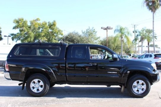

    I'm going down to Tampa, FL to buy a 2012 Access Cab 4 Cyl on Saturday. I have not driven it yet. I'm not locked in to buy it by any means but I've sorta got my mind set on it.
    I know the limitations of a 4 cyl and I'm fine with it. But am I going to be very unhappy with the auto?
    I dont mind driving a stick at all but the auto is definitely more convenient for everyday around town use. I live in Florida and drive mostly on flat land around here with occasional light off-road use to hunt and camp. I'm not planning on hauling much. I will have a topper on the back and for road trips, will have a sleeping platform and camping gear. I will take it into the mountains on a road trip. I'm not going to be off-roading but need to be able to do 75-80 on the interstate and need to make it up steep hills when necessary.
    The main reason I'm choosing the stick is because other people will need to drive occasionally and nobody seems to know how to drive a damn stick these days. What if I need a driver because I'm hammered-drunk? What if I'm injured in an outdoor adventure and the person thats with me needs to drive me to the hospital but doesnt know how to drive a stick? Thats funny but Im serious.
    I want the MPG of the 2.7, especially since I'm putting a small suspension lift and 265s. Can someone lend some useful, preferably encouraging advice? Thanks in advance!
