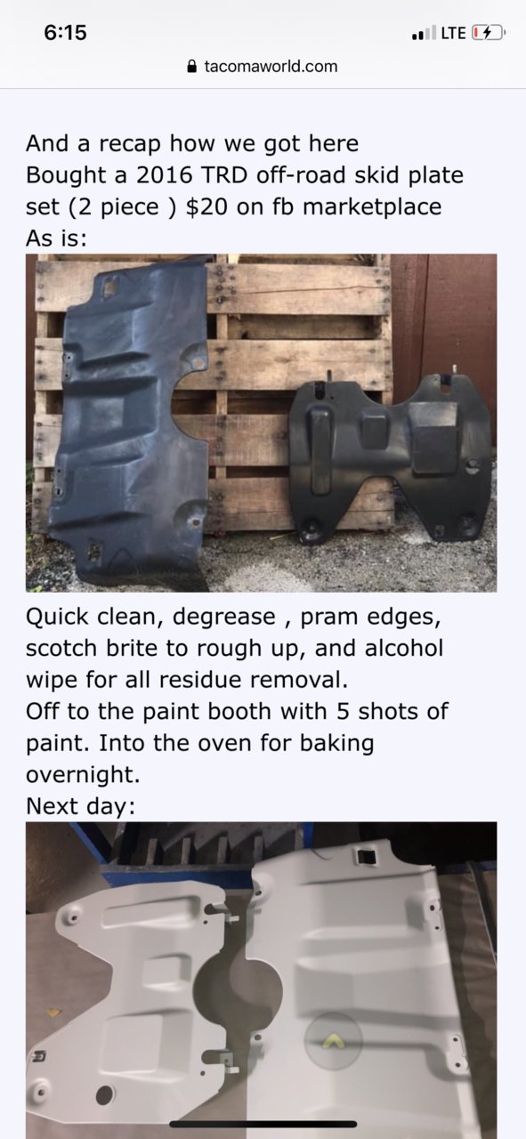

  6. Sep 14, 2020 at 7:29 PM
    BookieBob
    BookieBob Beer Drinker
    Feb 26, 2017
    #211749
    2,929
    Racine,Wisconsin
    2021 Silver Sky TRD Sport 4WD MT
    Fb marketplace.. I bought a set for $20 for a front and mid
    Jimmyh likes this.
