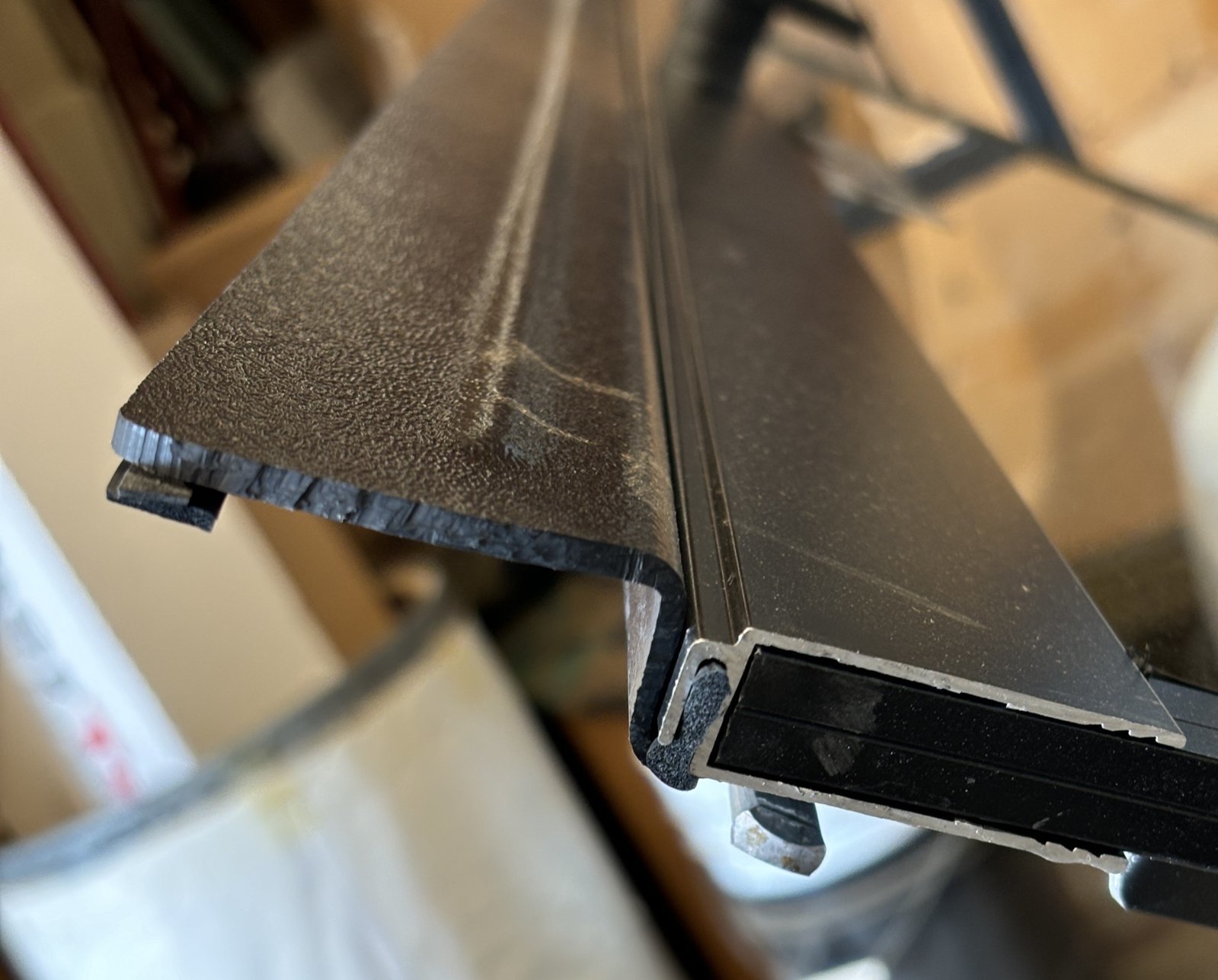

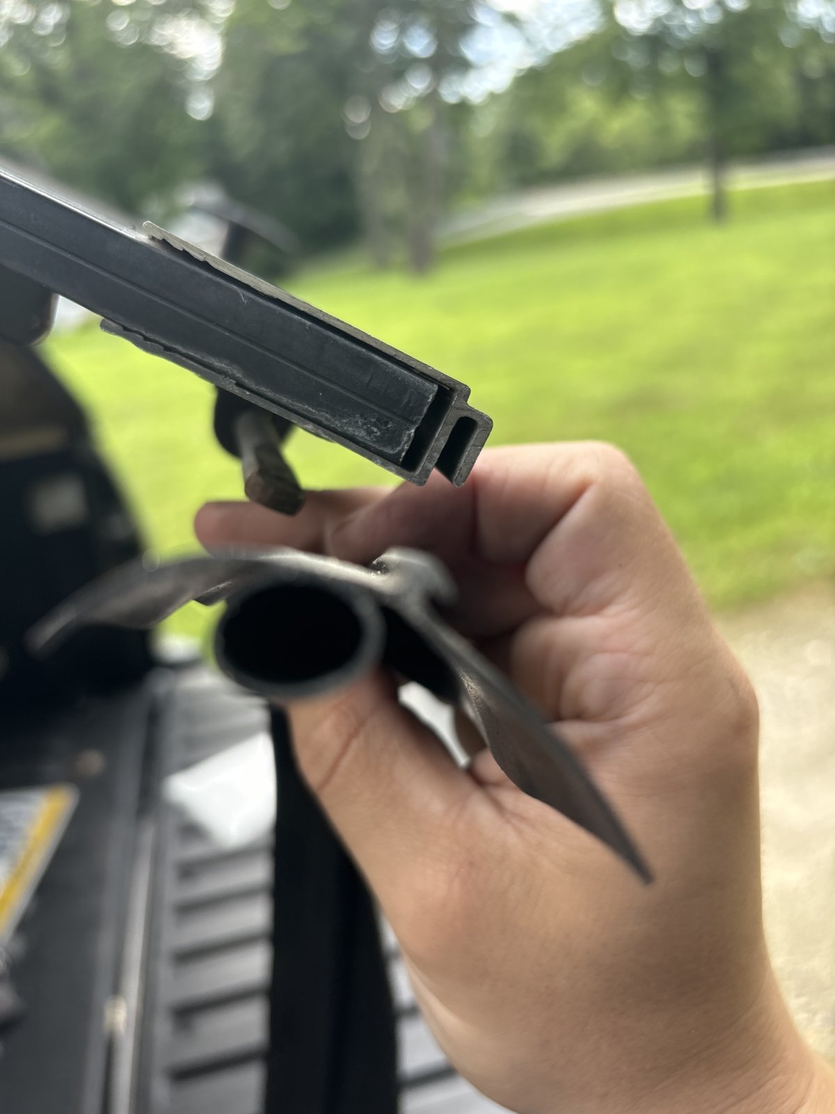

    I bought this ARE shell second or third hand and am having a time with the t-channel rear door seal. It somewhat fits but doesn’t stay. Could I be missing another piece, maybe a hard plastic “skirt” type piece? Thanks

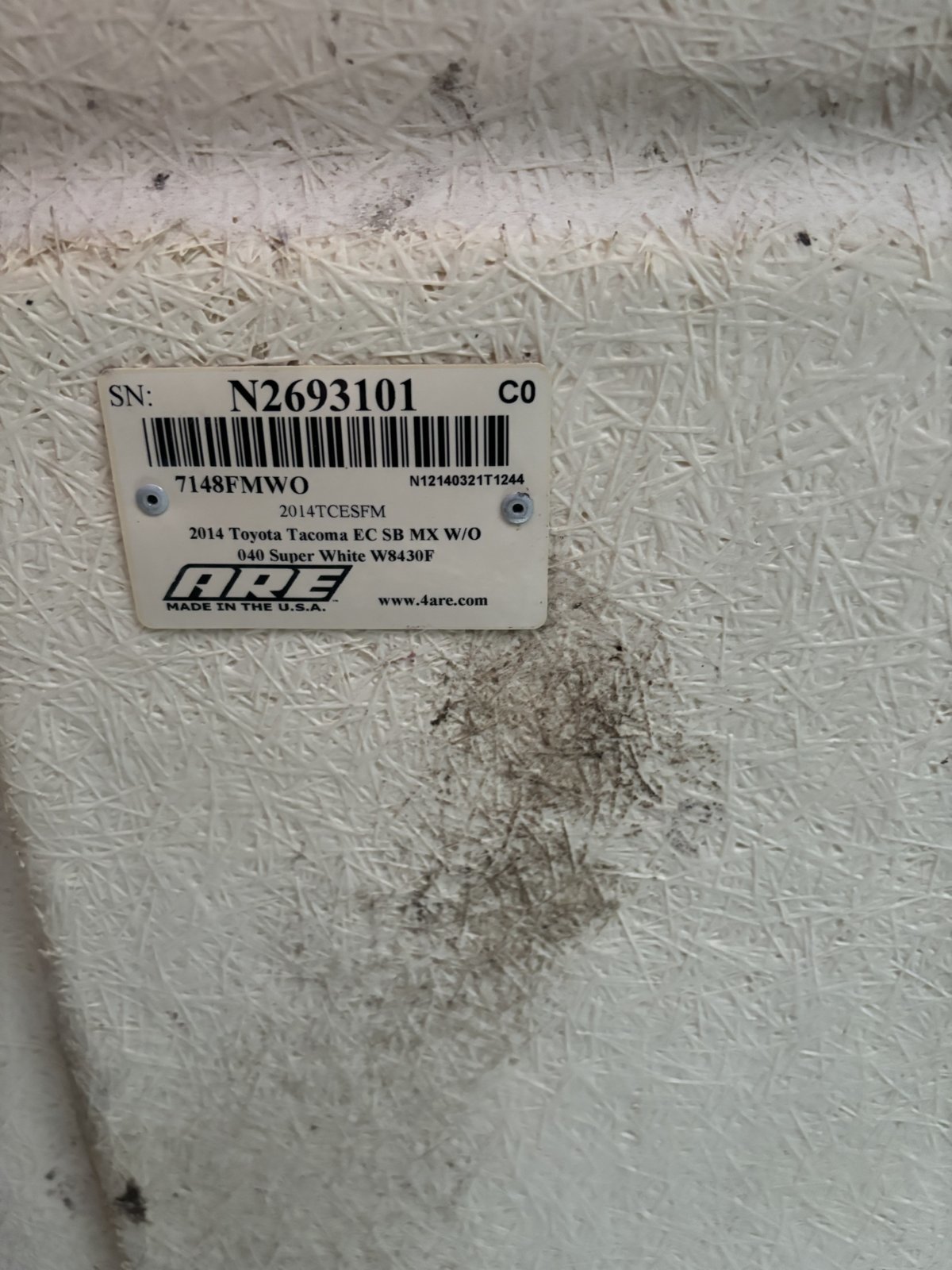

    That seal you have is not for that topper. That channel is for a seal between the door and what they call a contour strip. Get me a serial number off the ceiling of the topper (should start with an N) and I can get you a part number for the contour strip.

    Thanks for the reply! I gave the serial to an ARE dealer and they sold me this but it didn’t seem correct
    N2693101

    You need ARE part number PA-19105
    05 Tac Contour Strip CX/MX w/rivets (Used after 5/1/2010)
    (This is all assuming your truck is a 2nd Gen)
    Should be around $100 give or take depending on your dealers markup.
    Your topper was built 25-MAR-2014, FYI.
