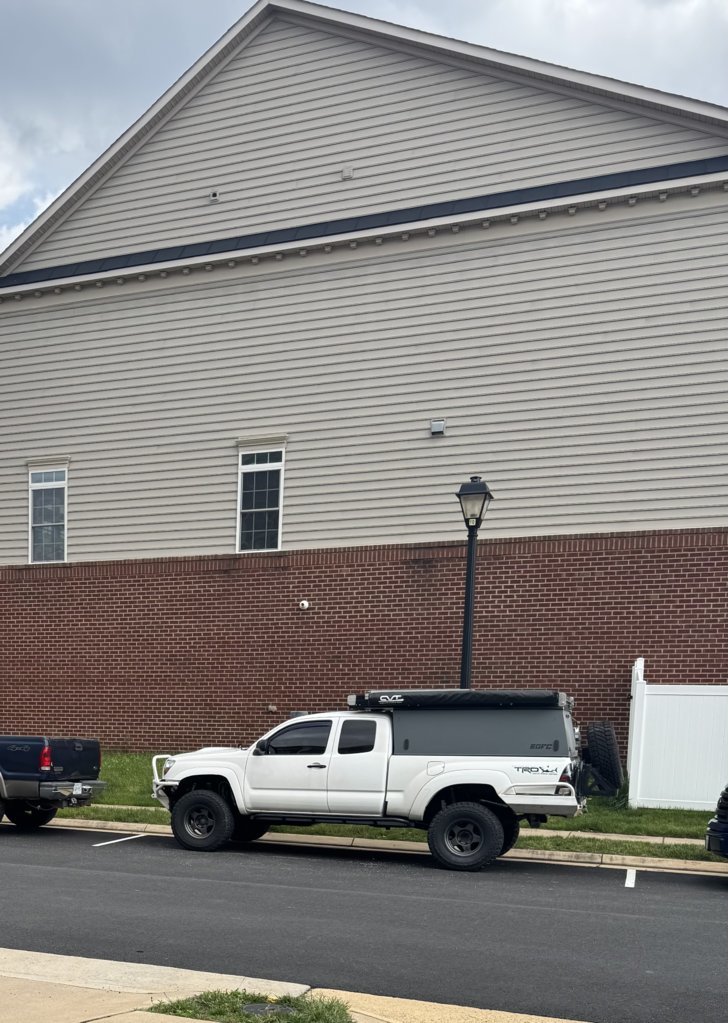

    I have a Pelfrey hybrid bumper, Smittybilt X20 synthetic, steel skids, sliders, etc. Have King 2.5 with 650# springs and Im at a 2.5" lift. I think its pretty comfy. I also considered a 600# spring, but dont want to be too nose heavy in a hard braking situation..
    I also have 2" cut from my front fenders, so in reality it should look 2" lower in the front

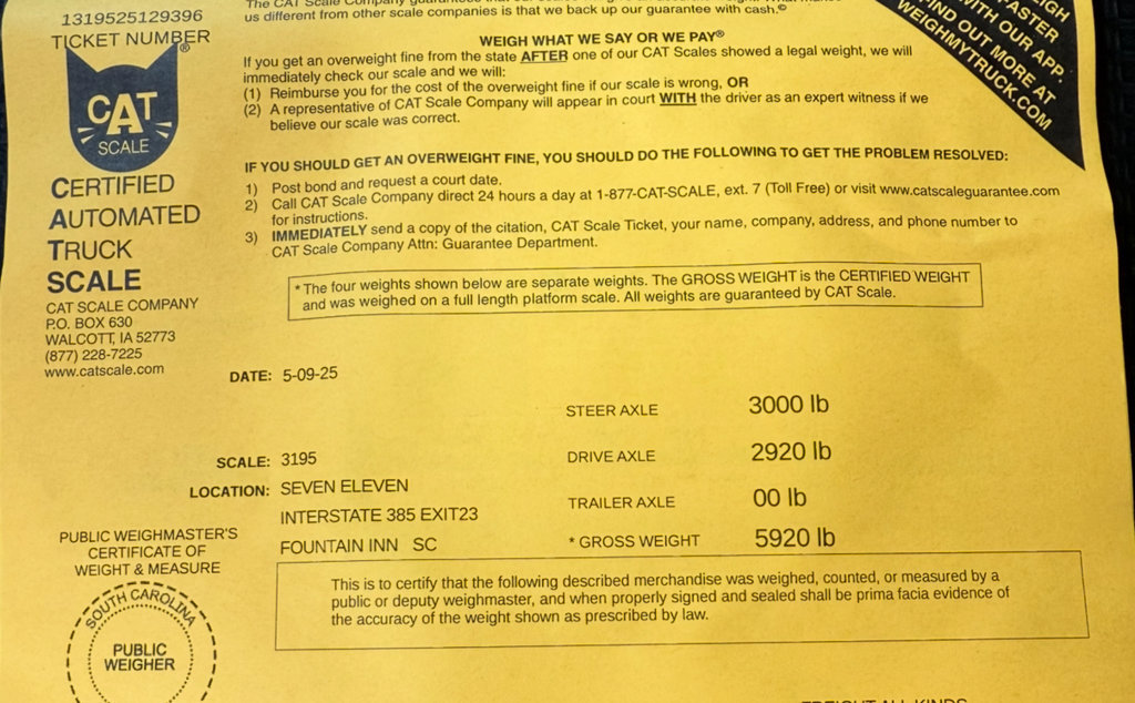

    Take your truck to a CAT scale and get it weighed up for the most accurate assessment.

    Get it weighed. If you're under 3000# on the front axle you should be fine with 650# springs.
