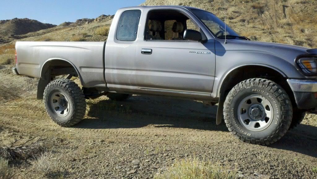

    33's on stock rims will rub, that's why.. what lift are you running?

    incorrect! well sorta..
    33x12.5s will rub on the UCA due to width and the BS of stock rims.
    but a 33x10.5 is the same width as a stock 31x10.5 so he will be fine..other then the pinch weld rubbing probably due to the hieght.
    i loved my stock 15s. But i wanted 12.5s and you can't run a 12.5 on a 7'' wide rim like stocks.
    but stock rims are sweet!.
    I repainted mine and they were awesome.

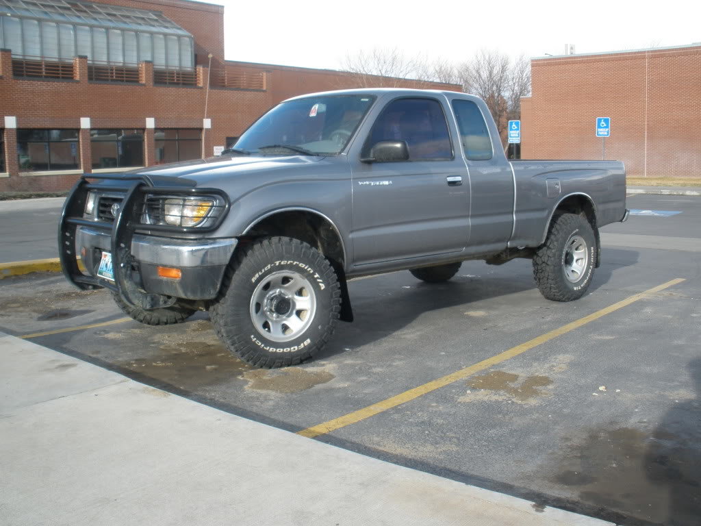

    What rims are those? And how much did that grill guard set you back??

    you can get that grill guard cheap on JC whitney IIRC..

    Didn't pay for the grill guard. Came with the truck. They are worthless though. If you hit anything wi it it'll just fold over onto the truck. I actually think they are pricey. More worth it to get an offroad bumper.
    Rim also came with the truck but I think they are 4runner rims. I found a site with em once for 70 a piece.
