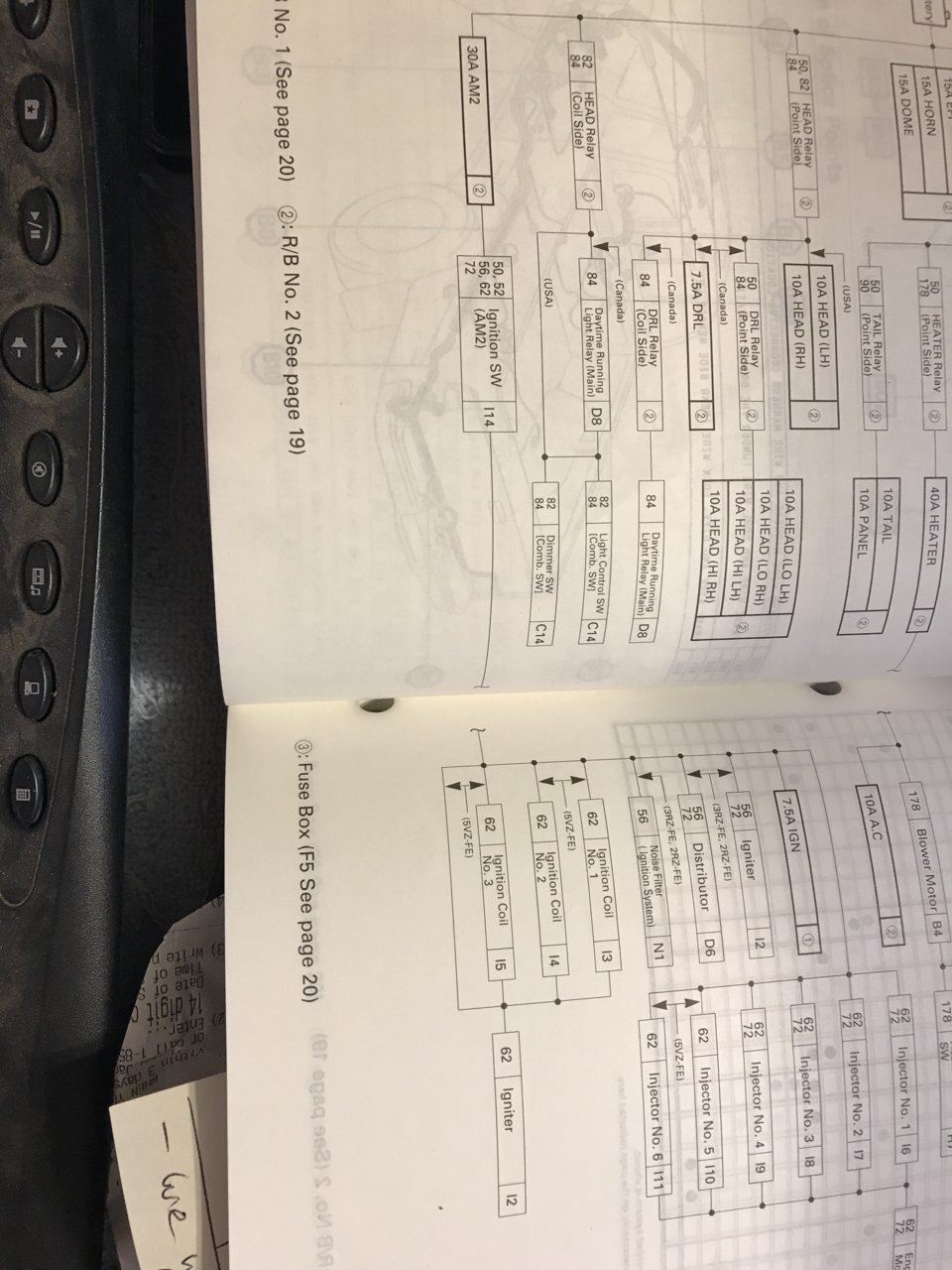

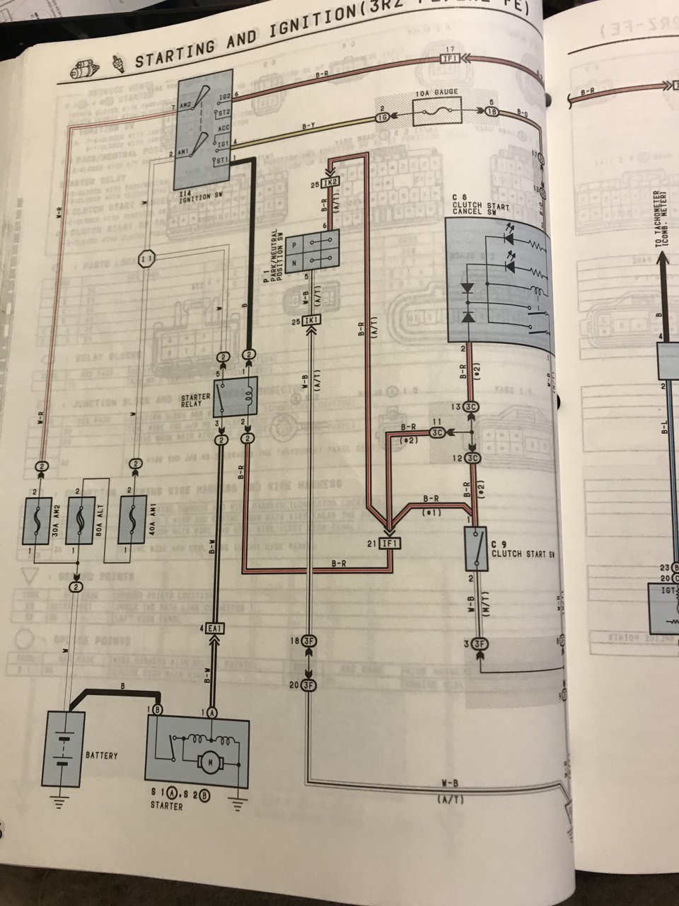

    from the Toyota Tacoma manual for MY1996. The first plate is the power flow, the second and third are the details. Usually this short is inside the distributor.

    That's what I was thinking after seeing other threads too. But what about when it's coil packs/distributorless?

    It is just wiring... it comes down to before the ignition switch or after the ignition switch.
