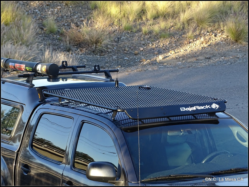

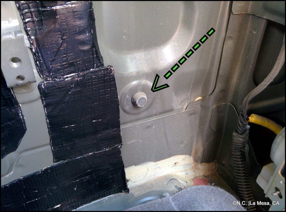

    I need some help with ideas for getting feed line into my cab. My long terms plans are to add 3-4 antennas, and maybe route power to the roof rack.
    Normally I'd drill thru the roof, but roof rack makes that impossible.
    I'm thinking of enlarging one of the factory holes in the back of the double cab and using a "Thru the Hole" marine fitting.
    Factory hole on the drivers side. I'm thinking, enlarge this and use marine fitting.
    Thoughts? Comments? Feedback appreciated.

    @Crom I used fed my RG58 antenna line underneath my cab through an existing run. I took the electrical tape off the wiring harness, added my CB line in on the passenger side underneath the seat and ran it in. Taped up everything again using the existing wiring grommet.
    If it works, it works. :thumbsup:

    Thanks.
    I did that too for the unused grommet that is under the drivers seat. On that one I ran (2) 10 AWG and RG58.
    Another alternative would be Blue Sea Cable Clam. It makes a really nice wather tight seal. But that solution is not as flexible when it comes to removals. Additions are no problem though...
