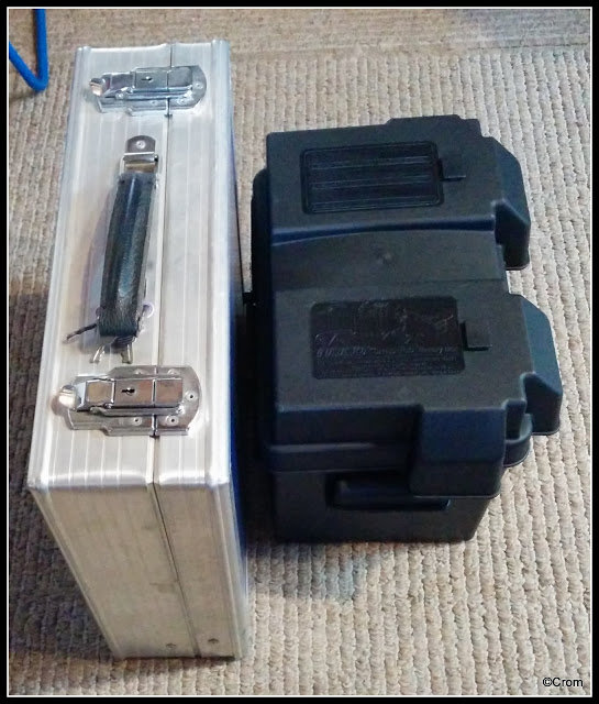

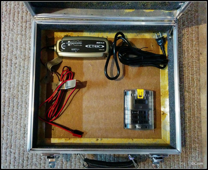

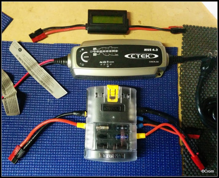

    Putting together some power basics for my base station install.
    Battery Charger, fuse block, in-line-power meter.
    10-AWG for battery
    12-AWG for 50 Watt mobile radio
    16-AWG for battery charger.
    Aluminum case. 96-amp hour deep cycle battery in a marine battery box.
    Test fitting in the case. Going to glue in some painted plywood for backing.
    Ran out of funds for the project on the wing, so took a trip to wally world for some 2-conductor-12-foot 16 AWG lamp cord (all copper), cut the ends off and doubled up the wires when attaching contacts for power poles. It's a good-fast-cheap way to get heavier gauge wiring. :D
