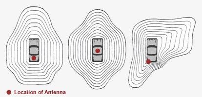

    I know that a corner of a truck isn't the best place for an antenna. Ideally I'd have a NMO mount on the roof like my last 2 trucks. However I have plans to add a roof rack so that's not an option for this truck.
    This is exactly what I wanted to know. Thanks!
    Quick question, how much metal was left around the hole after drilling it to 3/4?

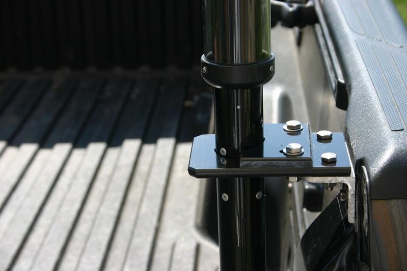

    I very much feel the same way.
    I wouldn't worry too much about it.

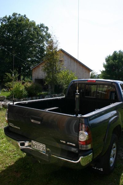

    @maineah Tim N3YLT (hasn't been active in this thread for 1.5 years) had his HF Screwdriver antenna mounted on the back bed pillar and he talked all over the world with his setup. He has reported in this thread that he did not have to bond anything in the truck.
    https://www.tacomaworld.com/threads...d-callsign-thread.260643/page-25#post-7802965

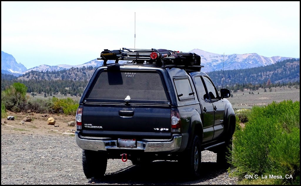

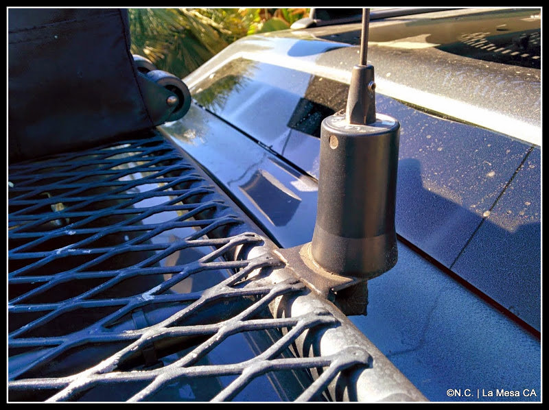

    Just a thought... You could add the antenna to the roof rack. That's how I did mine. Very happy with it.
    I know it's best practice to center the antenna in the ground plane. Here in the photo below, mine is on the extreme edge of the steel roof rack. In my experience, it's not deaf in any direction, and I can still hit mountain top repeaters 100+ miles whether I am parked forward facing or reverse facing. Seems to make no difference.

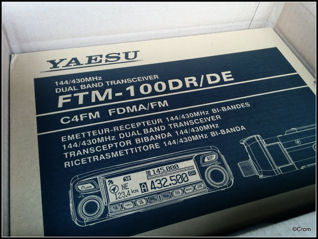

    Welp. I think I'm gonna have some fun with a new radio later today.
    I got to watch the UPS guy drop all the packages at the package depot. Not quite Ace Ventura style, but it reminded me of that scene. lol
    It's a good thing Gigaparts packaged it so well. :D

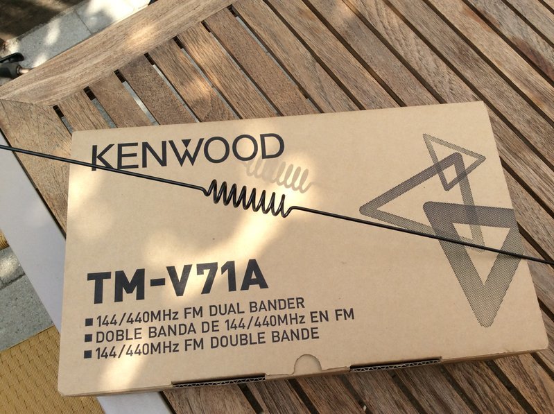

    Excellent! Great radio! Did you get the Larsen NMO 2/70B?
