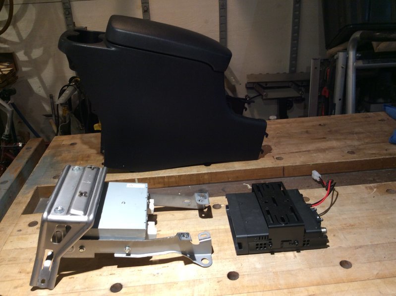

    I am considering replacing the the factory supplied inverter with my new radio. In this location it might just have better cooling than under the seat.image.jpg

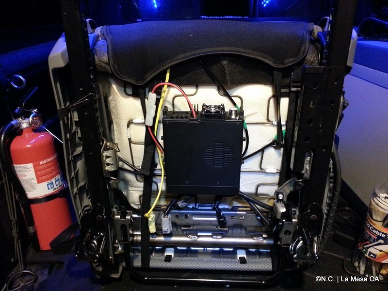

    Not necessary. My TM-V71a has lived very happily under the driver's seat for three years. I pulled the driver's seat and zip tied the mounting bracket to the seat springs.
    I can program it easily as the rear ports are accessable when seat back is in the forward position.

    That's exactly how I installed my TM-D700, although under the passenger's seat, and turned 90 degrees because of that cross brace.

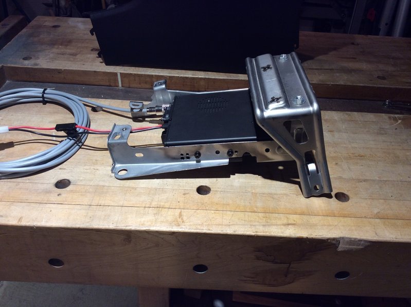

    Thanks Crom and Lars. As you can see the V71a is almost a drop in replacement for the inverter. Having yet to use a radio I was not thinking of programming!
    A few holes in some unseen brackets and some time wasted is the only damage sustained and I will have my truck back together shortly.
    So under the seat it goes. I am spinning my wheels on the install as a roll of sound damper material is somewhere in transit. I have an urge to start pulling the interior out so I can get on the air.

    The TM-V71 is an amazing little radio and I like the idea of where you were going to put it actually. I'm still trying to figure out if I can fit a 1000w inverter in that space, and still wire it up to be activated with the factory switch ;)

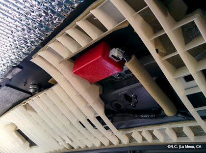

    Here is a geek post for you all. :p
    When I had my headliner down, I pulled this off the TPMS receiver.
    Toyota Part No. 89760-35021 FCC ID: HYQ13BCG, Made by Denso, in Japan
    I looked up the frequency of device, 314.98 MHz of the ISM radio band.
    Very geeky, if I may so so. lol

    That's the same band, slightly different frequency used by the TrailToys "No Strings Attached" switch box I've got in my truck.

    Wait a min.... One of the reasons I got the Kenwood was the reported ability to program it from the unit with out the PC hook up.
    I am back to putting it in the inverter spot. I didn't quite get mounting right and I need to raise the radio a bit to clear the hand break cables.
    I will half to make a hole in the side of the console for the mic cable. Other than that it is reversible and the radio tucked nicely away.

    This geek wants to know what happens if this unit is unplugged? Would the light go away?
