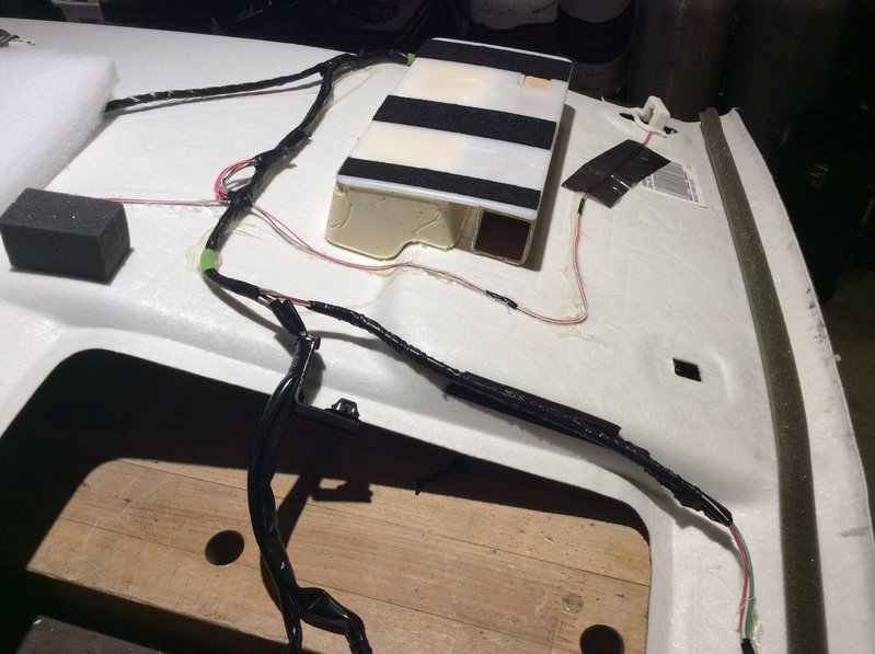

    image.jpg These blocks are interesting. They seem to be for a solid landing for the sun shade on the other side. I am not sure as to what to do with them when I insulate.

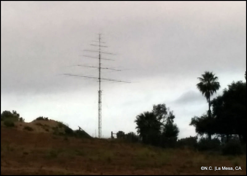

    I found this very impressive array of antennas over the weekend.
    Sorry for the horrific picture quality. :D

    Holy cow! Was that a residence? It looks like a news station or somethin'.

    Yes it was a residence in a rural area.

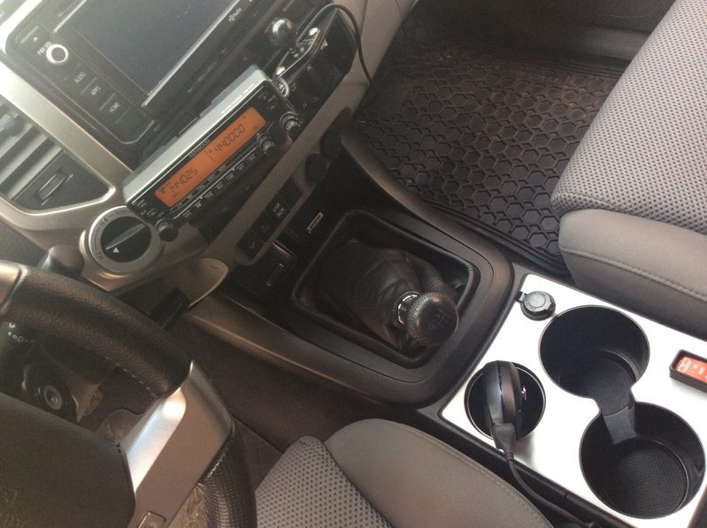

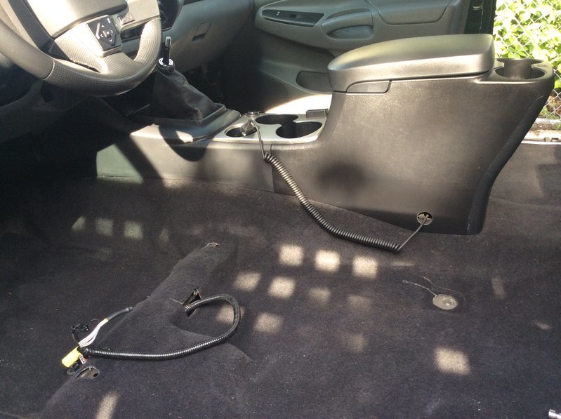

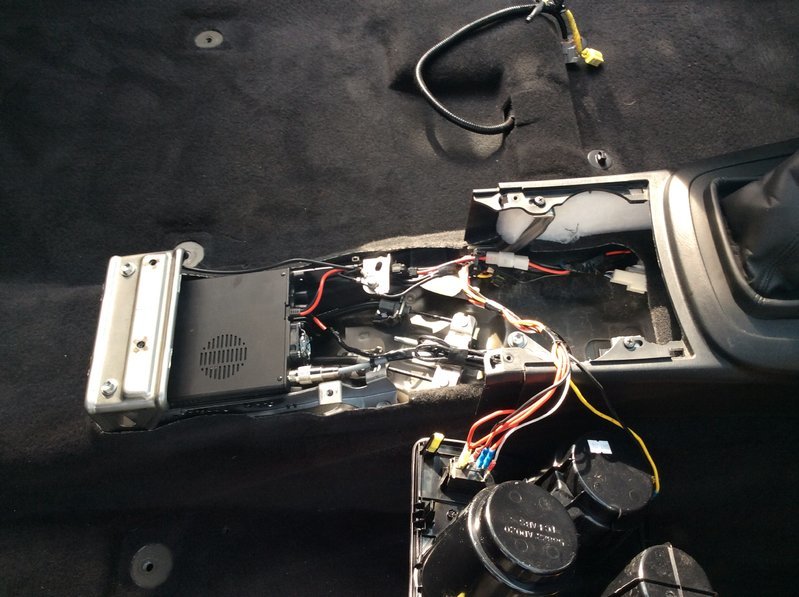

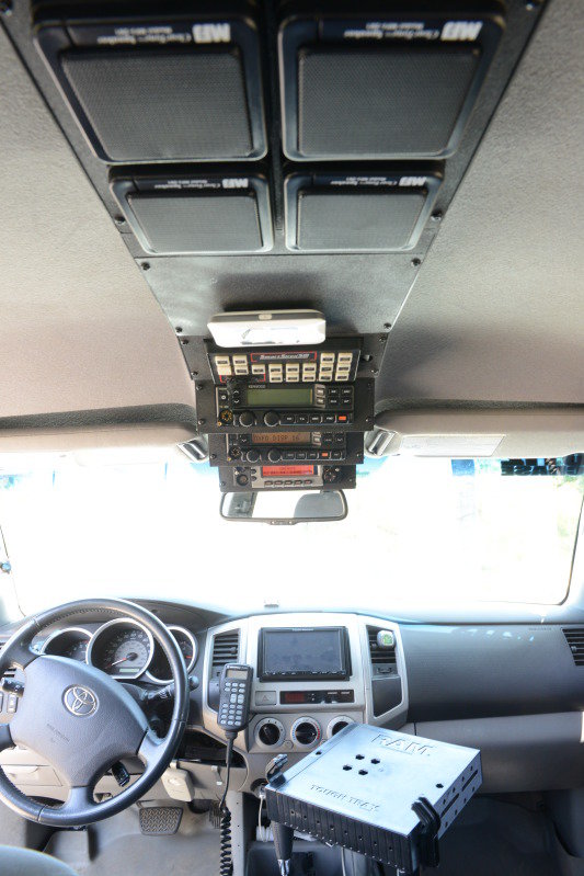

    Chipskip and Crom like this.

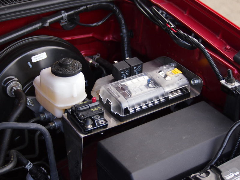

    I made this mount awhile ago for a blue sea 12 circuit block. Relays are mounted next to it, though I don't have room for 12 of them... Only 6 will fit with this design. The whole block can be shut down with the breaker on the left. It's really easy to wire up accessories. I just got a CB a few days ago and instead of running the wires to the battery, the hot one will go to an empty slot on the fuse block and the ground goes to an empty slot on the ground bank of the fuse block. The whole block only is powered by one hot and one ground direct from the battery.

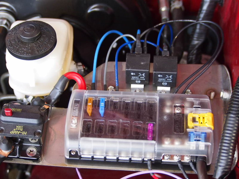

    A pic with some wiring
    I don't see any reason you couldn't do a similar setup under your seat. I'm not sure about using a relay to kill/activate the whole fuse block. Since it's a direct line from the battery would it have to be a fairly burly relay, like a big solenoid? If you use a relay to power many things simultaneously it would probably have to be a pretty heavy duty relay.

    Mine is setup much likes this. I had to jump a car the other day, simple tripped the breaker to protect everything. Reset it when done. Although my relays are on a plate behind the battery. I have way less room under the hood than you.
    Several 2nd gen guys have setup the fuse block, breakers, and relays behind the rear seat. Check out the dual battery thread for ideas.
    Spend the extra money now and go with the 12-circuit fuse block, it is better to have some and not need them than to not have enough. Give it time, you will fill them. Inverter? Lights?
    If you want to do all the radios on a switch/relay, that is very easy to do. In that case you would want a dedicated fuse block just for the radios, no lights or inverters or anything like that, just the radios. You can do the math on the radios power draw and the size relay you would need.

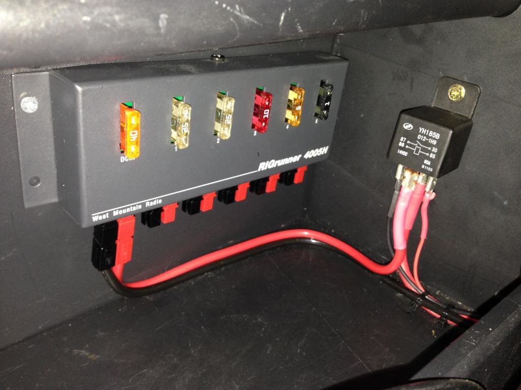

    That's a super clean install! :thumbsup:
    If I went the relay route, I think I would use a Stinger 80 Amp relay. They sell for $15 and I've got one under the hood for my ARB twin compressor and I like it a lot.

    I think for now I may just add the fuse block under the seat and see how I like it...
