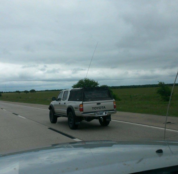

    Thanks for the call-out. I wouldn't bother bracing it like that. It is EXTREMELY flexible, and I don't even have it on a spring (My SWR is better without it). I have used the radio with the antenna tied down and standing tall. It obviously performs far better not tied down. It does fly around a lot off road, but just make sure nobody is standing within 10' of your truck when you're on obstacles and you should be safe. Nobody should be that close to a vehicle on an obstacle anyway. The performance is tons better than my 3' FireStik I was using before. Here's a pic of me doing 70mph on the highway to show how much it leans back.
    It will probably smack the back of that camper shell though. They call it a whip for a reason!

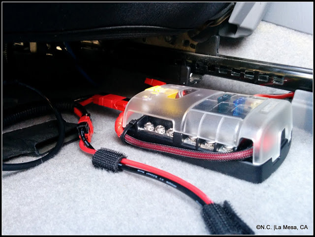

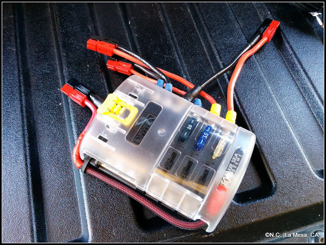

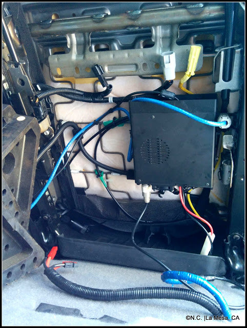

    @weldo @Chipskip Thanks guys for the encouragement.
    I had to reposition my radio under the seat to make enough room for the auxiliary fuse block. Added it Friday. I didn't have to buy anything to do it, except 10-AWG primary wire, and damn, that shit is stiff! lol
    Anyway here is some pics.
    Built fuse block
    Justified radio forward and to the left. Zip tied / velcro all connections to radio for strain relief
    Installed on the floor. Velcro holds it down.
    I hooked up the FTM-100DR to it this weekend with a 1/4 wave mag mount and it worked great!
    Very happy with the outcome.

    Box looks great! I like the use of plugs for connections.
