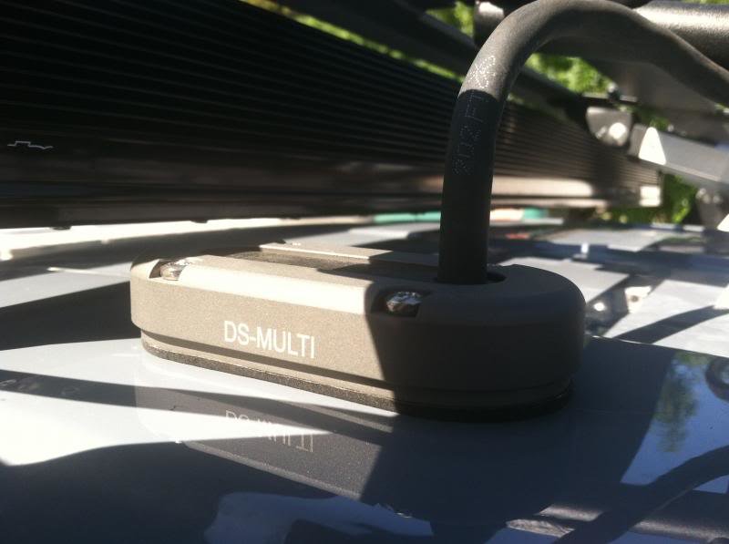

    @BenMara I ended up buying one of those to check it out. They are Heyco Grommet & Liquid Tight cordgrip. It was $6 delivered. Appears to be good quality Nylon construction.
    They certainly would work for passing feed line through sheet metal.
    Thanks again.
    Another option I learned about is the Scanstrut DS Multi. It appears to compete with Blue Sea's cable clam.
    I like the rectangular shape.
    Pic seen in this thread here
    Searching around I found another forum member who installed one here.

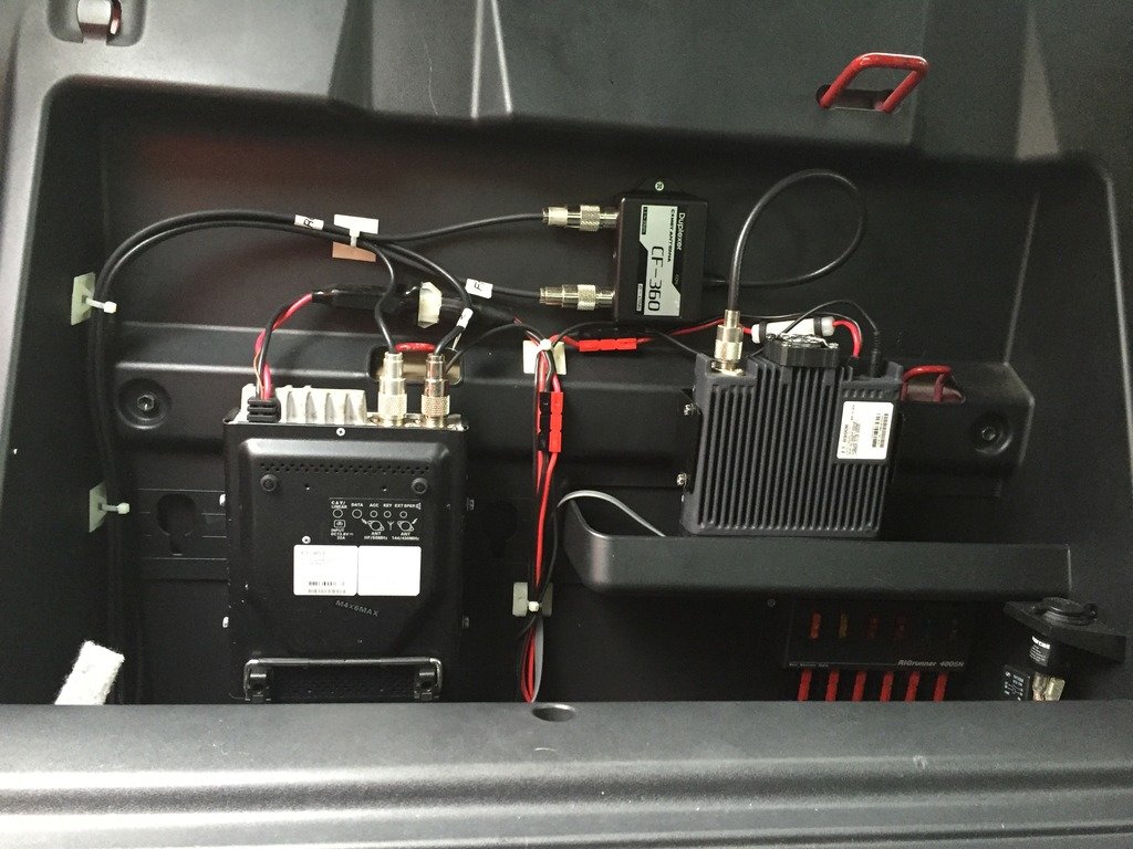

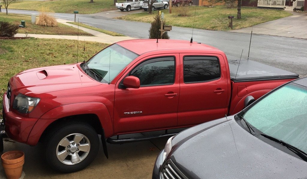

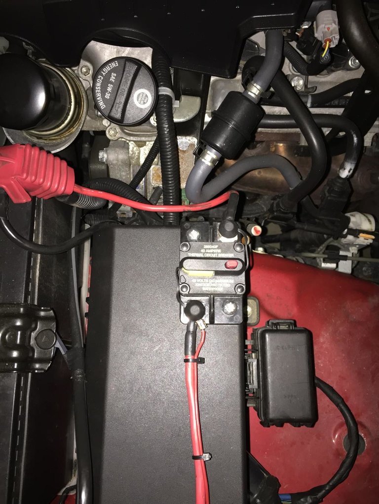

    Ok better late than never...

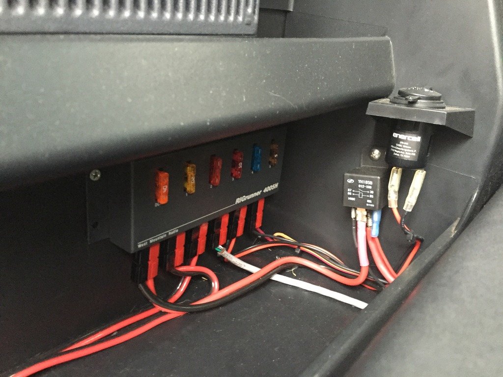

    Power is directly off the battery through a 40A breaker.
    085F06F1-BCF4-4ED0-9668-059D489888EA_zps_a88a8264e46d1d1064bcb8ca2d1928fe9afdf9a4.jpg
    Feeding the RigRunner via 60A relay.
    8EB10623-7FFB-4153-A4C4-D5F08110073E_zps_a6ba476e545a52e9d095f0c366a6dfa89a1e8ace.jpg

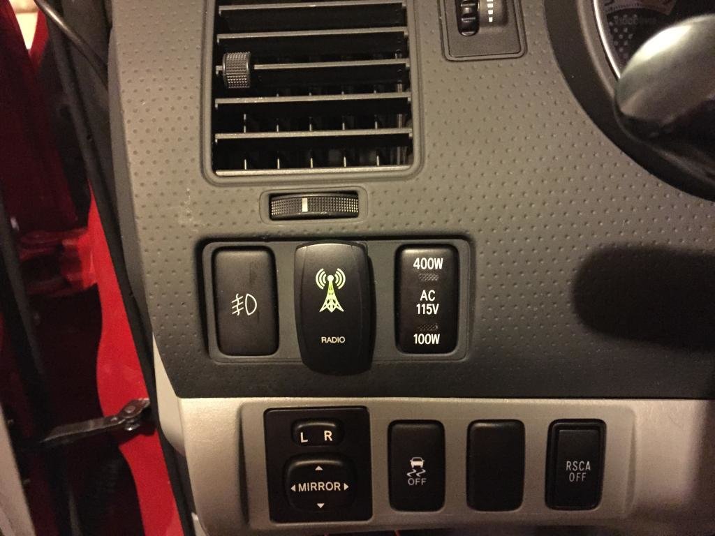

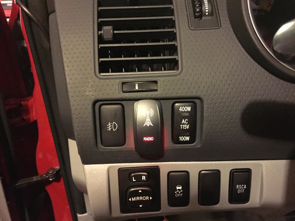

    Which is controlled by a center off switch on the dash. Up (red) is ignition switched.
    94FF8CA5-C03A-4BFD-9368-F7B787BAFF0E_zps_9ba4731435f4b324e14aaaf9293a253410b26b59.jpg
    Down (green) is an override that lets me turn everything on when the truck is off.
    0CB222A5-0618-4366-907B-B6362CEB5F41_zps_879dacff01d5cf43b1c87299b1609b9492da1624.jpg
    The bodies of the FT-857 & FT-8900 are behind the rear passenger seat along with the diplexer to split the output of the 8900 (10M/6M,2M,70CM).
    B0CB4065-DC45-4DF5-BD35-8CE9B66232A8_zps_36f905cb95f6b2f15614ad6c7d55c49287fcd6d5.jpg

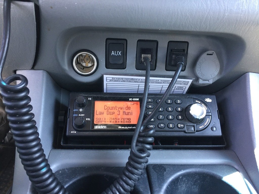

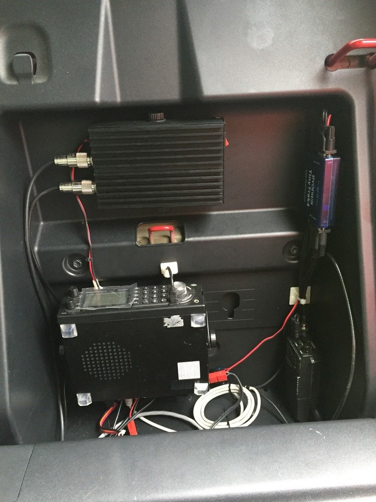

    Behind the drivers side rear is the BCD996XT Scanner and the APRS beacon consisting of a TinyTrak4 feeding a hardwired FT-23R and a RadioShack 2M amplifier. The GPS for the beacon is split to provide GPS to the scanner also.
    02740E46-EFDC-415F-864A-FC4B727E6180_zps_fe50d19df86e62a12db5a49573d9478758aea0ab.jpg

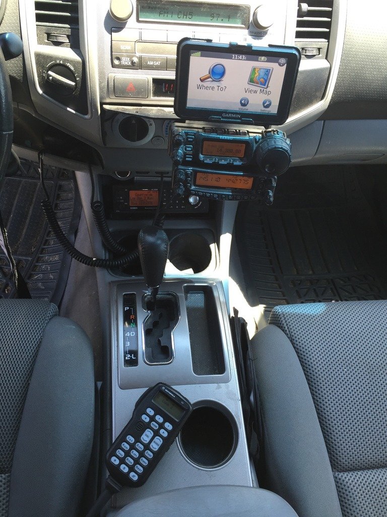

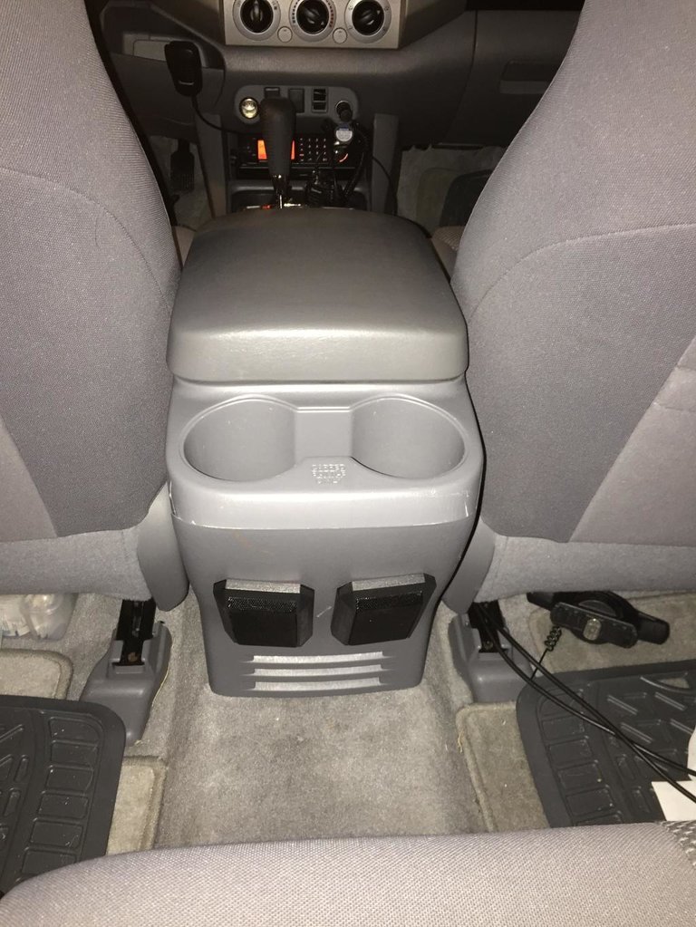

    Up front are the control heads, the scanner head fit perfectly in the lower pocket in the dash, the '857 & '8900 heads and GPS are on a Tech Deck from Bird Dawg. The Motorola W3 HHCH is for an XTVA that is sitting in the back floorboard waiting for me to have time to permanently mount it, this is for the XTS5000 that I carry for work, public safety monitoring and analog/P25 ham.
    18F7855A-5EE6-40D0-8CAD-9932DD3D17BD_zps_548ed2d40232d39b1029b754c74ae0e4e6964411.jpg
    The mics for the '857 & '8900 are run through the dash through switch blanks.
    24793697-1537-4706-8DCF-8E827818017F_zps_1ad9afe268136fe02a8e4c8f4d6497b8db96b24f.jpg

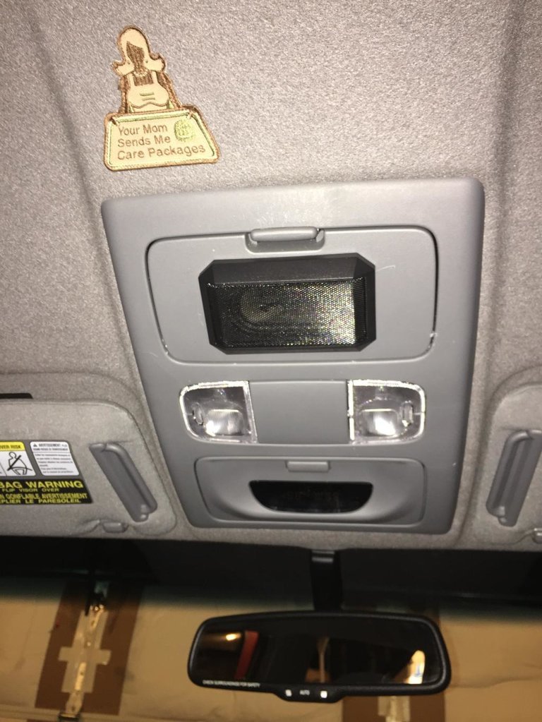

    The '857 is connected to a speaker in the sunglass holder of the overhead console.
    B1A502E0-9C9E-493F-AB55-2DA65FC81D14_zps_c8c5472dd417b35dd9311778b901aa8f8f942962.jpg
    The '8900 and scanner are connected to speakers in the rear of the center console. This is not working as well as I had hoped and I am in the process of multiplexing all three radios on to the speaker in the overhead console.
    C470FFFD-67B2-41A8-BB90-5A4B9F6A6F08_zps_7c2e192a982d6ed592b6180751c9c24aab4d51f6.jpg

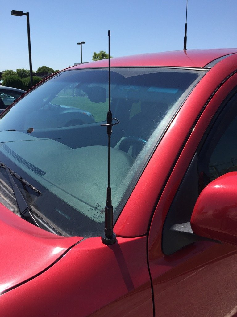

    The antennas:
    MFJ-1402, the beacon and XTVA are both hooked to this via MFJ diplexer.
    5103102B-2956-4598-B8B8-742D520A0684_zps_797776c73ef4883321f9a82cc8745992267e6396.jpg
    Larsen NMO-150/450/800 for the scanner.
    D4ACE030-A108-46EF-A31B-D00FB2883B4C_zps_b621c1bb61cdabf40ea62f835f9eda4687f2063c.jpg

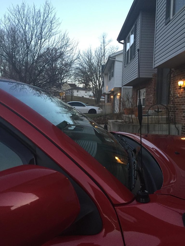

    On the roof, Maldol EX-510NMO for 6M/2M/70CM and a Larsen NMO-27 for 10M. For HF I am using "hamstick" type antennas on a BAMF mount.
    E3A2B403-D230-40AA-942C-CD8C68F6573C_zps_2c29d1983e3092698b90456779facf57bd3680a2.jpg

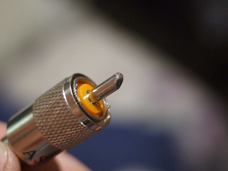

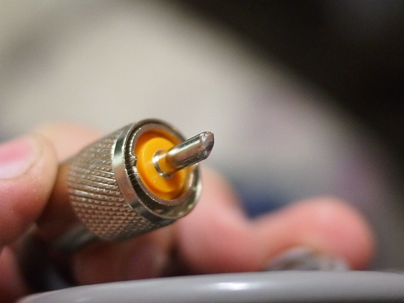

    Hey guys, I got most of the stuff I need for install. The stud I'm using is a Wilson heavy duty stud. Like this one.
    Just to double check the install order, it would go from bottom to top looking at the stud from the side... bottom half of stud, mounting bracket, plastic insulator, then top part of stud.
    Also I've heard some people having trouble with coax connection on this stud. One guy mentioned that he re-soldered the pin to be more round on his coax plug. Here's what mine looks like, you guys think there's anything wrong with it? Could it be lightly filed to eliminate sharp edges?
    The connectors say ASTATIC on them. Cable was $16 on ebay.
