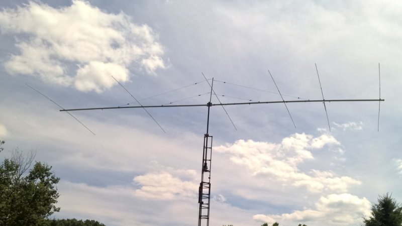

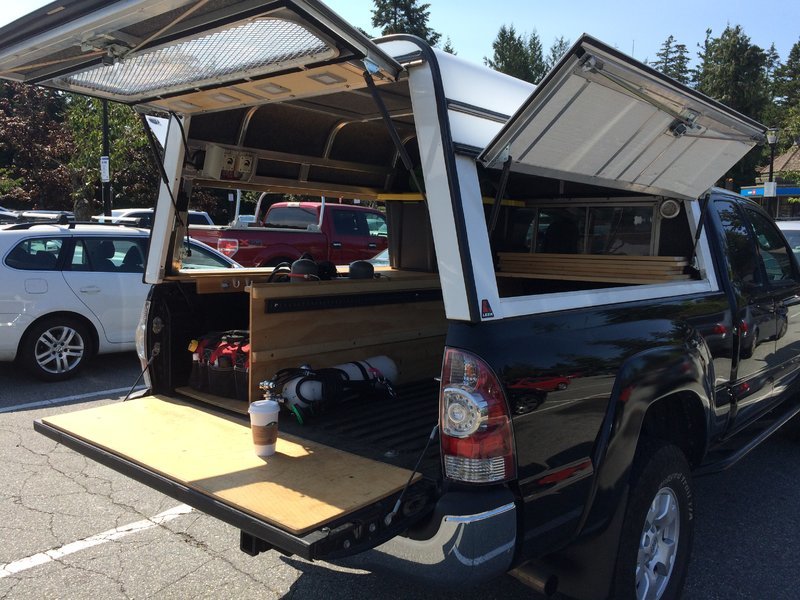

    image.jpg The back of my rig. Diving not camping this weekend.
