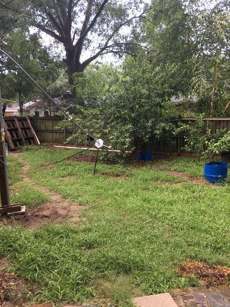

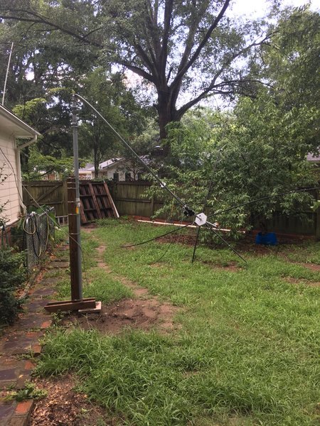

  17. Aug 9, 2016 at 5:56 PM
    #2437
    BenMara
    BenMara That Asian RedNeck
    Apr 14, 2011
    #54903
    1,951
    Ben
    Belton, SC
    2011 DC 4x4 SCed
    TRD Blower, Ham Radio, DBA T2 Rotors
    This happened July 14ish. After coming home from Philippines.
    it was a really bad cell storm. I believe it was a down burst
