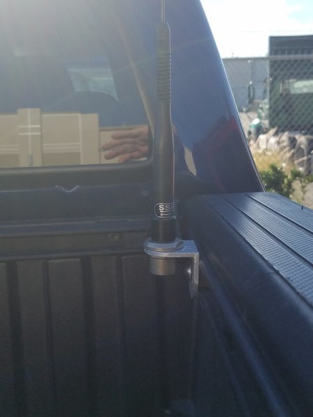

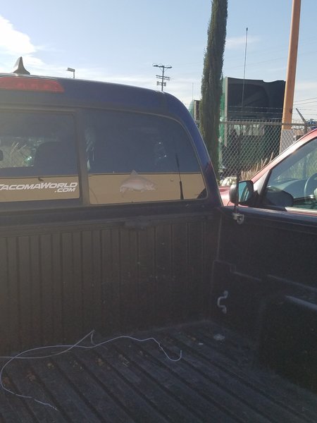

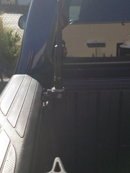

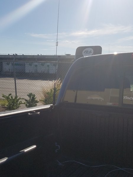

    Here is how I mounted my 2 antennas. they are both dual band. the drivers said is for my Kenwood TM-v71 I use that to talk on all the time I use a few repeaters a couple are a pretty good distance away.
    The other is a dual band antenna but I just use it for APRS on 2 meters. Both mounting brackets are leftovers from other radio installations in cars I had in the past. Both antennas are using UHF style connectors.
    I ran the antenna coax through a couple plugs that are on the back of the cab. I pulled the rear storage compartment out to get to them.
    I can give you more detailed photos and instructions if needed.
    Sorry the photos didn't turn out so great

    You don't have any issues with grounding do you? Or are they ungrounded antennas?

    SoCal - 818
    2014 Prerunner V6 double cab
    No issues. SWR is good on both. I've checked SWR on both with a 2 diffetent meters a couple times. No problem talking local simplex. Durring my commute, i talk on a UHF repeater that is 53 miles away from my house.
    My tx/rx is probably impacted a little bit because the antenna is close to the cab though.
