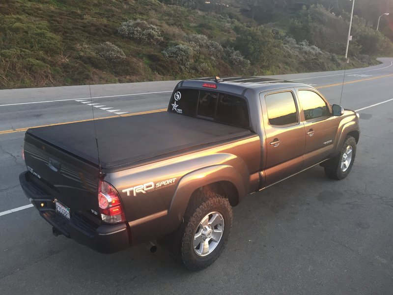

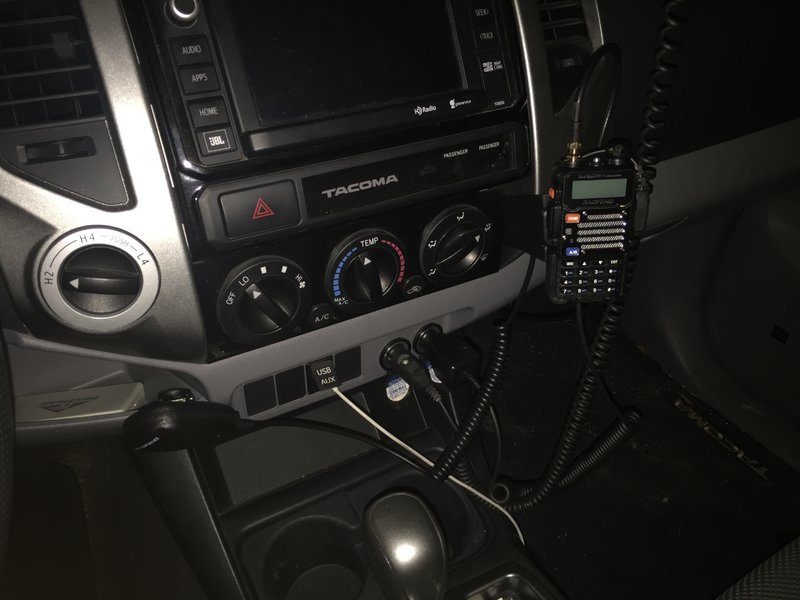

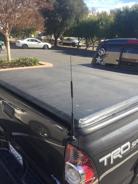

    Here's my current set up
    Panavise mount to hold the BoaFeng F9V2+
    BAMF tailgate mount
    Comet SS-680SBNMO antenna
    Got a adapter cord to connect the BoaFeng to the comet antenna off Amazon
    Coax sneaks in at upper corner of the tailight then drops down to the frame and runs along the existing wiring harness
    Too many cords for my preference but works for now
