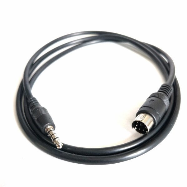

    Okay looked at the ftm100DR again with purpose of integrating with APRSDroid.
    The radio ships with a data cable that yaesu provides in the box. It's a proprietary 10-pin mini-din to USB! A Windows computer recognizes the cable as a serial port because the cable has in integrated USB to serial controller. Cable not helpful for Android tablet, I will note that USB to micro USB cables exist, but that doesn't mean it going to work.
    So going the old school serial route...
    Yaesu does make a 10-mini din to db9 serial cable for $50
    Yaesu part number Ct-165
    That combined with a rs232 serial to Bluetooth device $70
    https://www.iogear.com/product/GBC232A
    Should work.
    So as you can see, kind of expensive; a kludge

    https://store.mobilinkd.com/collections/tnc-cables/products/minidin-6-tnc-connector
