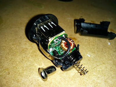

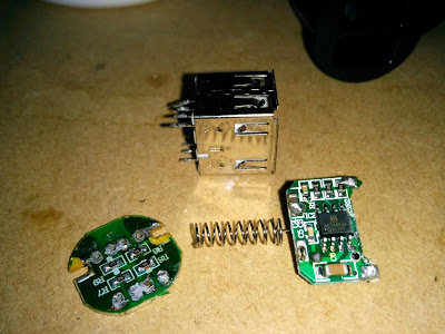

    I don't have a silver bullet for you guys, but I can offer some guidance.
    Solving RFI or EMI can be a pain in the butt. Much of the consumer electronics bought today is garbage. It is so because it was designed poorly. A lot of circuits are designed as cheaply as possible and don't have proper filtering on the input or output, some have no shielding. Often times when these problems exist there is no good solution, but to find a better (properly) designed and built product.
    My experience with RFI is limited to switching power supplies.
    The best thing you can do for yourself is take some time and read up on RFI /EMI and how to solve it. Understanding the problem is crucial to solving it in a timely manner.
    A Ham's Guide to RFI, Ferrites, Baluns, and Audio Interfacing
    ^ I recommend this guide.
    I quoted some of my old posts below which have other links and useful info.

    Good to know that I only use Aukey chargers in my truck!
