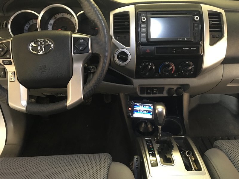

    I looked at mounting it in the sunglasses holder, and it is definitely doable with a little modification. I ended up just buying a cell phone cup holder mount and using that while in use and then storing it in the center console when not in use.

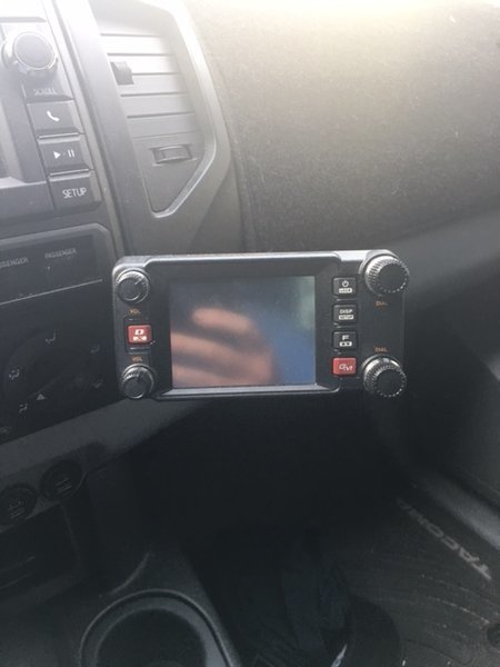

    Here's another ftm400

    That's another option I'm thinking... I just worried about the passenger bumping their legs off it, invading their space over there
    Your thoughts?

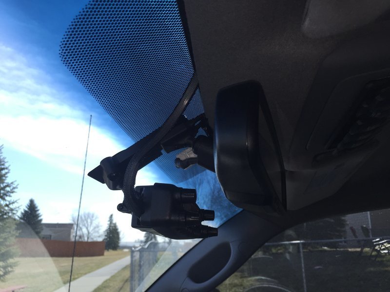

    How about a bracket that raises the mirror and has a ram ball mount under it?
    http://www.birddawgindustries.com/mirror-riser.html

    I don't seem to have any issues with people striking it.

    I have one of those. I had a scangauge then my ultragauge under the mirror, I found it defeated the purpose of the bracket... which I thought was to get the mirror up out of the way so you have more windshield :notsure:

    True. You don't really gain much by moving the mirror other than being able to put something where it was. A net gain/loss of zero visibility essentially.

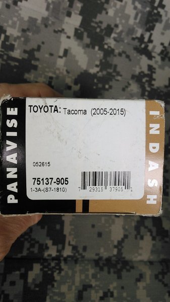

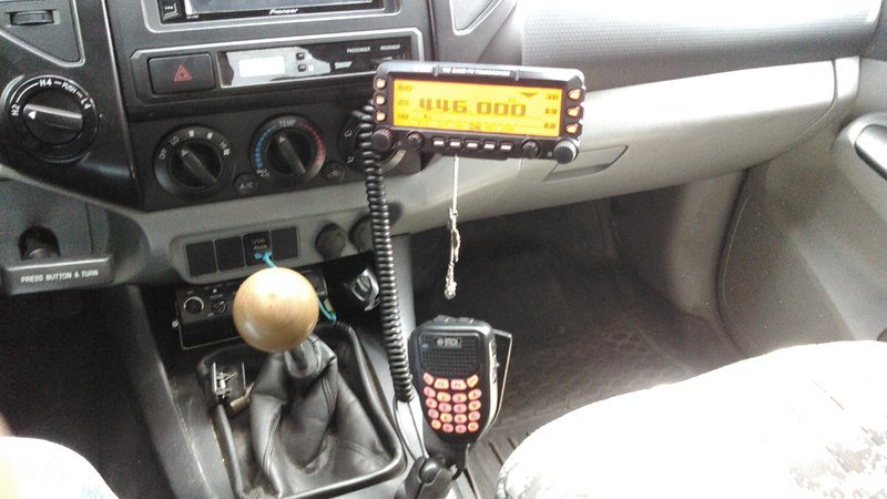

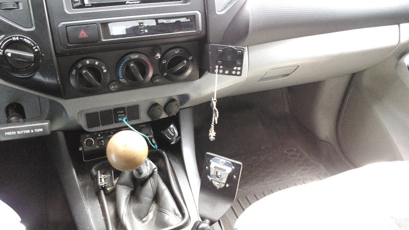

    Similar setup here, not the same radio though. No problems with my passenger either. I keep it locked up when not in use so wanted it without a bunch of cables dangling around. The Cat5 cable for the faceplate just pulls out of the dash and then tucks back inside when not connected. Had to drill a small hole in the underside of the radio bezel. Dash plate is a Panavise, mic holder is made from RamMount parts.
