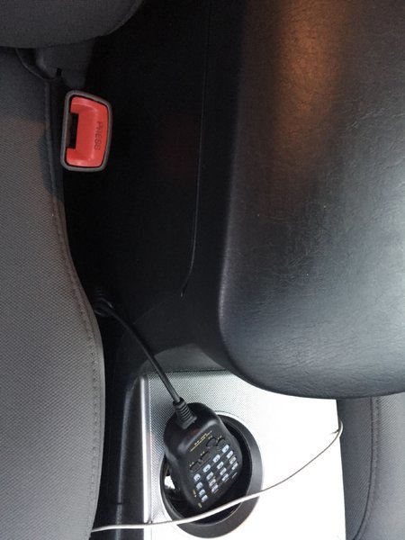

    Yea I thought of that... hasn't moved in a few weeks including some spirited driving. Takes quite a bit of force to move. Had to get it positioned just right so that the seat and its hardware wouldn't hit it when moved. I guess it could come loose in a wreck, but it would still have to get out from under the seat... it also means that the power wire and head wire dont have to be extra long to allow for movement.
    Currently I have the mic cable coming out of the radio body and resting in the useless can cupholder.... I want to eventually re route and put a connection in one of the empty switch spots.

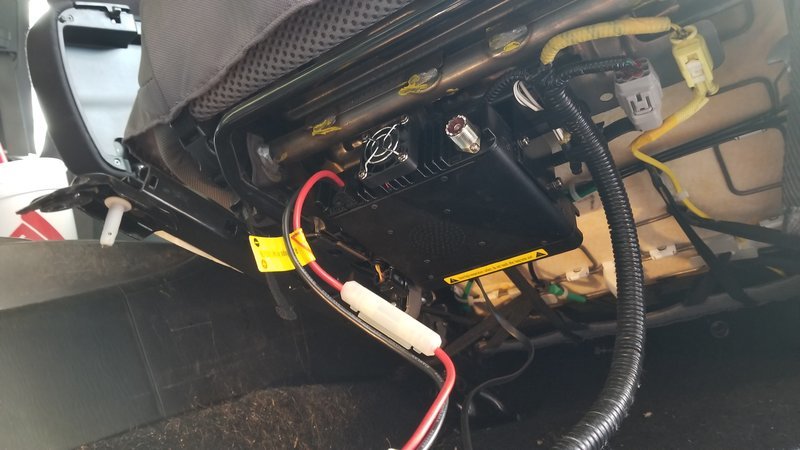

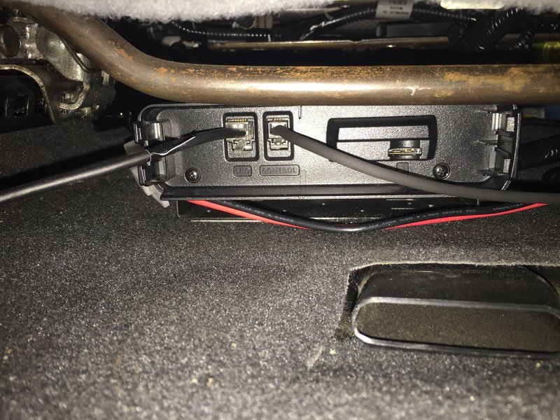

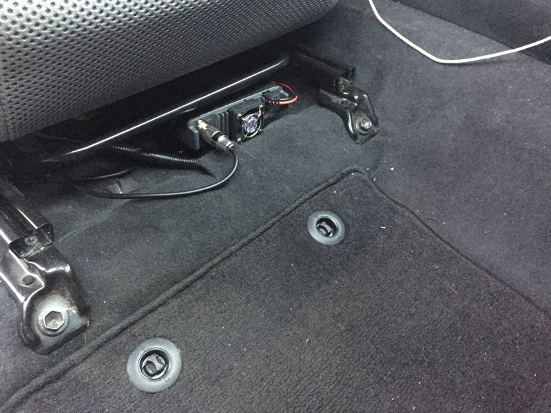

    Here are some photos
    This one the seat is all the way back... When it's matched about even if just behind the driver seat the adjustment bar hides the radio and coax.
    Here is from the back with the seat all the way forward
    Mic
    What I used to hold it to the carpet
    Not perfect but it works...
