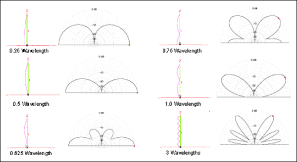

    This is also were RF pattern out of 1/4, 1/2, and 5/8 wave antennas comes into play. Are most of your repeaters up on mountains or is everything you doing along flat ground?
    I can't find the chart that shows each antenna's radiation pattern, sorry.

    Most of the repeaters around here are up on hills.

    If I remember right, if not someone will correct me. 1/2 wave will go out long and flat, while 1/4 wave will go out at a greater angle. 5/8 wave does a little bit of both.

    This what you're looking for?
    Keep in mind, the wave propagation in the pic above changes with antenna location, VSWR, frequency in use, blah blah blah...
