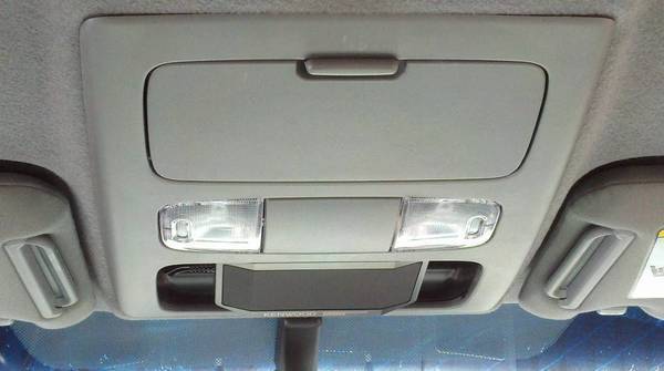

    One of the things that was important to me was a clean, modest install, that flowed with the truck. Here's a summary with pics:
    I mounted the body of the radio (Kenwood TM-V71a) under the drivers seat with zip ties. I used the factory mounting bracket so that the radio would not contact the seat or the vents on the floor in order to provide better circulation for the radio.

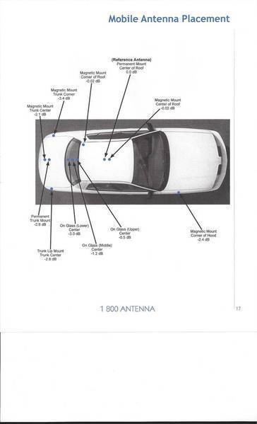

    I checked out the antenna chart that Crom mentioned previously:
    Based on the chart and the fact that I wasn't completely confident about me drilling a hole in the roof, I opted for a glass mount antenna from Larsen:
    #3 - The interior coax of the glass mount is the only wire you see
    The obvious issue with mounting a radio under a seat is the clarity of the speaker, so I went with a Kenwood SP-50B external speaker mounted in the garage door opener area, which matched the radio and the interior of my truck.
    Final - no drilling here - all removable adhesives:
