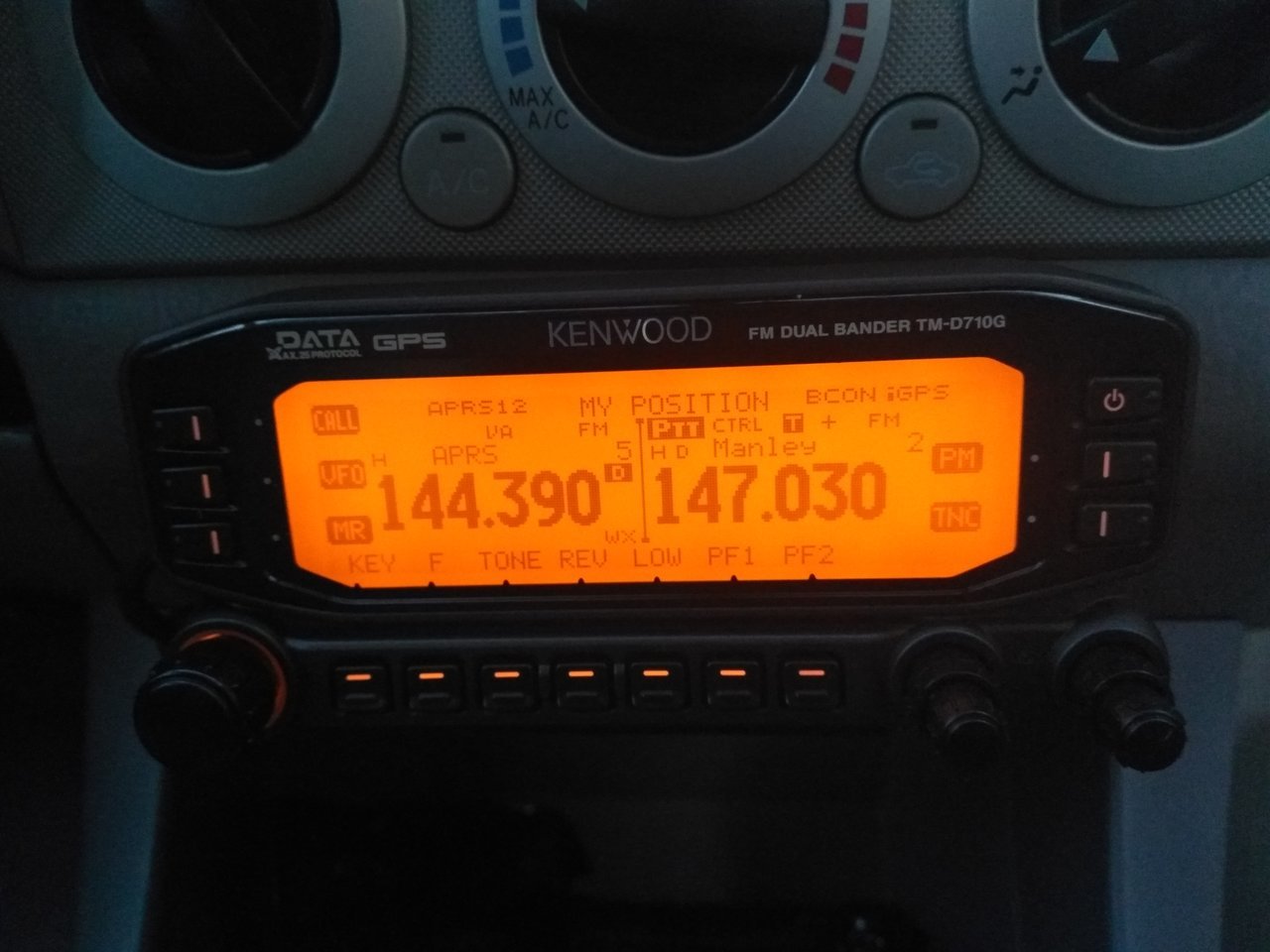

    For whatever reason I can't seem to get my APRS position to show up online at aprs.fi. I'm within range of several digipeaters and at least one igate and my radio receives beacons from them. I've received beacons from other mobile users that appear online. My radio says it is transmitting when set to beacon and the tax tone is turned on. I'm probably missing something dumb but I've read all the Kenwood stuff and watched a ton of YouTube videos on setting it up with no luck.

    It's the 710G, so built in GPS. It is turned on. Here's a pic of it showing GPS on, BCON on and the radio saying it just transmitted my location.

    I'm not completely familiar with this radio but I can try to help. if you are using smartbeacon, you may have to be moving for it to work properly. check menu # 612, is there a setting for path? for MY TNC I'm using WIDE1-1
    It might be called APRS path, digi path, packet path or just plain path.
    What is your callsign, I can try to send you APRS messages

    I have an idea after messing with it this morning. Even with squelch maxed out I frequently show "busy" on the APRS frequency and if I turn voice alert off there is static even when no packet transmissions are heard. If what I've read online is correct my radio won't beacon if it thinks the frequency is being used.
