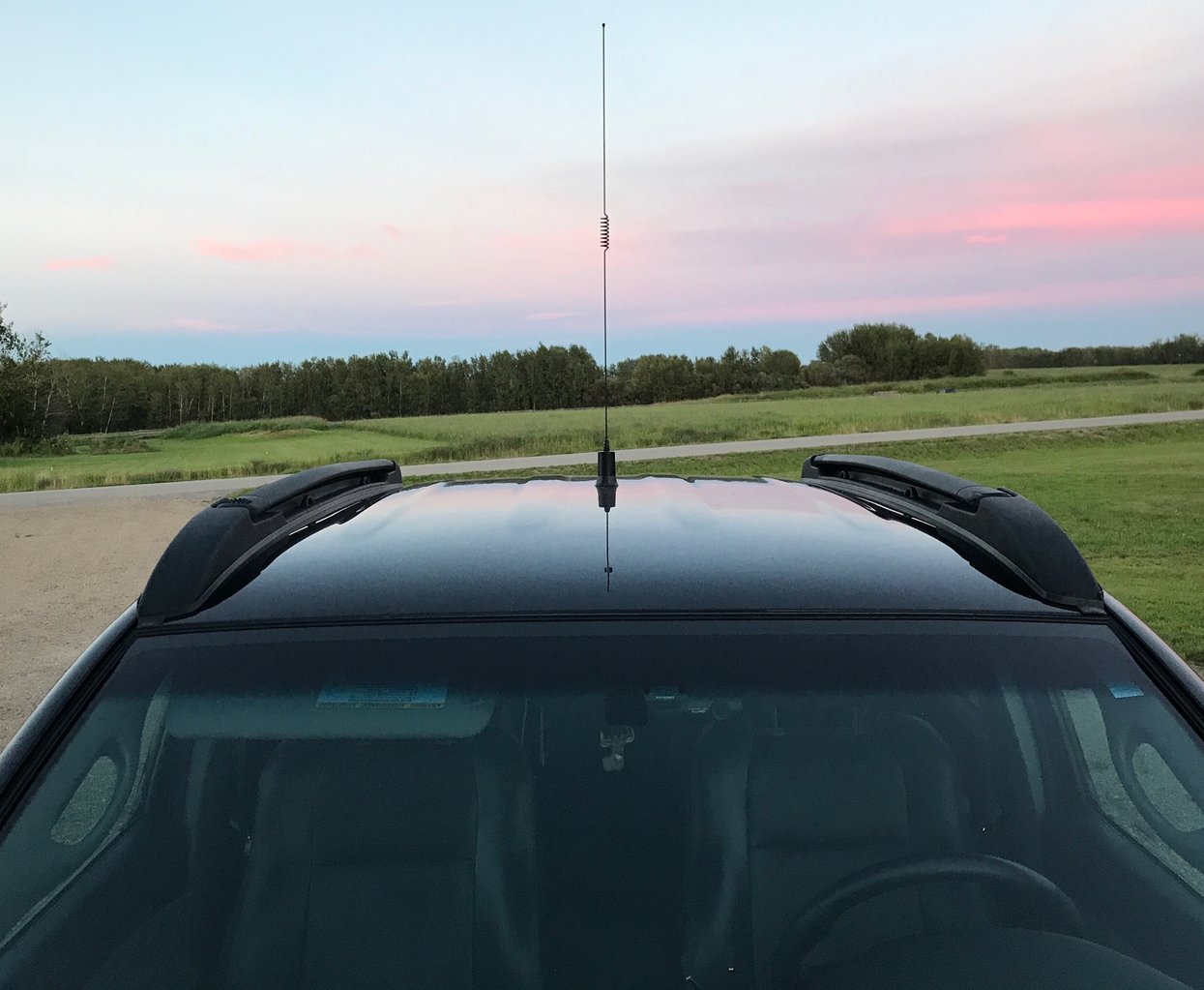

    Welcome! I would agree that cutting the hole is downright scary. You just aren't supposed to put a hole in your 35k truck. On the other hand, it's just sheet steel. Easily one of the best mods I've done so far.

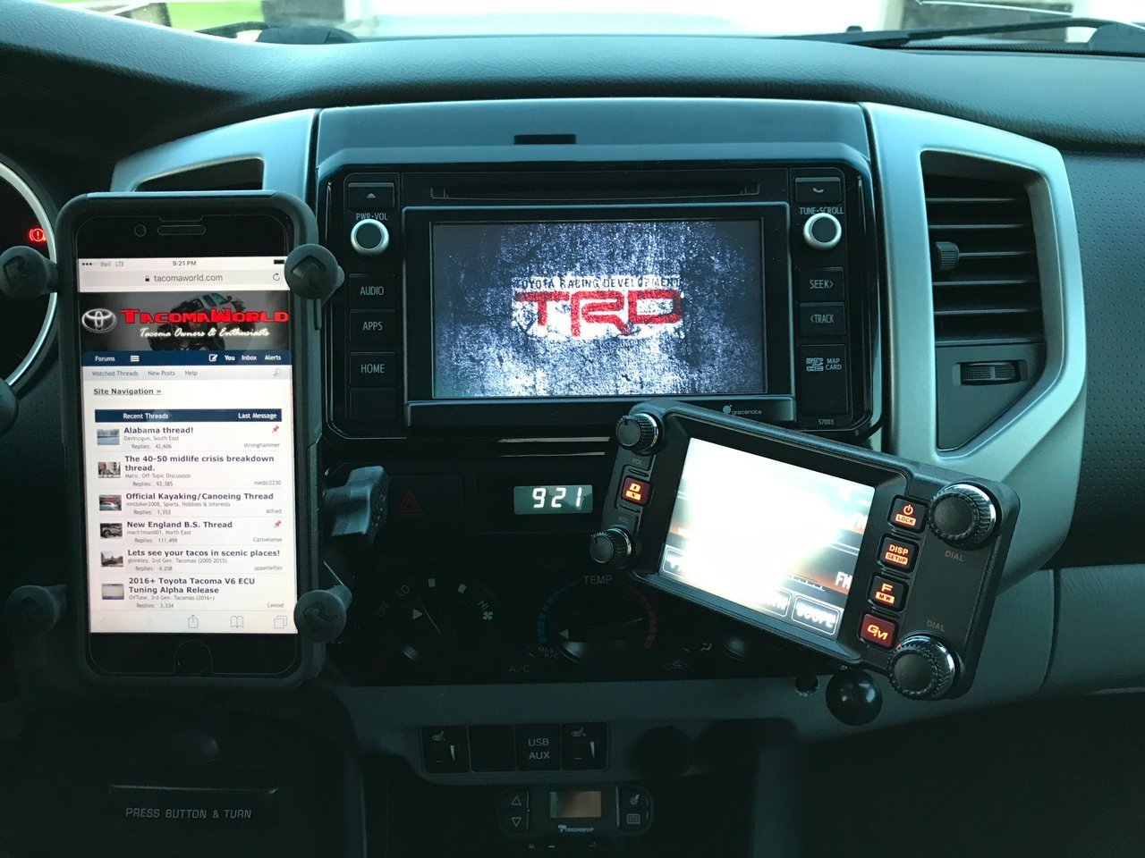

    My setup, could not be happier! The 400 looks cock-eyed in this pic, but it's straight from the drivers point of view.

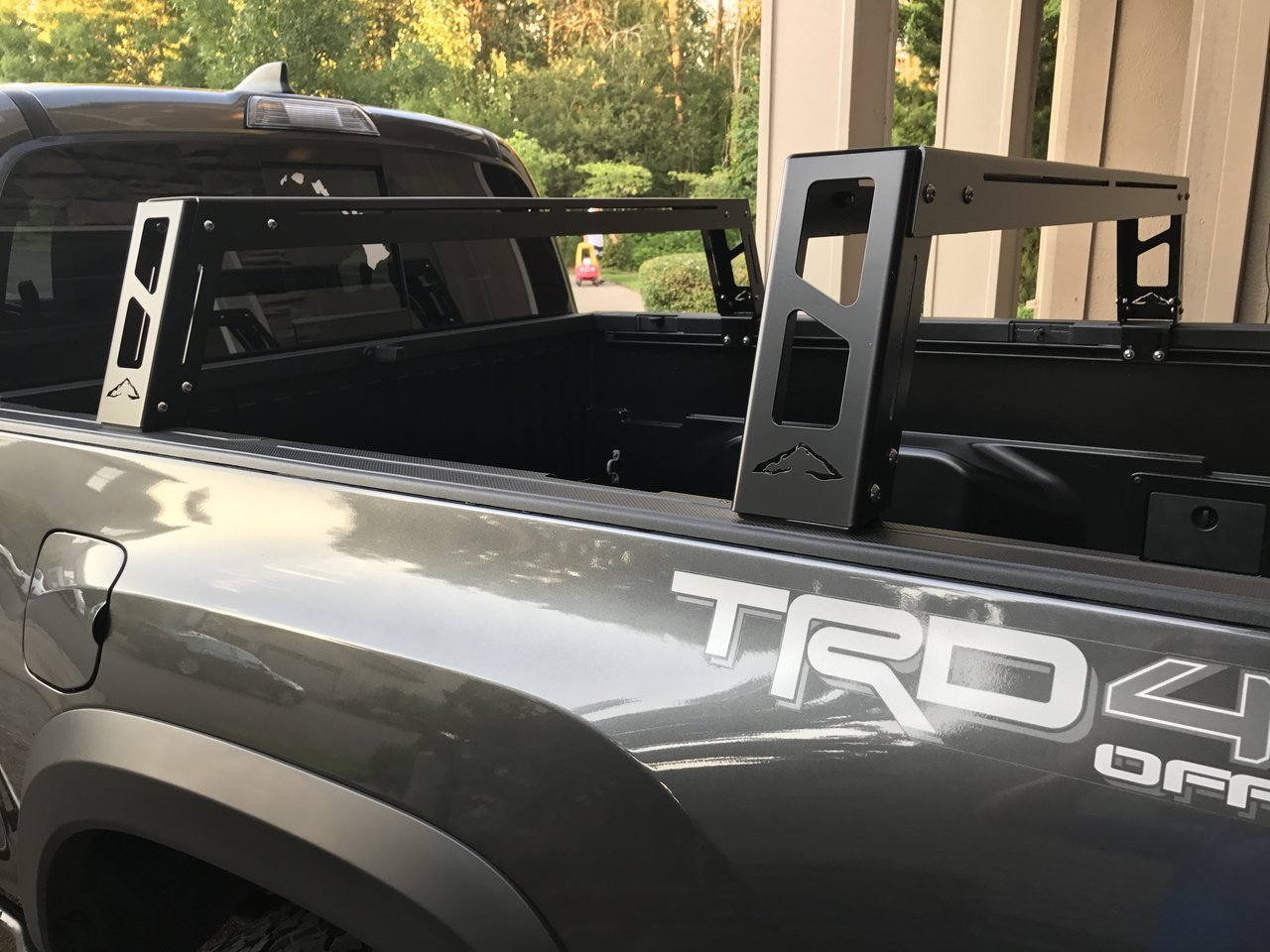

    How dumb would it be to try to mount a uhf/vhf/cb antenna to this? [​IMG]

    Not dumb at all. I would mount and then test it out.
    It is funny how somethings help and hurt. For me, with a tailgate mounted antenna, I can have my plate bumper and tire carrier OR my shell on and I have great signal. However, if I have both on... it is horrible.

    I am thinking of trying the wilson non magnetic roof mount kit, just have to find a way to make sure the rack is properly grounded, however, I am just unsure how its RF ground plane will actually be with just the metal rack and a plastic bed.

    Run a ground strap to the rack.

    Yeah, I'd probably do that, also I am a little worried because I've never seen anyone else use a roof mount in this manner. But I guess there is a first time for everything

    Someone did a roof mount on a pinsu rack, they put a piece 1ft square metal between the antenna and rack to make a better ground plane.

    That bedrack looks like an ideal ground plane. Slap a 5/8 magmaount on there (if it's steel. If not bolt a small steel plate up there) and you're golden.
