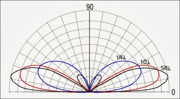

    Not sure which antenna you have for middle of nowhere, but I assume it's one of the longer ones. If so, the difference of course will be the effective radiated pattern. For the long explanation click here. Here is the short visual version see this diagram:
    You talking to helicopters or you in the bottom of a slot canyon? The 1/4 wave is best for that (radiating up). For talking across vast flat distances like the desert, the 5/8 wave will be best.

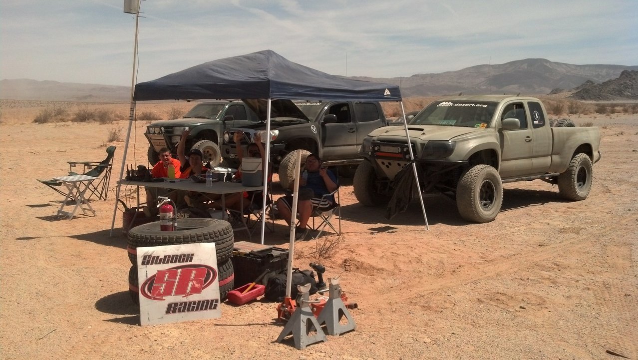

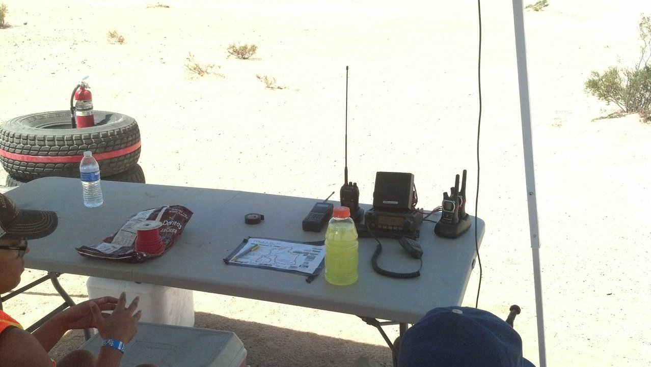

    So according to the Larsen catalog , when I stuck my 5/8 wave on my mag mount which was then mounted on a empty paint can attacehed to a broom stick was a bad idea. Instead I should have used a 1/2 wave antenna :facepalm:
    You can see part of it here attached to the Ez up canopy
    My mobile base station for desert racing. for remote pit areas :cool:

    ^ Very nice setup. Nice and organized, looks good. :)
