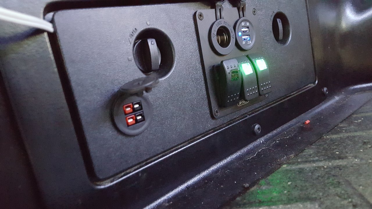

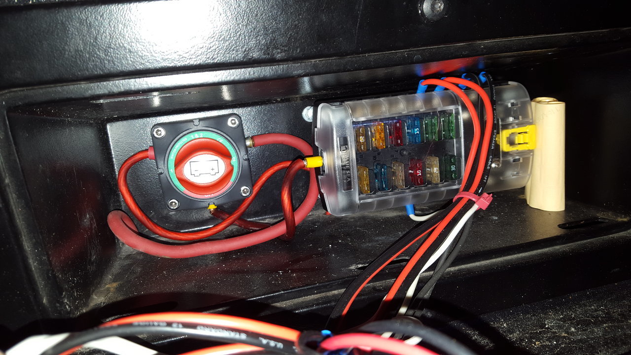

    Yea... You're going to have to open that up and show us what's going on under that cover.

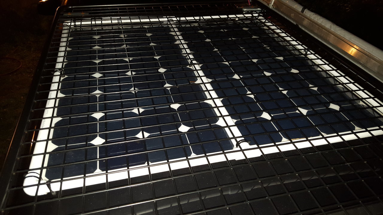

    pickup truck
    Blue sea fuse panel, A/B battery switch. Switches are for the USB charger and bed LED lights. 200w of solar panels on the roof rack charge 2 Trojan T-105s in the bed (225ah). It all runs an edgestar fridge in the back 24/7, plus occasional inverter stuff. I put the A/B switch in to switch to truck power for long trips. An IOTA 55amp IQ4 power converter is inside as well in case there's no sun at campgrounds.
