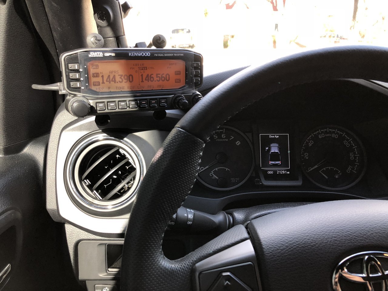

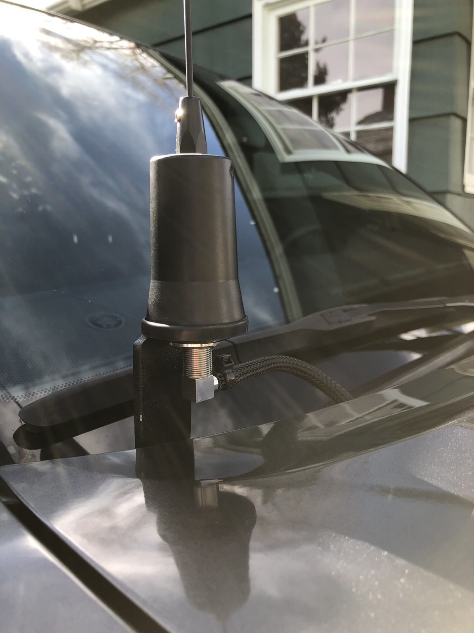

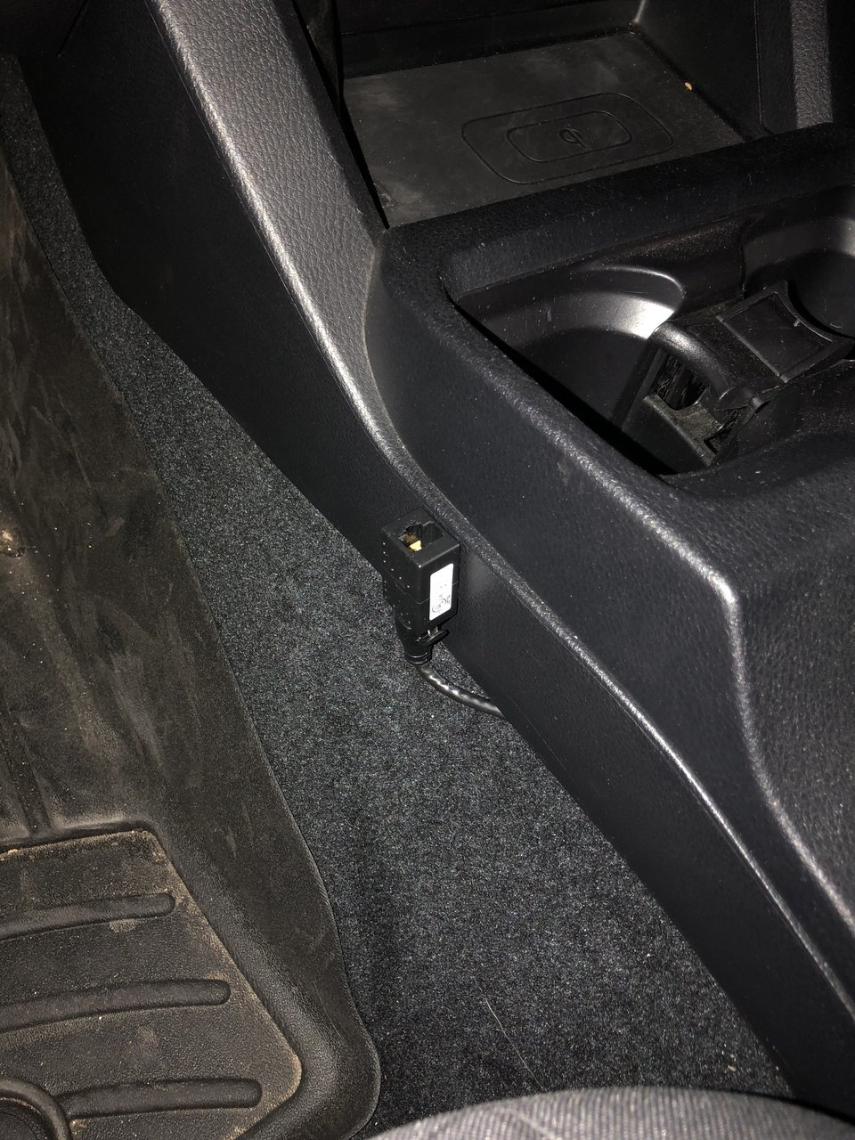

    Here’s my setup I installed a couple weeks ago.
    Kenwood TM-D710GA
    Larsen NMO mount
    Larsen 2/70 NMO antenna
    Relentless Fabrication hood mount
    I’m really liking the Kenwood so far. It’s so easy to use and program and only took a few minutes to get the hang of the menu system. The APRS works great too.
    The radio body is mounted under the driver seat. Faceplate is on a custom ram mount. I used a grommet under the driver seat to run the antenna cable and power. I used braided loom on all the cabling. I used a 3’ piece of cat6 and a coupler double sided taped to the center console for a microphone extension.
