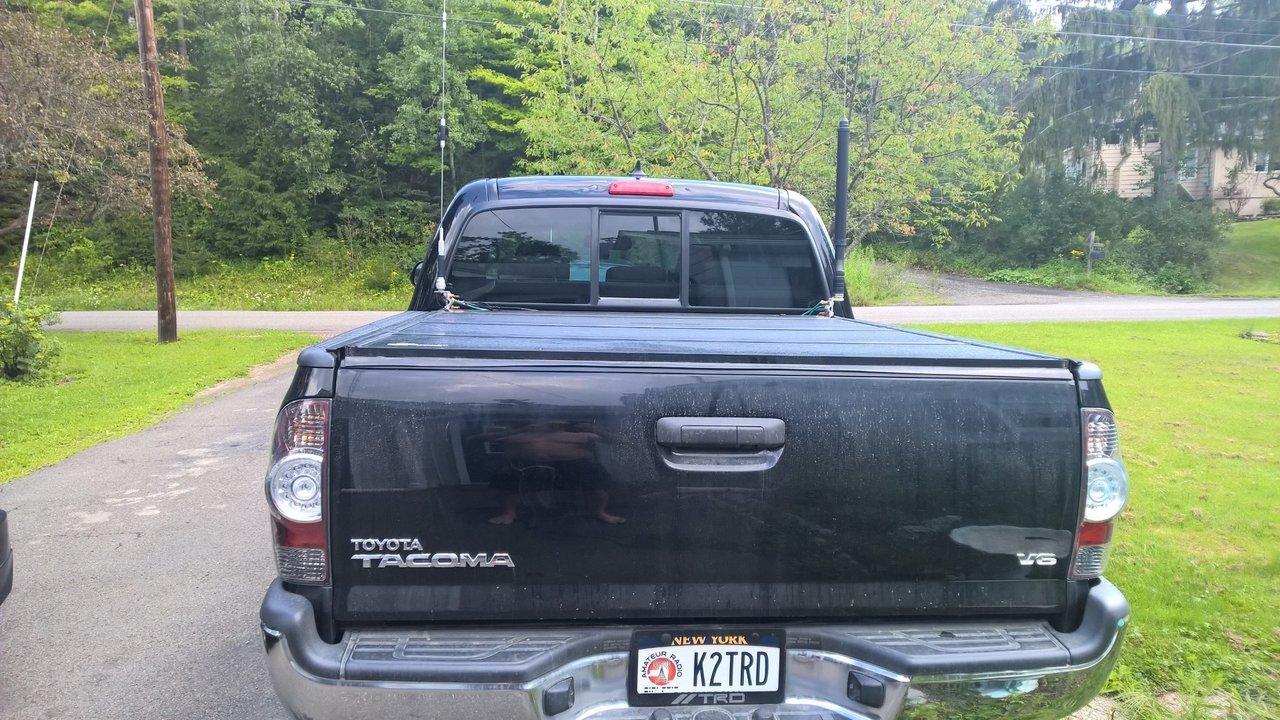

    Why did you decide to drill your roof for antennae ?
    I’ve got a AluCab aluminum canopy - how would recommend mounting a dual band antennae to canopy ?
    I was thinking about mounting antennae on canopy, putting the radio in the canopy somewhere and running CAT wire to the cab for the head unit ..

    I mounted it there because it's the most ideal location according to folks that know a whole lot more than I do. ;)
    And propagation is excellent, so they seem to be correct.
    Regarding the Al topper. I've read non-ferrous metals make a poor ground plane. But to combat being (if) it's your only mounting alternative a square piece of steel sheet can be affixed to the topper and the antenna directly mounted to that. I've seen 1/8" sheet from 1'x1' to 3'x3' to be recommended.
    But that's only what I've read. I haven't any direct experience with it.
    I'm sure someone else will chip in.

    If your topper is aluminium and you put a plane steel sheet next to it you are risking galvanic corrosion. I would recommend a stainless steel sheet instead, you can get that in the ferrous variety if you like.

    Do you think you could get the same effect from mounting and antenna to a steel bed bar near the cab so it isn't partially blocked by the cab itself? Not too keen on drilling holes in my room just yet either.

    I'm not sure I know what you mean by bed bar. Generally, you want it as high as possible with the biggest ground plane as possible. BUT there is going to be a point of diminishing returns where going through the effort and expense just isn't worth the time. At a certain point, it's going to work "good enough". How good is "good enough"? That's up to you and your wallet.

    I ran this setup for a few years. Worked fine for what I was doing, had great range, just make sure that everything has a good ground (antenna to bar, bar to truck bed).

    You could also consider a no ground plane antennna like the Diamond 770. I run mine off of tailgate mount with good results (although I would like to hook to an SWR meter just to see what it runs)

    Bad description on my part. I meant the kind of bars you might attach an RTT to.
    Good to hear. You think there's be any difference in signal strength between this and the tailgate mount that demo243 is doing? I'm just trying to get this done effectively the first time so I don't have to try and mess with it later on down the road.

    I ran a bar mount for 2 years and then went to a tailgate mount when I added my shell. I didn't notice any difference for my Diamond 770 between those two.

    I have my mounted behind the cab can reach 40 to 50 miles no problem. All mountain and Hill here in upstate New York.
