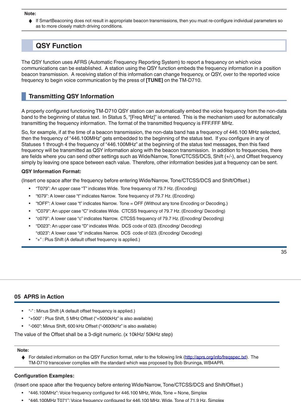

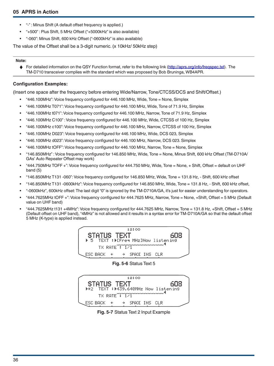

    So I played around with it some more and got it to work exactly as I wanted (showing frequency and tone/shift info automatically). You use status text 5 and leave it completely blank. Then you just have to turn the tx rate to anything other than off. I believe the different values determine how often the status text is included with your beacon. I went with 1/1. Thank you so much for your help!

    How did you make that work? With a blank status 5 selected and 1/1 transmit rate mine just transmits the plain frequency for the repeater programmed in VFO B.

    There’s another menu option in the APRS menus, maybe called something like “QSY”? In that menu make sure all three suboptions are turned on. That’s all I can think of. Sorry I can’t give you the exact menu name or number right now, I’ve been drinking and I’m away from my truck too.

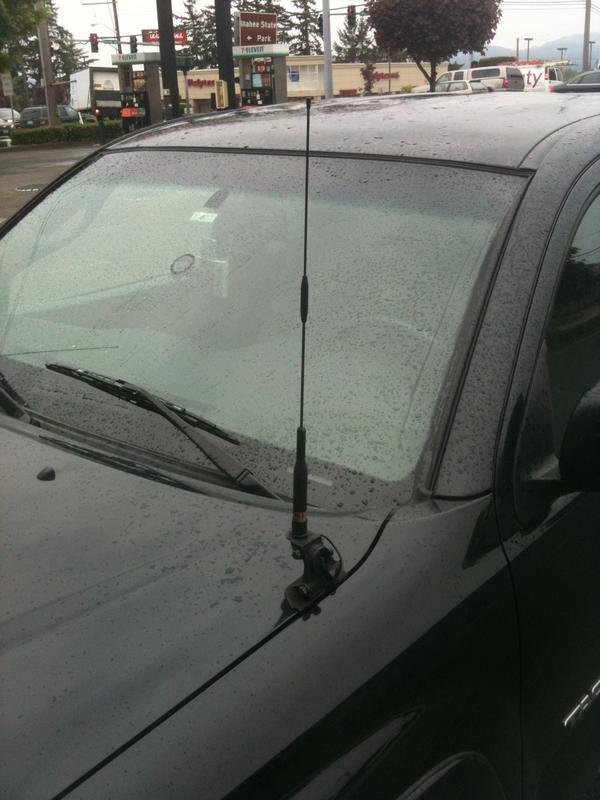

    How would an antenna mounted at the hood like this compare to the mag mount on the roof? (Anyone know what this model might be?)

    That looks a lot like the comet ss-680sb nmo antenna that I’m using. I have mine located in basically the same place as the photo too.

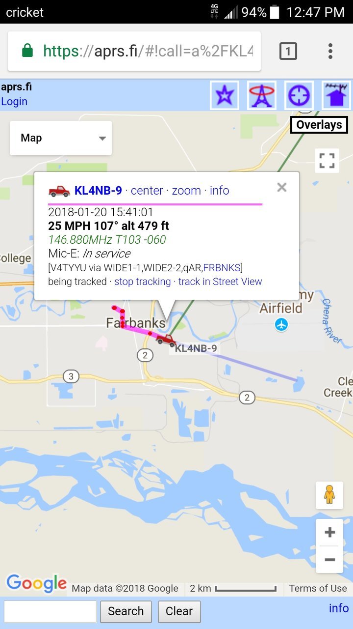

    As an update to my response the other night, the menu I was talking about it menu 632 “QSY (FREQUENCY)”. Try turning all three of those sub options on. See attached screen shot for how my status looks on aprs.fi
