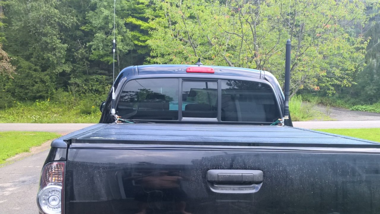

    wp_ss_20180515_0003.jpg comet 790A

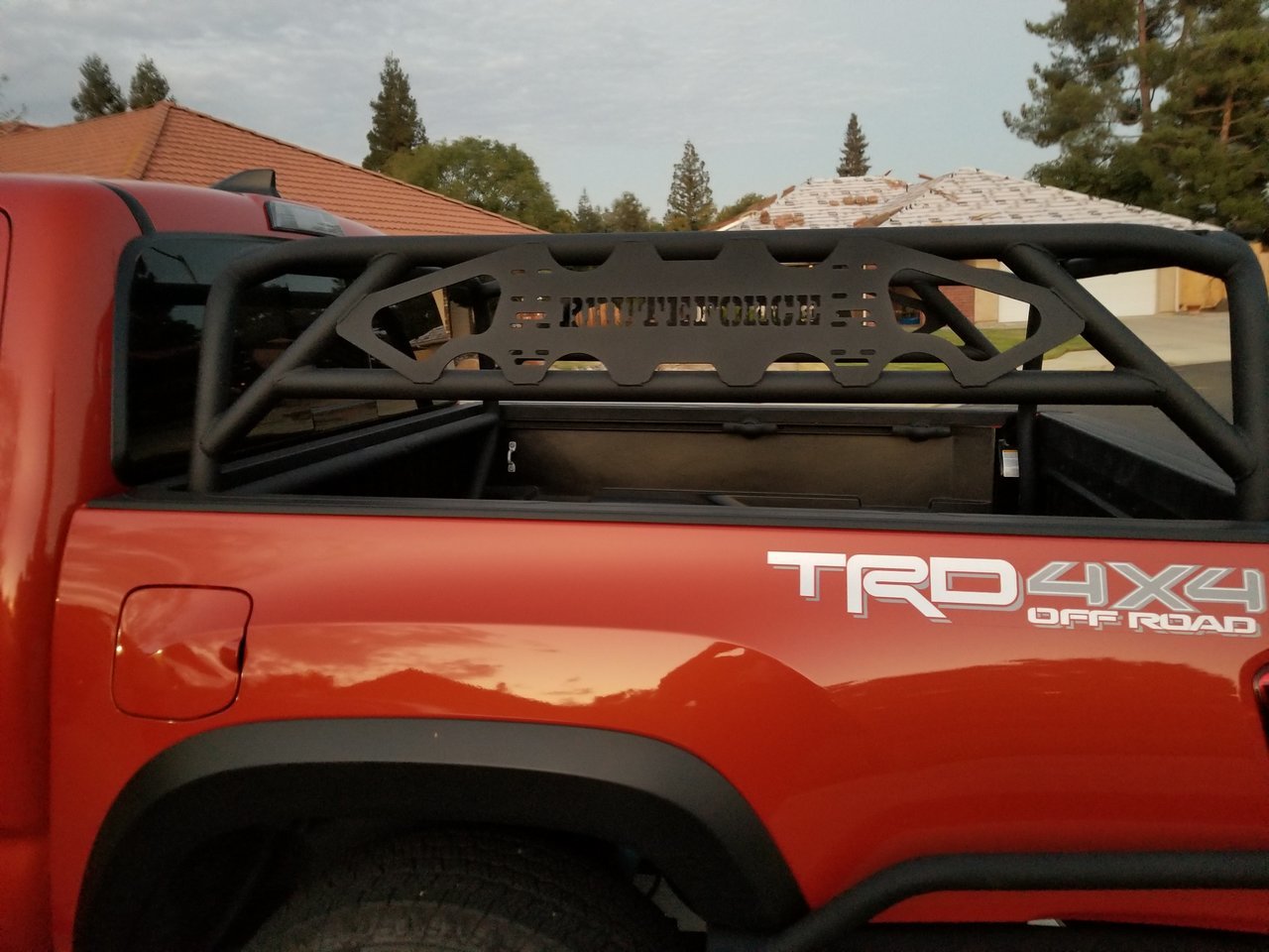

    I'm wanting to mount it to the cage. Its attached to the bed bolts and to the frame. I'll make sure I get the powder coat off the areas that need to be grounded. Do you think it would be an ok location. I'm wanting to mount it on the drivers side of the cage.

    I'd bet that works fine for VHF / UHF.
