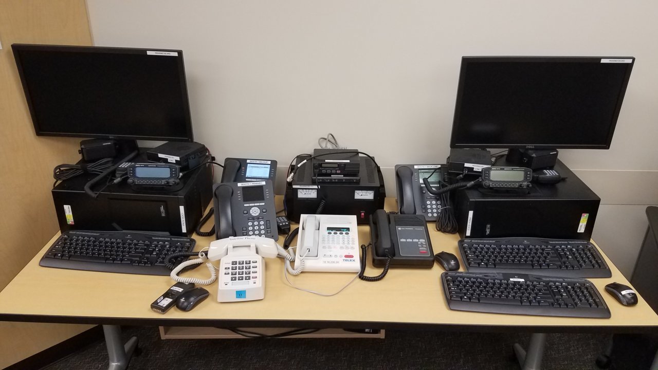

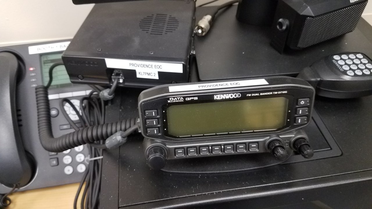

    As part of my work I have access to the emergency operations center at one of the local hospitals. I was happy to see some ham radios setup ready to go.
    After the 1964 earthquake ham radio is what got a lot of needed supplies up to Alaska.

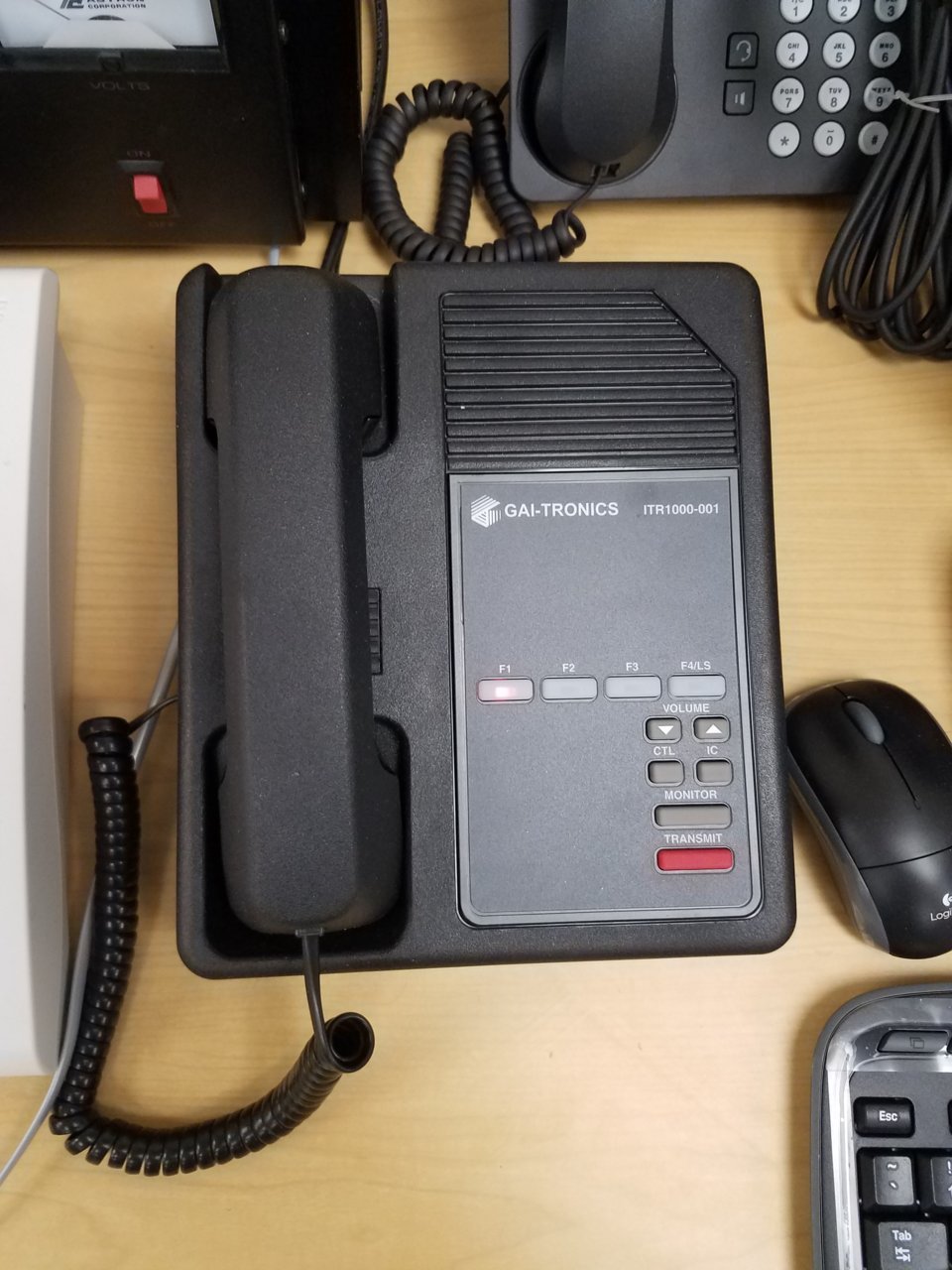

    Is that a gai-tronics tone remote in the lower right? They have a variety of tone remotes, some quite sophisticated. I was trying to figure out if I can hack a different model (I forget the model #) to operate a TM-D710G. I want to look at their line, I think they also have one that will control multiple RF Chassis. So you could build a "dual band" tone remote for 2m / 70cm.
    Our local EOC requires a 500+ ft run of coax to the antennas. The guy that designed the station didn't do any math on coax loss, lol. Squirting 50w at the EOC results < 1w out at the antenna. Transmit is not terrible, but receive RSSI is awful.
    I proposed using tone remotes on commercial radios. I was told that is a terrible option for hams because commercial radios lack VFO mode. While I agree it's less then ideal, well thought out programming will resolve most issues.
    Instead we're dealing with -110dbm signal strength of the primary repeater in the county and lack the ability to make the repeaters of any neighboring county. I'd gladly give up VFO mode to have a strong signal into pre-programmed radios.

    This guy?

    Yes. I have some experience with CPI tone remotes. One of our customers just installed a gai-tronics remote. But I didn't do the install. I'm interested to learn more about them. The one that I saw had an LCD and needed programming.

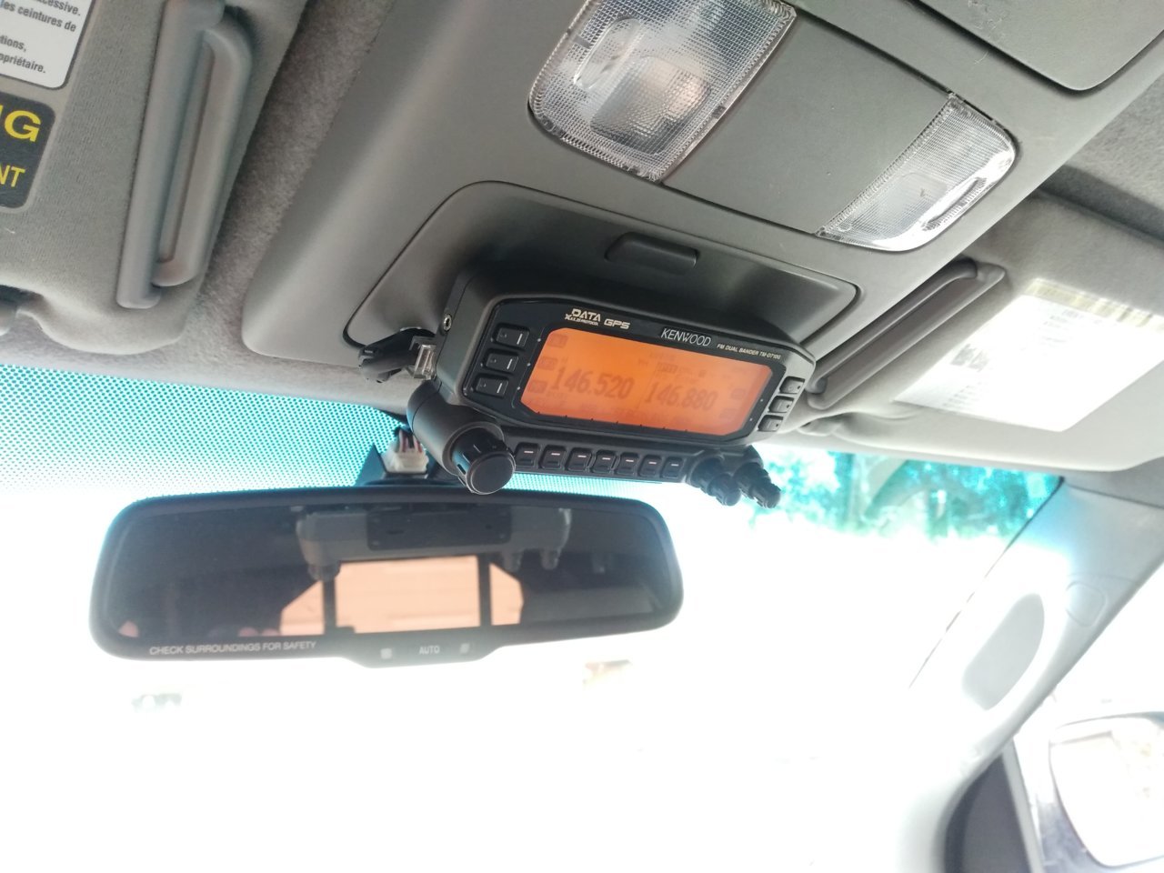

    I redid my mounting setup for my 710G. I originally put it down in front of the shifter but the angle made it hard to see. The screen is best when it's angled towards you but in that spot it was facing straight towards the center console and level with the truck. When it was bright out I'd have to lean over to get a good look at the screen.
    When I get more time I want to move the compass to the useless sunglass holder position and recess the radio in the front position.

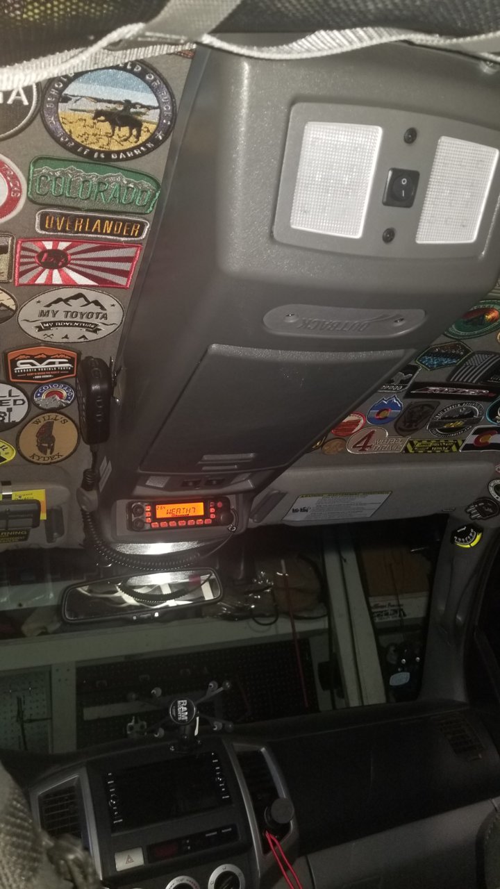

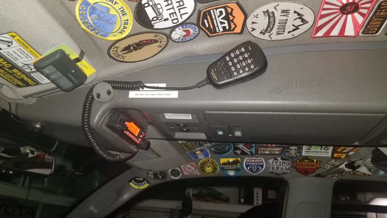

    Just get an Outback center console. Much easier. :D Now getting one to the US can be fun.

    Do you have details on that console? I so want to put one in my truck. I assume that's from a Hilux or Prado and has been customized for the Tacoma ceiling shape?

    Dave start here.
    https://www.4wdinteriors.com
    Look for the 2005 + model number for a Hilux. It will fit closer then what I did here. I used a model meant for an FJ Cruiser. I had to contour the top to match my headliner better and completely redo the brackets for attachment. I have been told the Hilux model number needs much less work to get it to fit. Once you find that model number, call David up at Toytec x103 and see if he can order it through ARB.

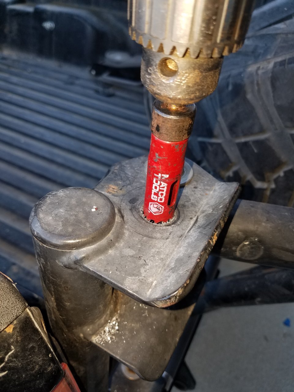

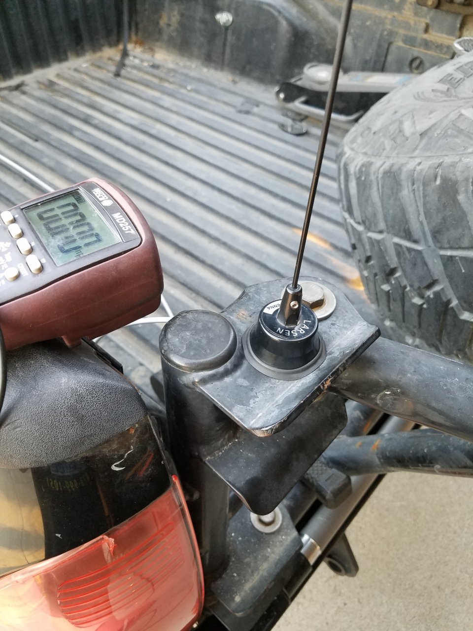

    The antenna farm on the roof looking really nerdy, 2 perm. mounted antennas and 1 mag mounted. Something needed to be done. Made a perminant home for the scanner antenna on the ultra mega expensive Wilco Spare Tire Gate. Since the antenna is receive only, achieving proper ground plane isnt neccessay..
    Beeps on the voltmeter thingy, continuity good, good to go..
    Semi prebuilt coax by Laird, need to solder the proper connector at the radio side. 17' of teflon coated, tis the reason why its white. Teflon coating makes it easy for pulling through tight spaces.
