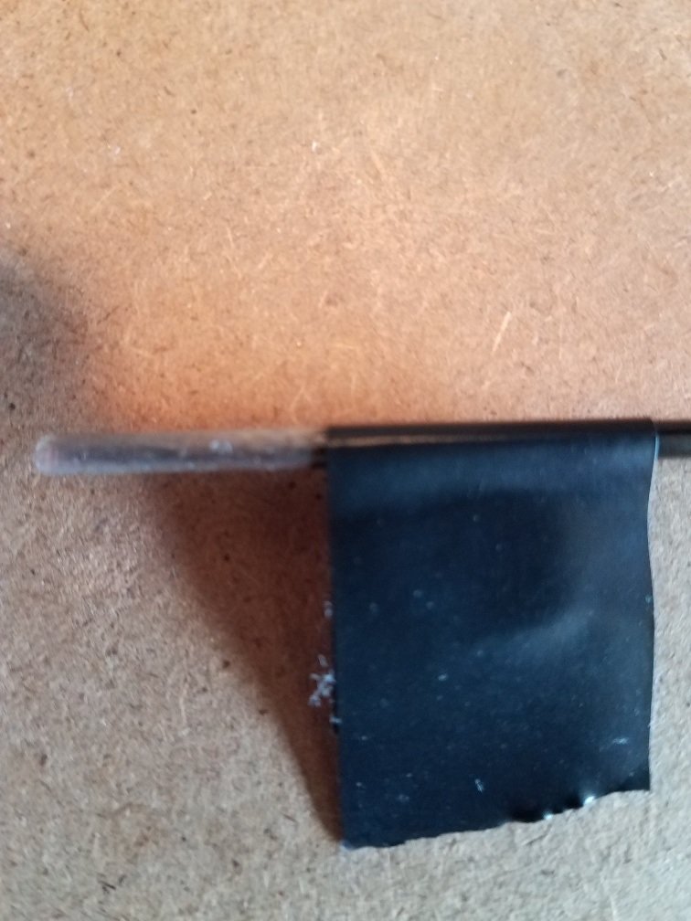

    One quick thing about black colored antennas. Most of them are painted black from top to bottom. That prevents good conductivity between the antenna rod and the mount/base that the rod is inserted in to. The electrical connection for the base and antenna rod is usually a scratch in the paint created by the set screw or screws that hold the rod to the base.
    To improve the electrical connection between antenna rod and its base, I loosen the set screw(s) and pull out the rod. I use a piece of electrical tape wrapped around the rod to mark where the rod stops when inserted into its base mount. This preserves the factory tuning, especially with dual band antennas. This isn't necessary if you plan on cutting / trimming the antenna. I remove the black paint from the portion of the rod that slides down into the base. I reinsert the antenna rod into its mount/base and tighten the set screw(s). I have noticed an improvement in SWR with several of the antennas that I did this to.

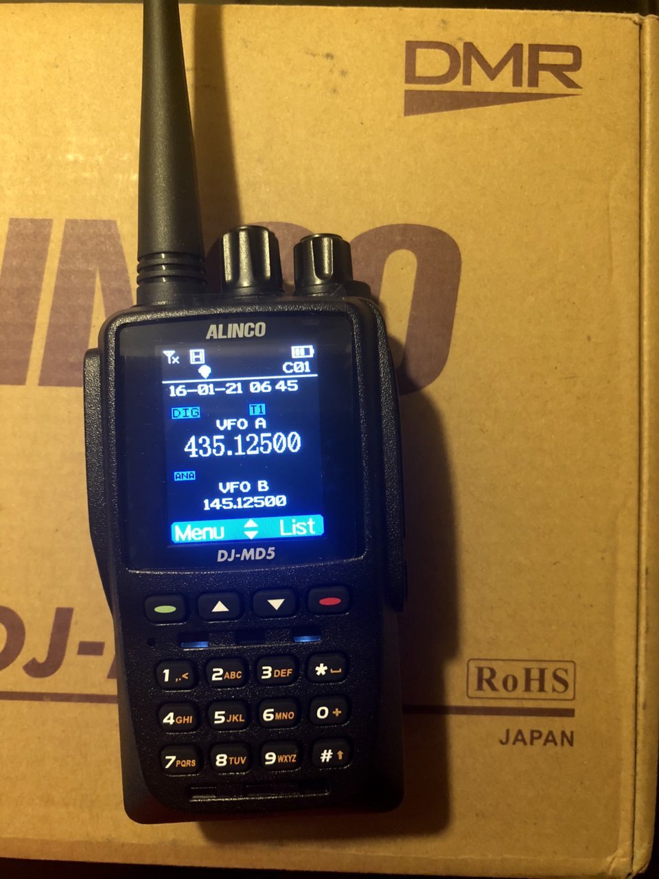

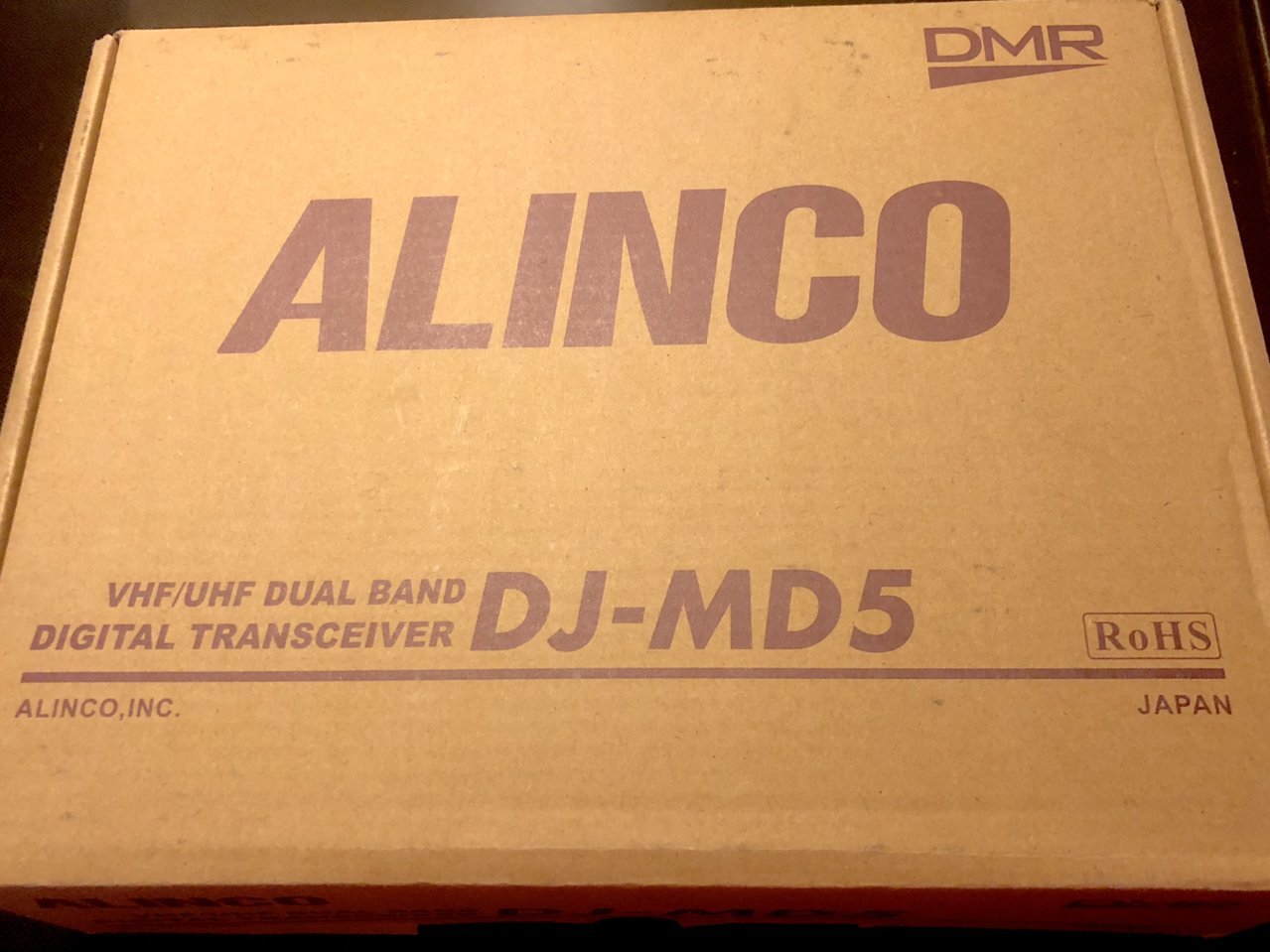

    New HT came today. :woot:
    So far looks and feel are awesome! The screen is outstanding on this one. Got it charging to program it up in a bit.
