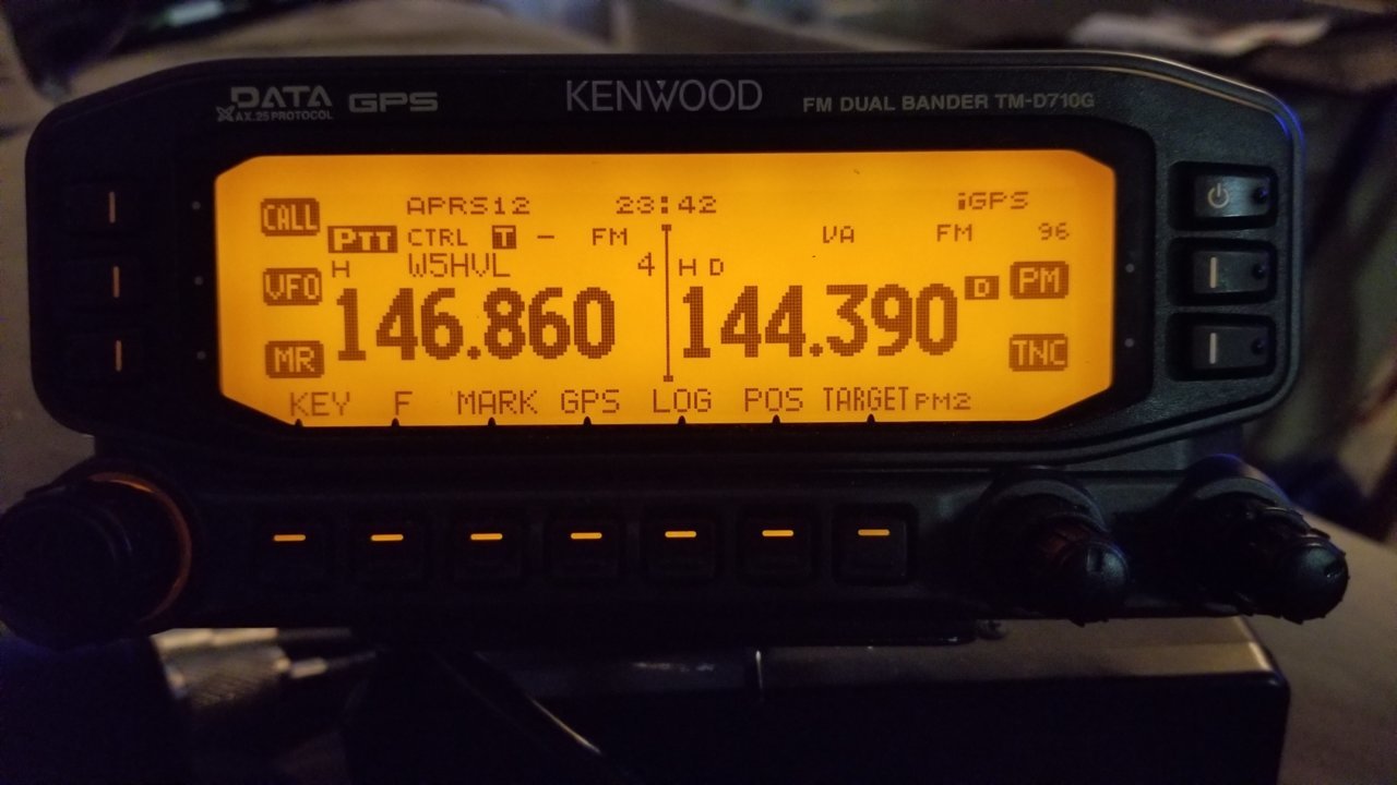

    My bad, I was looking at the D74. Let me look at the D710

    Looks like GPS isn't on. Hit the Key button until you see GPS along the bottom and hit it to turn on.

    You'll see the GPS icon in the top right corner.

    That's weird. It was there earlier.
    What's the difference between when it's solid or when it's blinking on the GPS icon?
    Sorry I just got this installed 2 days ago and still learning it.

    Solid while searching for satellites, blinking when active.

    Yeah earlier it was solid but never went to blinking. Maybe I need to move it around a bit. I would think it should be getting the satellites right there.
    Just checked and there is a digipeater within range so I should be hitting it. It's at 320 ft and showing people further away than me.

    It's slow to acquire. Takes a few minutes.

    It takes average 3-5 minutes for the icon to start blinking at first start up with mine. A few weeks ago when in the San Bernardino Mtns near Big Bear I did not get a lock until I was almost at the bottom and pretty much in the out skirts of Johnson Valley. Once I had a lock there wasn't any issues with loosing connection for the rest of the day.

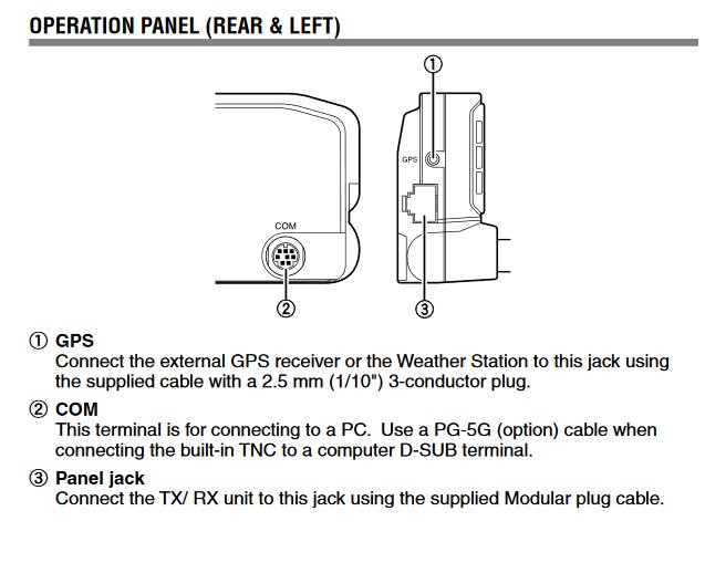

    edit: does anyone know of an external GPS puck/antenna that will work with the D710 ?

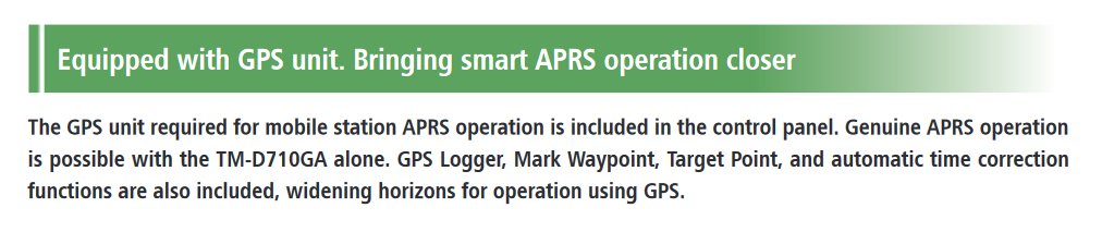

    @MonkeyProof
    Interesting piggyback GPS antenna.
    http://www.greenlightlabs.com/gps-710/
    Not sure where the internal GPS antenna is though.
    *** Edit ***
    Looks like its in the control panel so not sure how this piggyback gps antenna would work better.

    that was made for the first version of the D710 which did not have GPS, and it worked well from everything I've read about it. It's not offered for sale any more.
    My goal is to have an external antenna that will be able to mounted in a better location for faster satellite signal acquisition.

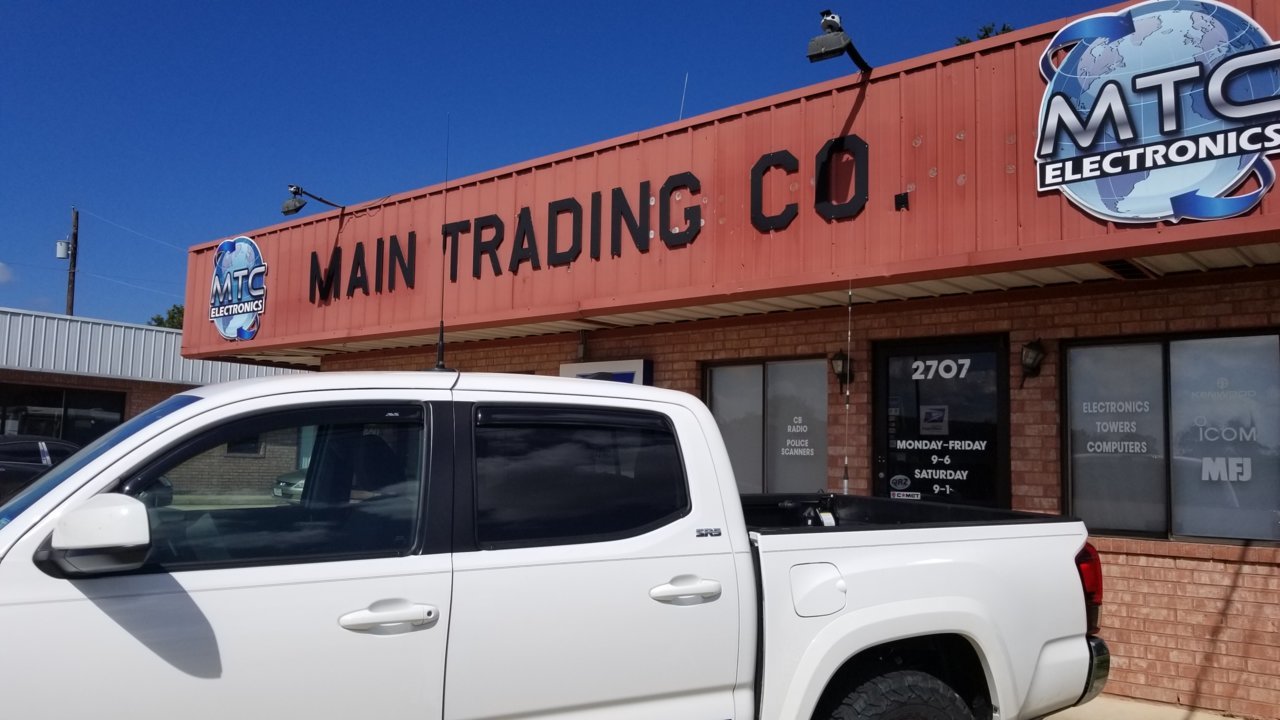

    On a road trip from Huntsville, TX to Van Buren, AR. Had to stop by MTC in Paris, TX. 20181005_121205.jpg
