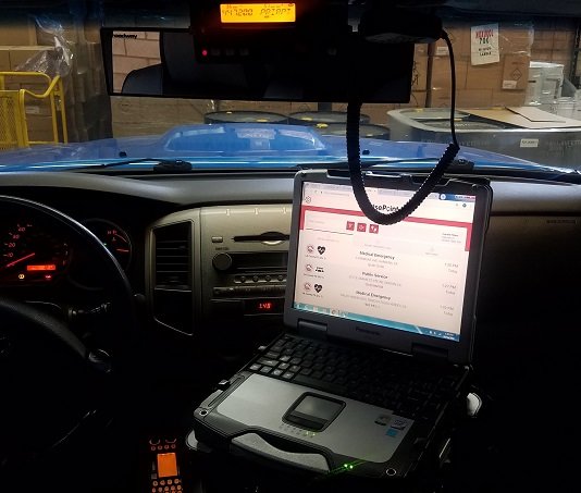

    Joined Los Angeles Fire Department ACS recently. Getting my Tacoma ready for any occasions. now with toughbook with internet connection. Yaesu FT8900, Toughbook, and Uniden Scanner...
