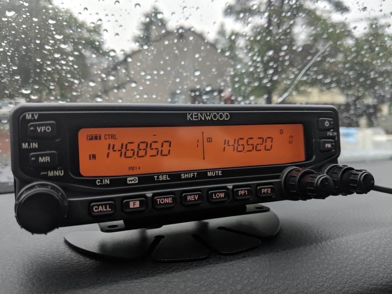

    I've got the Kenwood TM-V71A that's been brought up. Posted a few times in here. I've used almost all the features and have a ton of seat time and travel time with it. If you have any questions or want a ramble on it, just let me know. It's a great radio and a wonderful little brother to the d710 if that price range is too tall for someone
