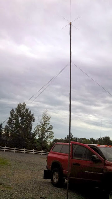

    I know projects can be fun and I don't want to dampen your exuberance, but I fail to see the point of using such a short mast on a mobile install. It's one thing if the mast extends your range by say 20-30 miles, but I would wager that it will probably do almost nothing for you and maybe even make things worse. If it were me I'd just mount that Larsen on the roof and call it good! All mobile installs are a series of compromises and you just have to make the best choices you can given the circumstances.
    Now, where masts make a lot of sense is in portable installs. Such as this one:
    Portable 2M mast to extend range.
    Portable 2M mast to extend range.[/QUOTE]
    Yes. And please note the radials.
