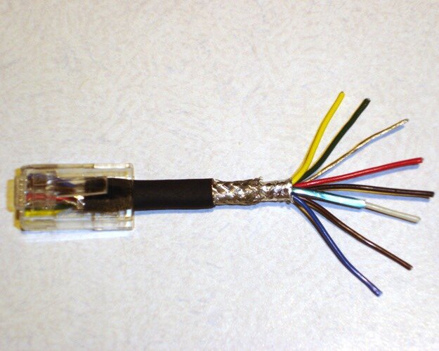

    Regarding Kenwood mic cables, if you look closely the mic audio line (pin 6) will be a tiny coax or shield conductor in genuine Kenwood cables with the shield soldered to pin 5 next to it. I don't know if their extension kit cable uses the same special type but I would assume that to be the case. If you cut the cable it looks like this, notice the blue foil around the white middle conductor of the coax.
    CAT 5 as a cable gave me terrible noise with DTMF microphones but was acceptable with a plain mic. It seems if there's any circuitry in the mic that has to communicate with the radio it can couple on the mic audio line.
    So it may be hit or miss whether your particular network cable, mic and radio will get interference. Generally speaking if you don't get noise it's probably because you're lucky or it may come on eventually as the conductors shift. Twisted pairs should be more immune, so if the cable you use isn't actually UTP and is unpaired plain flat or the wires selected for pinning out the connector didn't keep pins 5 and 6 grouped on a twisted pair it may not work from the very start.
    No amount of external shielding of whole cable or clamped on filters would make the noise go away, it was inside the cable for me.

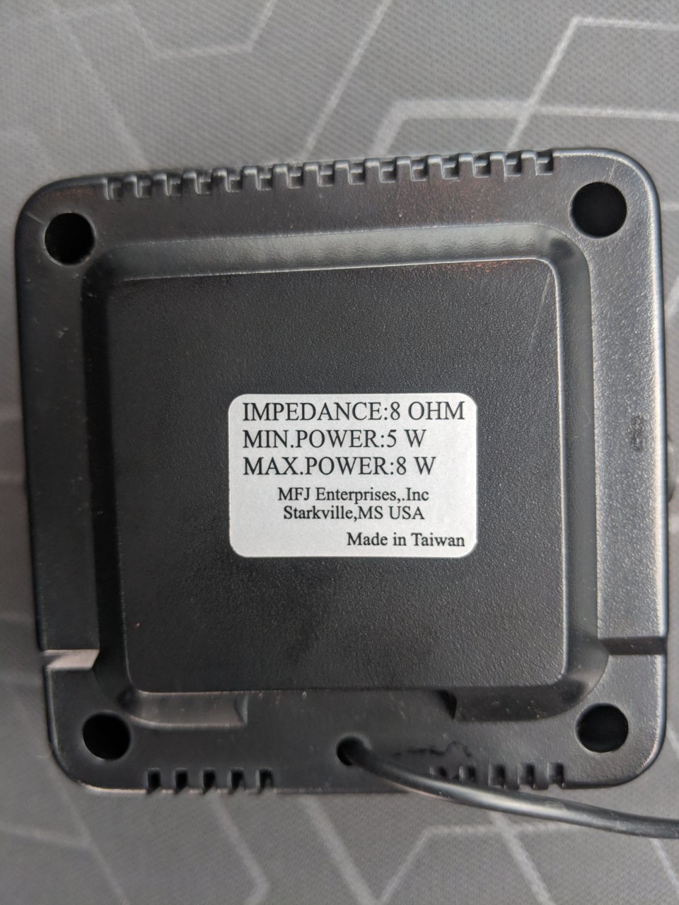

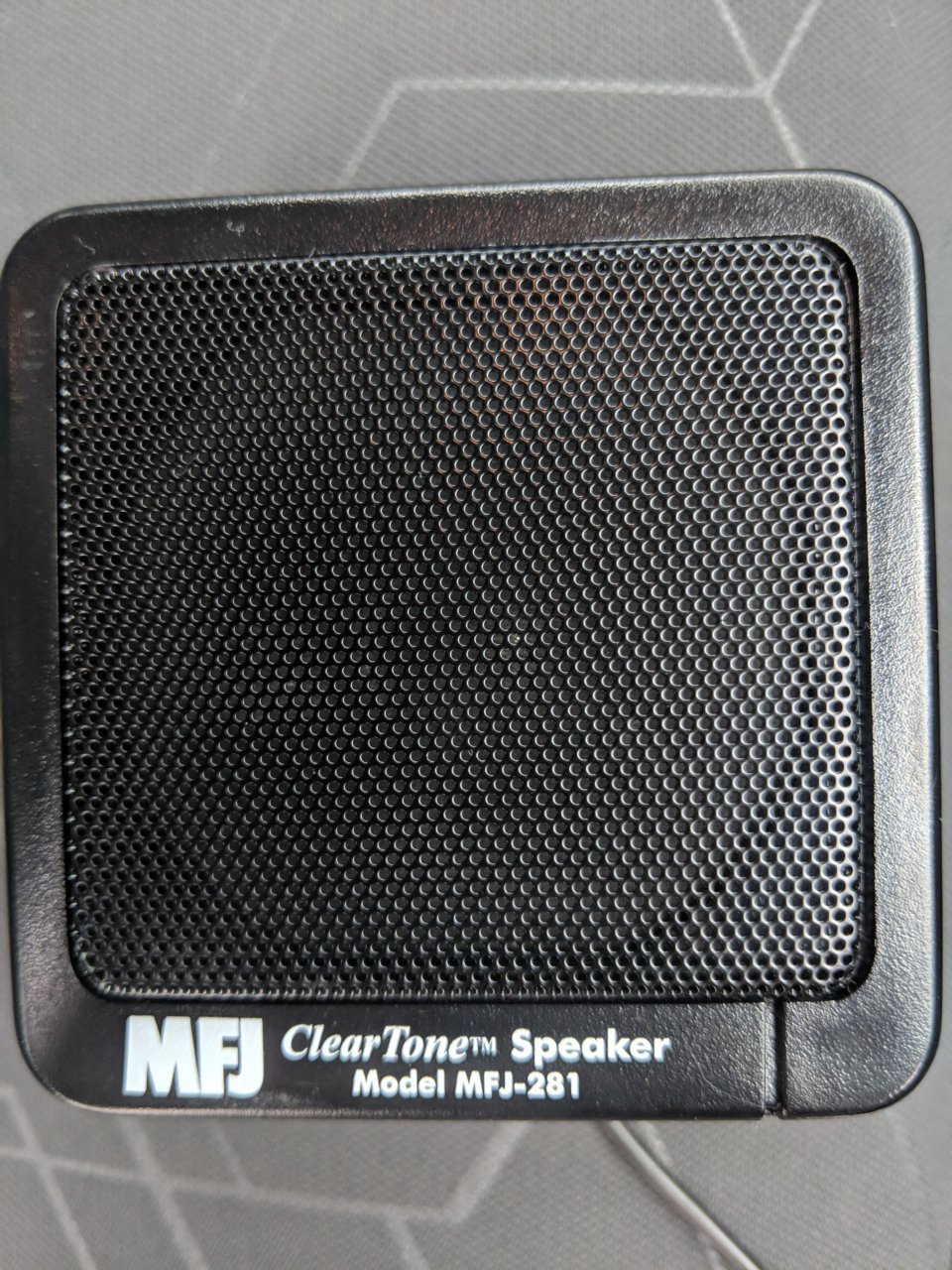

    I used this speaker: https://www.amazon.com/gp/product/B000ZIC18Q/ref=oh_aui_detailpage_o02_s00?ie=UTF8&psc=1
    Works great actually. Single speaker for both sides of the transceiver. I have mine mounted to the center console on the rear cup holders - It's a spare center console I picked up at a salvage yard so that I could cut holes in it for my CB install. Radio is mounted to a plate that is mounted under the driver's seat via the rear seat bolts. With the radio turned up all of the way, it was sometimes hard to hear the conversation when using only the factory speaker in the transceiver. One speaker is enough for me - both sides come through it. Typically turn down the second side anyway if there are two conversations going on. It wouldn't matter if I had 1, 2, or a dozen speakers as I can't keep up if both are rangling on... Who said what, etc...
    Face plate is mounted over rear view mirror to the plastic rear view mirror wire cable cover.
    Cat 5 cable is working for me. I did need an extension on the microphone cable - Cat 5 as well. I spliced in a separate PTT switch on the Cat 5 cable (in parallel) and used velcro to wrap the switch around the shifter (6 spd). Microphone is currently mounted to a cell phone mount that attaches to the CD player in the radio. Picks up my voice well but may 'extract' the actual microphone element from the handset in the future.

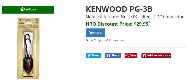

    Is this worth purchasing?
    I know with BaoFeng HT's I seem to occasionally get Alternator noise

    2 & 3: you can use commodity cat5 wiring and connectors, but you have to make the cables yourself. Don't buy premade Ethernet patch cables. Instead of standard pinout for Ethernet, you need to keep the pairs next to each other. I.e. pair 1&2, 3&4, 5&6, 7&8. So it's NOT like a patch cable. A patch cable will work, but the audio paths end up not twisted with a ground wire which can possibly cause interference to become introduced. Patch cables do work for some people, YMMV.
    I mounted the RF chassis behind the rear seat of my DCLB and ran my own wire extensions for both control head and mic. I believe the chassis gets better cooling there, then under the driver seat. #asstalk.
    The control head needs a 6p6c connector. I forget the pinout, I just copied the little short wire included when the head is attached to the RF chassis.

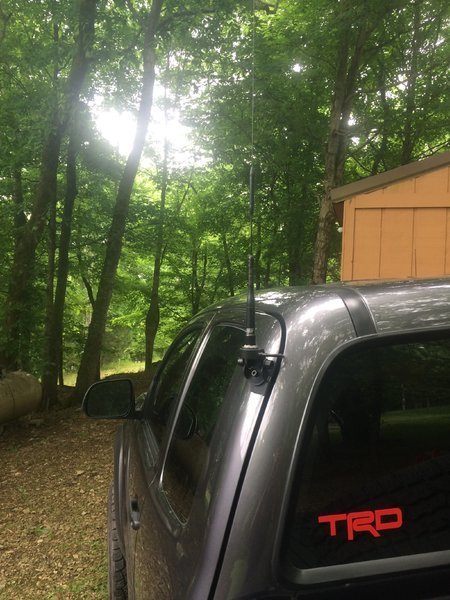

    I ran a mag mount antenna before drilling the roof. Ran it through the rear door and would get water inside on mine when it rained. May just be my door seal but it happened even when I moved it around some in the door seal. Roof NMO really isn’t bad and is waterproof. They make plugs for the hole if you ever remove it.
