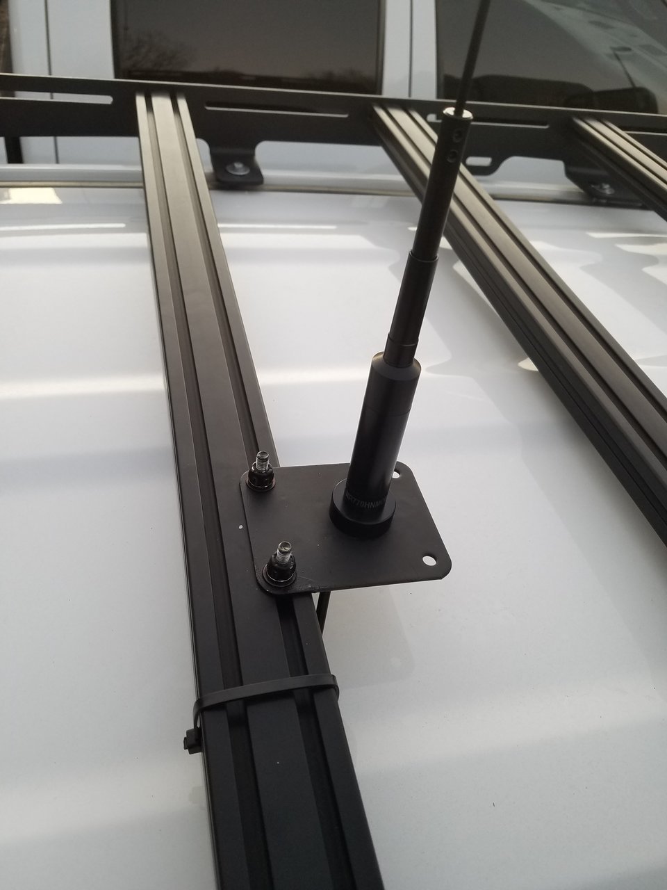

    I don't think they are in production yet.
    Adding to the idea pile: I used the backer plate from my ARB compressor to mount to my Prinsu.

    That's how mine is attached. I don't think it is ideal but I don't have access to any equipment to test it. There are some repeaters around that I think I should be able to reach but can't. Anything within about 8-10 miles seems to be fine and I'm able to hit APRS digipeaters that are up to about 30 miles away.
