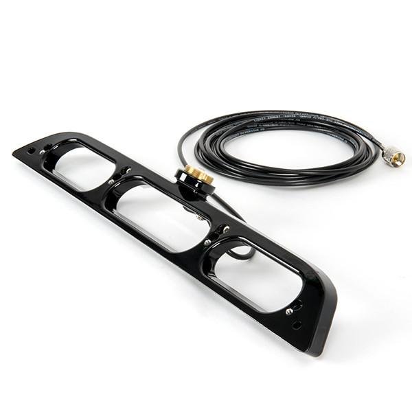

    Someone on tw was developing one. I was waiting for meso to do a BD 3rd brake light insert for the 2nd gens before i jumped on both.

    Not sure about the little side lights, but the BD S2s are not a problem. I have a bunch of BD stuff on mine, and I have yet to have an interference issue.

    Do you have it? Would like to see more than the single closeup pic on Instagram they have for Tacoma.

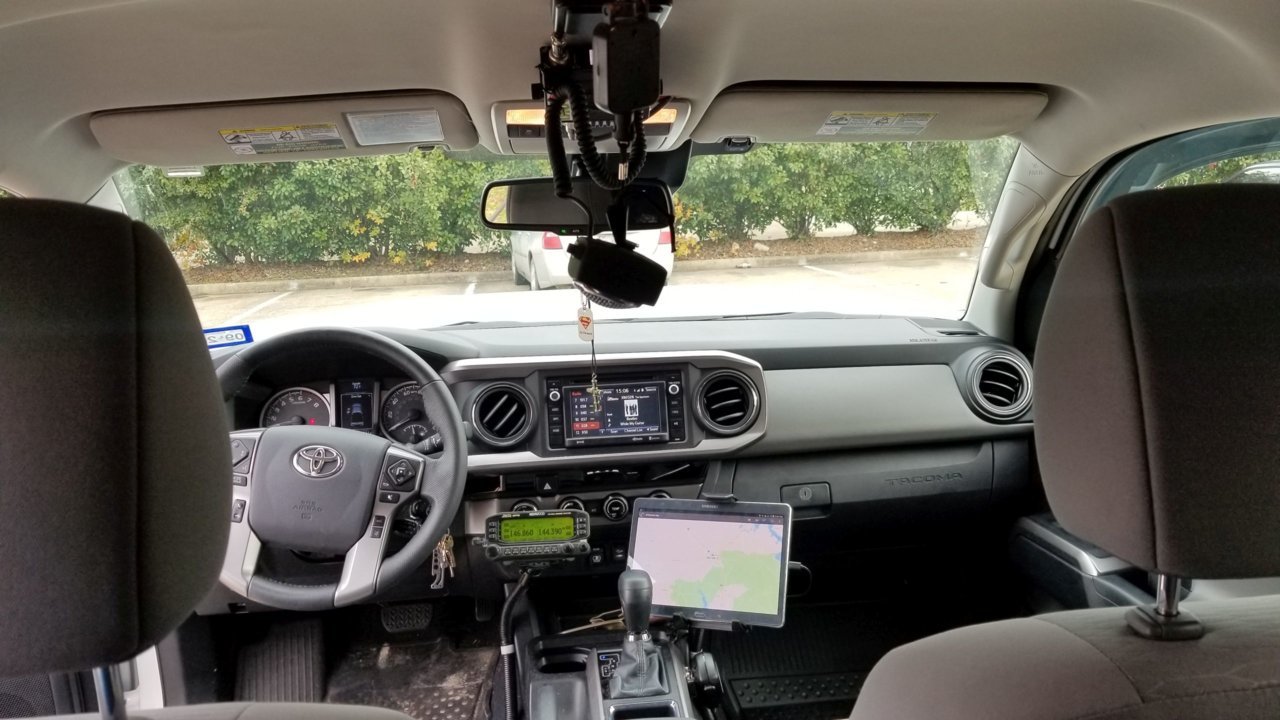

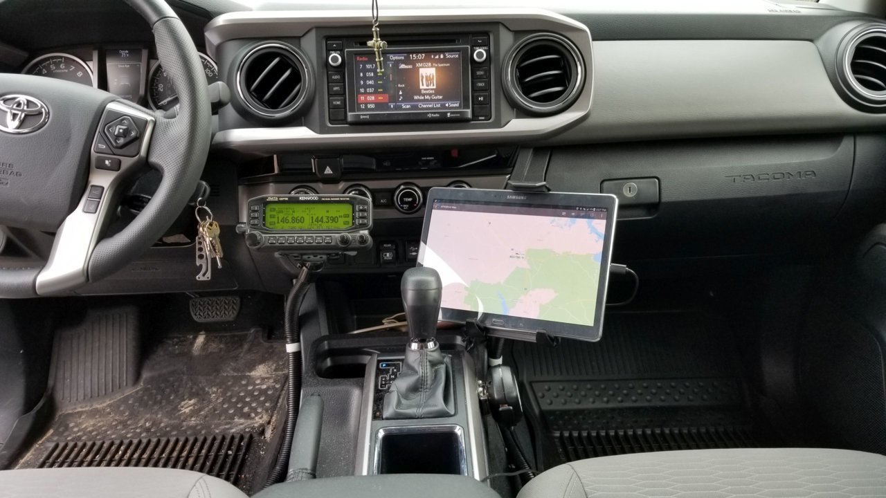

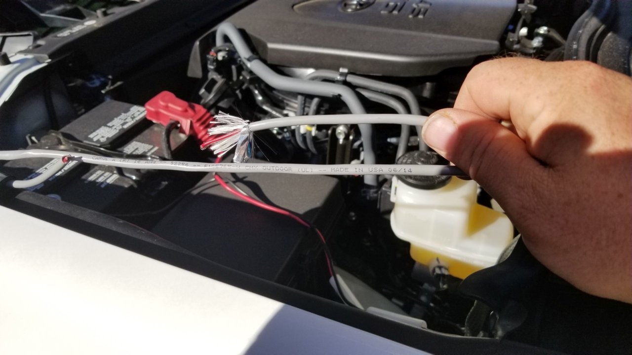

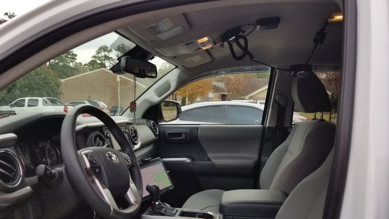

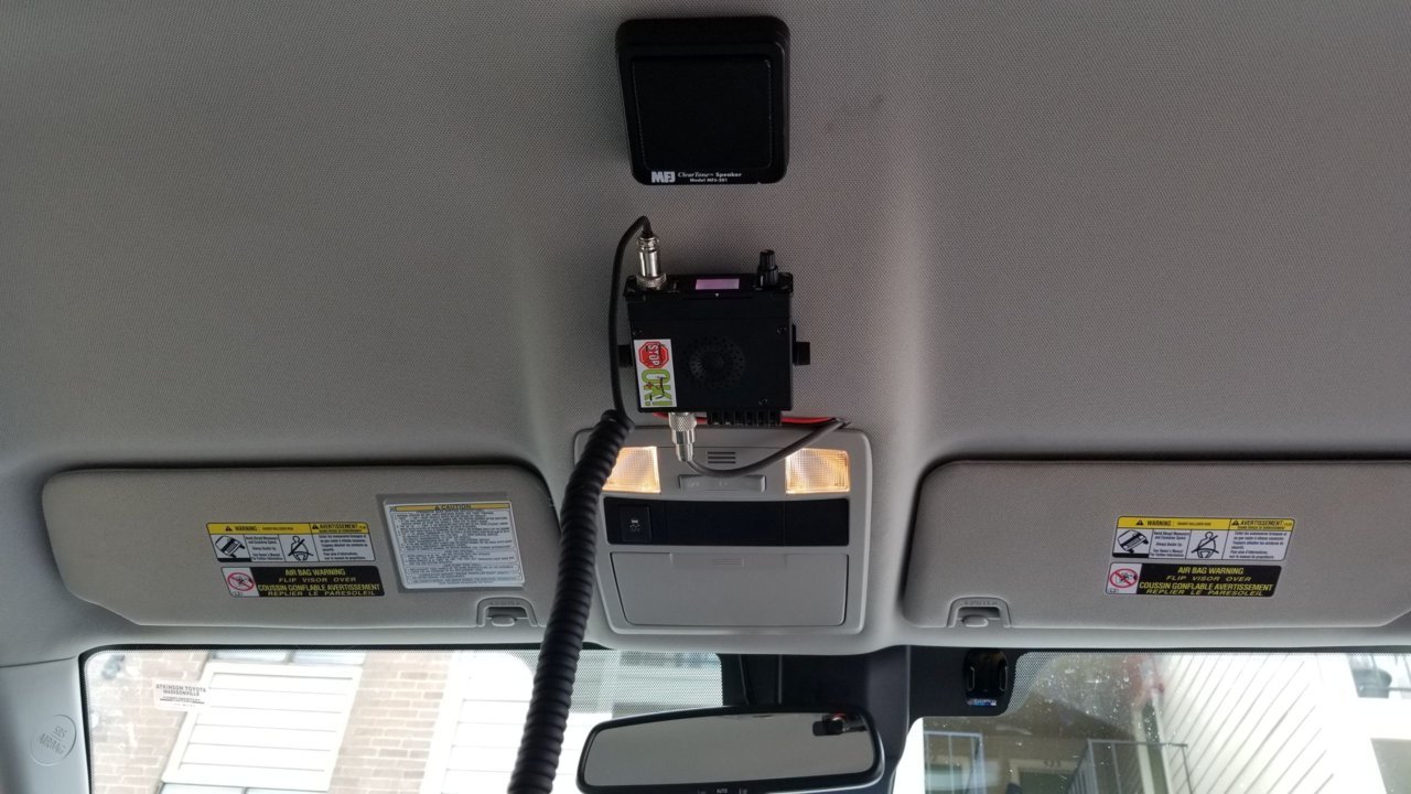

    I'v had the Kenwood TM-D710G in the Taco for a little while now, but wanted to add a speaker. Radio is under the passenger seat with wires through the console to the head unit mounted on a Lido mount. Another Lido mount holds my Android tablet that runs APRSDroid buletoothed to a Mobilinkd TNC connected to the radio.

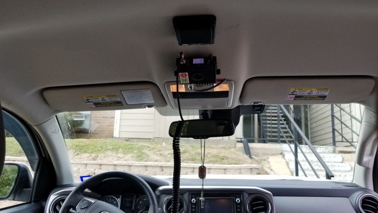

    While adding a speaker to the headliner I also added a very small CB. I had a monster CB in my old truck, but have no space for it in the Taco. I use it for Bear and traffic reports while making frequent trips to Dallas to visit family, and some groups wheeling aren't HAMs, so they use CB. Yeah, I'm a HAM, but still have use for the good ol' CB.
    I took the front of the MFJ speaker, soldered a longer speaker wire to it, and used washers to make the original screw heads larger to hold on the top side of the headliner. Cut a small hole for the magnet to fit through.

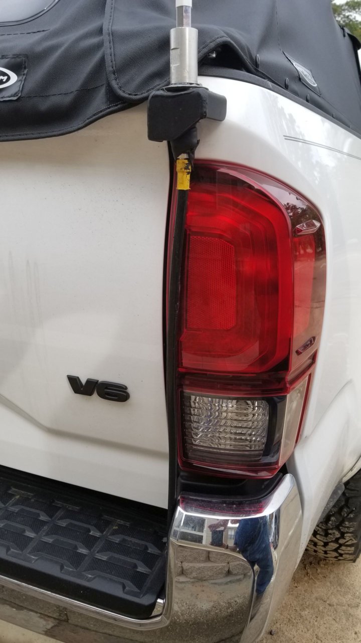

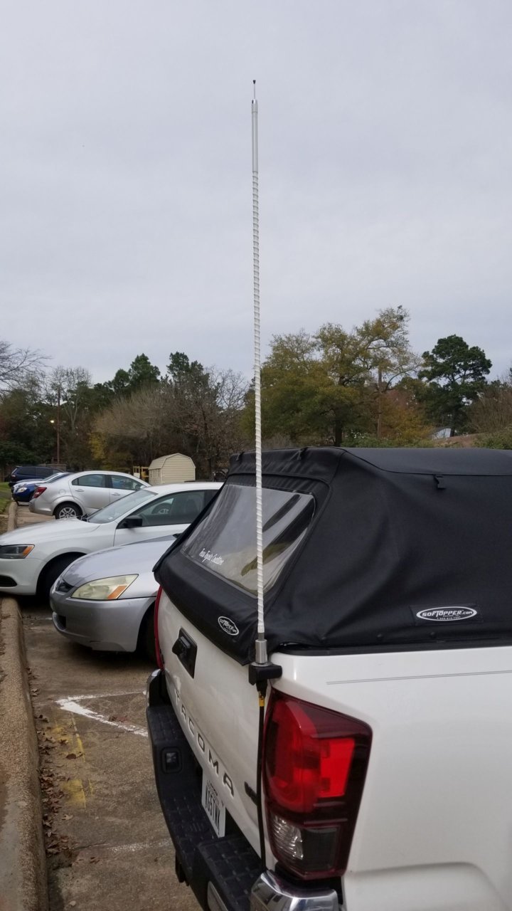

    Used a bed accessory mount from Caliraised for the Everhardt antenna.
    I had some LMR 400 from my previous truck. It runs along the frame, through the floor under the passenger seat, and up to the top of the B column. A short RG8 from there to the radio. SWR is 1.5:1 on 1, 1.1:1 on 20 and 1.5:1 on 40. using a RigExpert to tune.
    Some finished views with the APRS setup running.
    Have a GearKeeper holding the mic up. Attached to the edge of the dome light housing.
    I used an 18 gauge shielded power wire to help reduce RF interference, and added ferrite chokes on each end.
    I already have 1" braided straps bonding all body parts to the frame to alleviate RF interference, and improve the counterpoise/ground plane.
    Have the Kenwood running on the Larsen in the center of the roof. Yep! Drilled a hole in the roof of my brand new Taco! Oh, and I got my Radio Operator plates put on!
