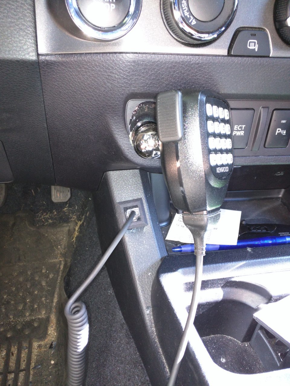

    I know I'm late to the part here. I'm using an external speaker that I hid inside the headliner near the overhead console. It's the smallest speaker that match the v71a's speaker impedance. I only use one speaker. You can use either spk1 or spk2, it doesn't matter, just shove it into one of them. Then set it up so that both VFO's come out of the speaker, you can change this in the menus. Mic cable was long enough for me, then I made an extension to make it look pretty. As @m603holden said, one of our local guys made his own cable and there is a lot of interference, it comes and goes, some days it keeps him off the radio, other days you can barely hear it.
    Mic cable looking fancy

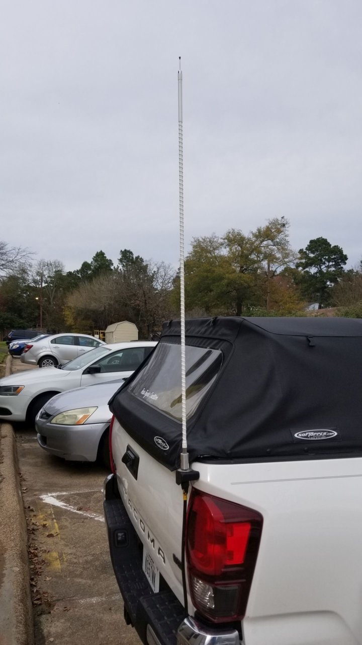

    Before I drilled a hole for the current NMO mount my choices were limited with a Softtopper on.
    I mounted a Diamond SG7900A above the right rear taillight with a RCI Bed Accessory Mount. Worked GREAT!
    It's a tall antenna, but in that location I could still do drive-thrus and such.
    Have a 4ft Everhardt there now. The Diamond is 1 foot taller than it.

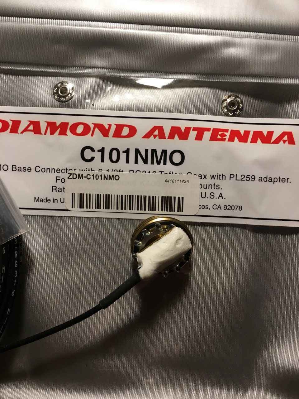

    Stopped by gigaparts and told them I was going to be mounting to an exterior bracket. This is the nmo mount they gave me. Will this be ok to be exposed? Looking at some of the Larson mounts they are covered in plastic.

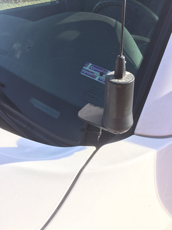

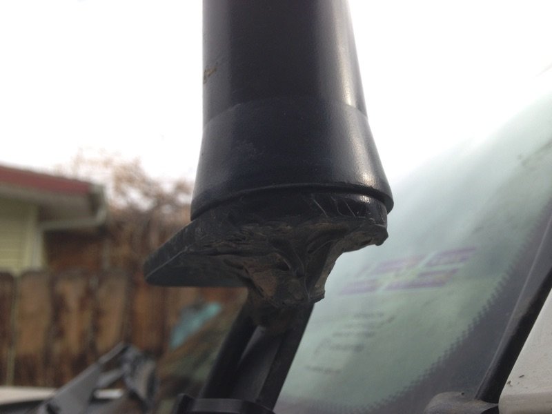

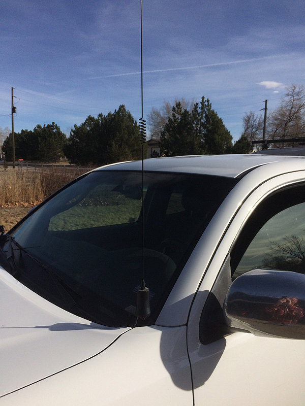

    I run my antennas on ditch brackets at the moment until I can get time to drop the head liner and drill NMOs in the roof. They actually work well enough and they are out of the way, so I don't mind them too bad.
    But to answer @Leman's question about the under side of exposed NMO. Yes you should seal it from the weather, RTV, silicone, Liquid Tape. Anything will work but you'll get corrosion and risk shorting the antenna when it gets wet otherwise. That Comet might be OK, it looks like they may have done it already, but more couldn't hurt.

    Looks pretty good. I like the high frequency NMO mounts for external mounts.
