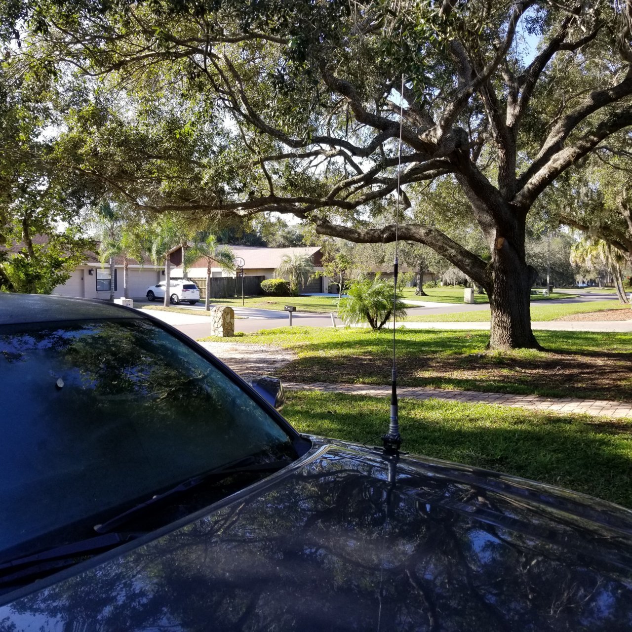

    Too much handwringing over "grounding". A C-loaded antenna (i.e Diamong SG7900) doesn't need a groundplane/radials so it doesn't need to be grounded at the mounting location. I've mounted them on plastic motorcycle luggage before.
    I use a trunk lip bracket for my tacoma.

    Is that a half wave antenna? How was tuning and do you have any issues getting out? I was thinking about putting a 1/4 wave antenna in the same place or maybe even further down the hood to distance myself as much as possible from taking a dose of rad's to the noggin as much as possible. I haven't bit the bullet yet with all the debate on radiation straight to the face seems like a not good idea.

    SG7900 is a 7/8wave on 144 and 5/8 (3 element ) on 440. C loaded.
    It doesn't requirerequiere tuning,
    there is no way to tune it. i rarely transmit on VHF or UHF so i don't care about exposure
    from those bands.

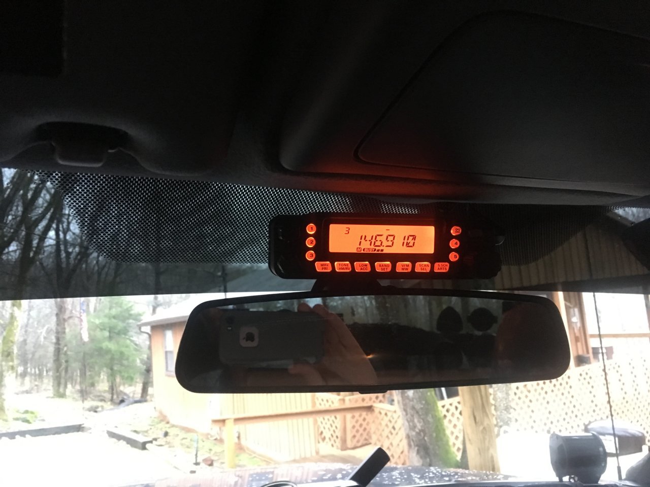

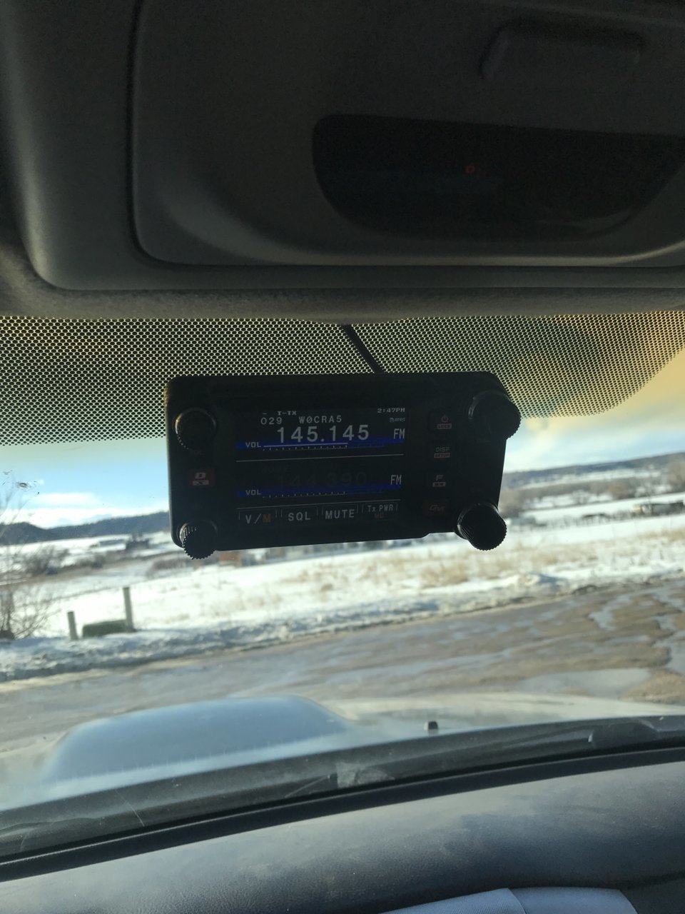

    Moved my yaesu 7800 over my rear view mirror today. I used a dash cam kit and 6 pin wire extension both from Amazon. It was in the cubby in front of my manual shift but I decided to move it for easier control plus I relocated my brake controller in its place.

    Do you have any pics of the radio face mounted in the cubby? Maybe I've already seen them. How did you mount it? I'm working on the same plan, just waiting for my NMO mount to arrive.
