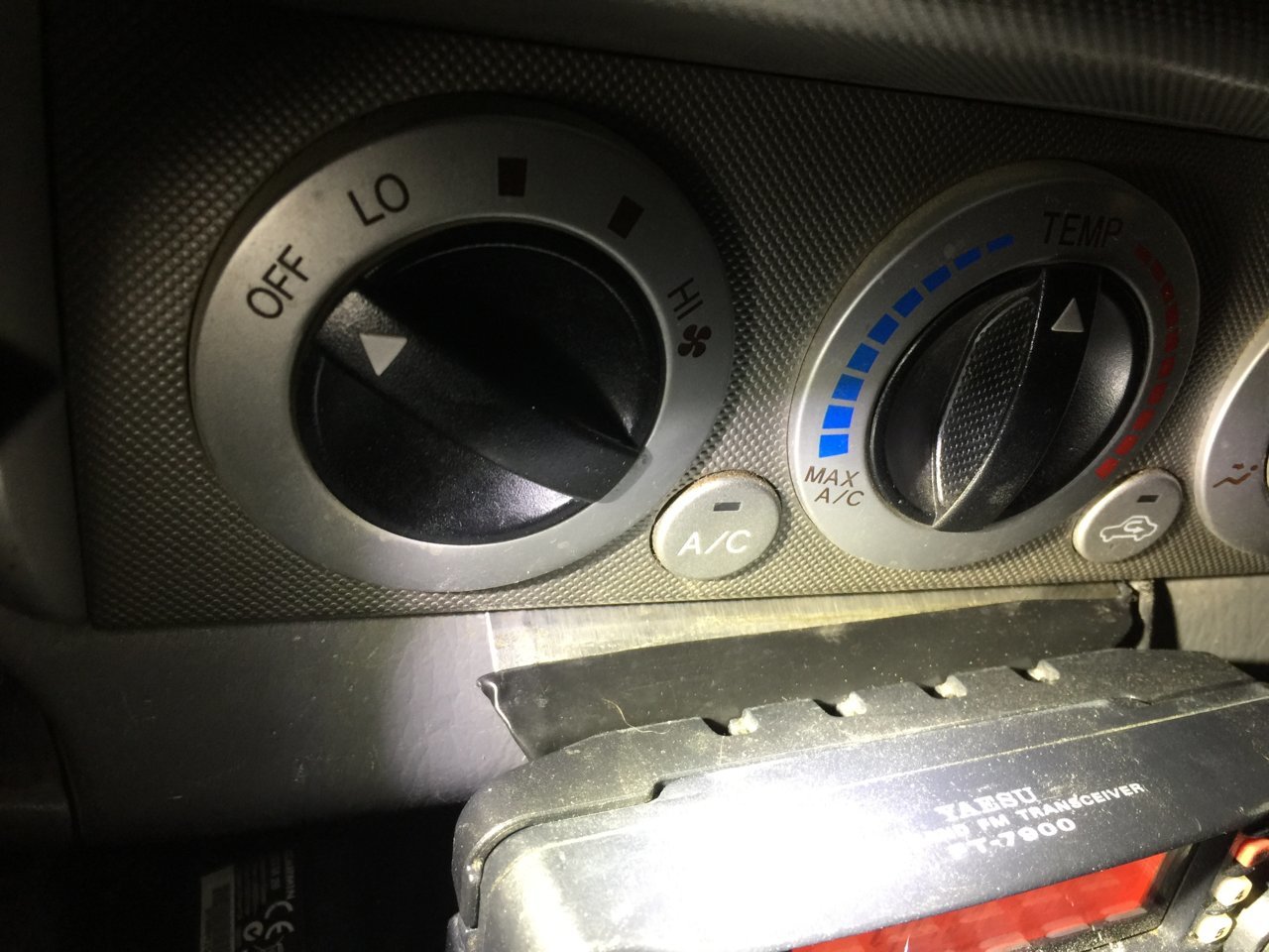

    I had mine there for a little while until I got tired of looking up. Now I have it mounted to a small piece of stainless that slips under the heater controls panel.

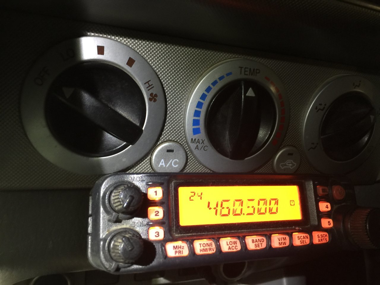

    As used:
    The Magic Mount:

    I just pop riveted the bracket to the stainless (which was originally a switch plate before I cut it up).

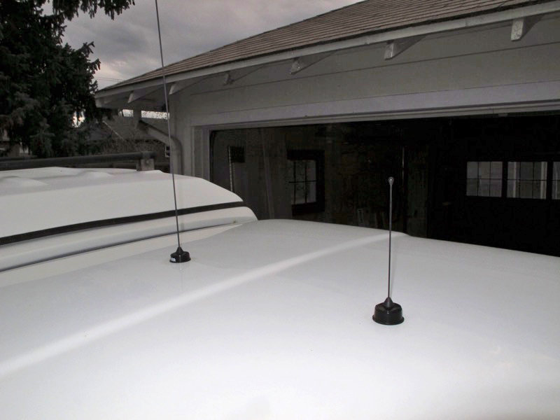

    There is some chance of that with very tall and rigid antennas. Those are usually the Comet and Diamond ones, which weren't really designed to mount on a sheet metal NMO. Using an NMO in your roof and commercial antennas from Larsen and Laird don't pose any real risk of that. Otherwise you'd see fire department, ranger, municipal vehicles tearing them out and that doesn't happen. There's nothing we're going to do to our trucks that's 1/10th as tough as what a cop car is going see.

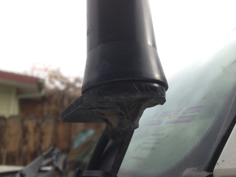

    I use plain old Larsen NMO-K mounts. If you're mounting it in sheet metal it will seal fine, that's what they are designed for. I ran these two antennas for 11 years in the old truck with zero issues. They are still going now 4 years on, I sold the truck to a friend who uses it for landscape work.
    If you're mounting them on a bracket exposed just silicone the under side after you mount it. No reason to overthink it. Eventually I'll drop the headliner in the Tacoma and mount antennas in the roof. It's just more of a PITA than it was in my '91 and I haven't had time.
