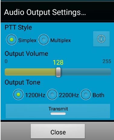

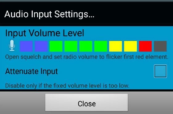

    Here's my settings on the TNC app. Leaving the Attenuate Input unchecked.
    With the radio set to B band for data and Packet12, I simply hook up the 2 cables, set the TNC like above, Set APRSDroid to KISS, and it works perfectly. Haven't seen any issues to indicate packet loss. Send and receive messages to/from my Kenwood D74 and Icom ID51(with another TNC)
