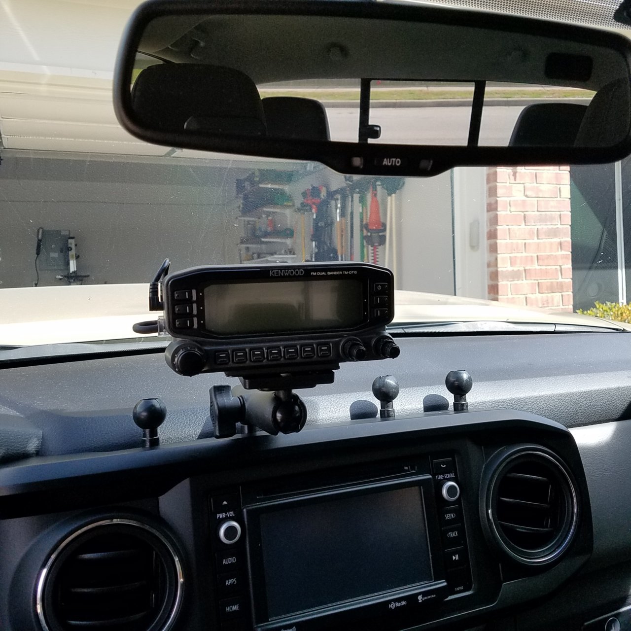

    Installed a DMM ball mount and connected the the control head bracket that came with the D710 this weekend. Now the control head sits so high it blocks some of the windshield. So far I have a single short arm connection. Has someone else crossed this bridge and have a solution?

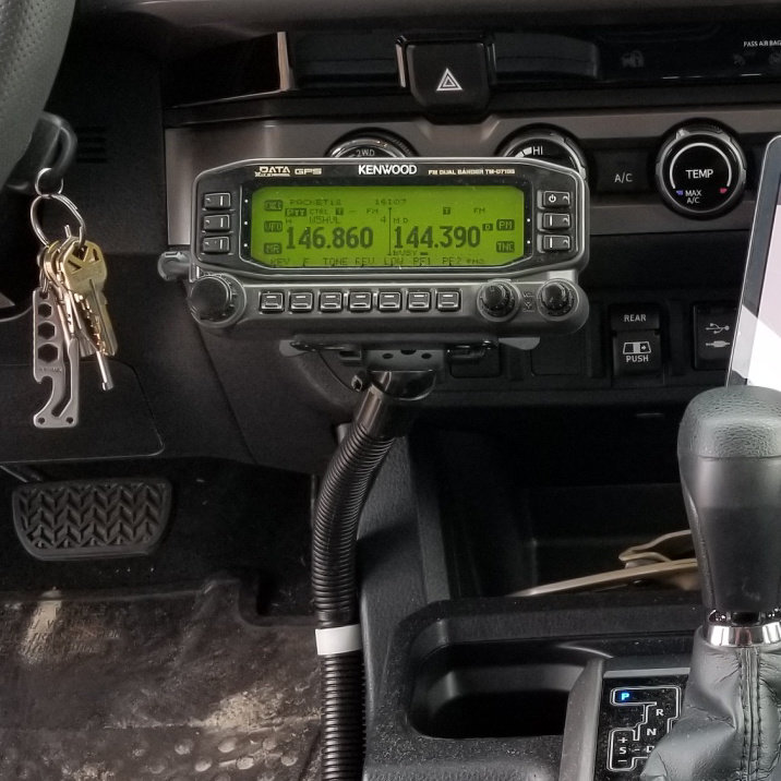

    I thought about the DMM but wanted something lower. I'm using a Lido Seat mount. You loosen a seat bolt, put it under, and tighten it. It has a poseable shaft...the white strip is a 3/4 inch strap holding it to the center console. Could have ordered black, but these were in stock...impatient...it wiggles a little bit, but all in all, a great position for my D710. IMG_20190217_214227.jpg
    Yeah, it covers some dials/buttons, but a simple tilt and done when you need them.

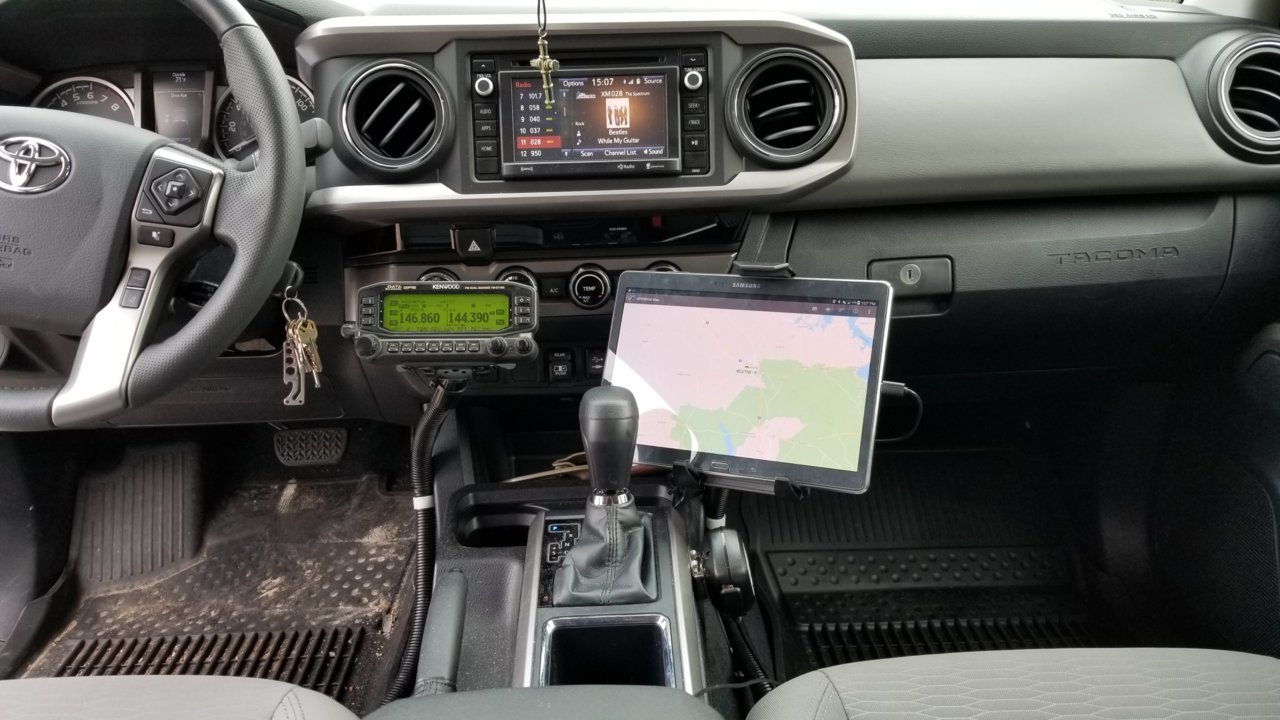

    As far as I have seen from the D710 maybe a minute! I use it for APRS. with a tablet running APRSDroid, and it works perfectly. Here's the entire pic. With the tablet on another Lido Mount.
