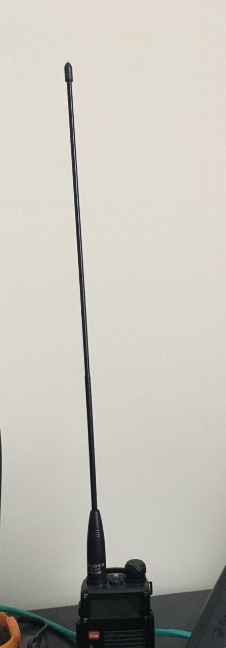

    I have the same one for my baofeng HT I didn't notice any issues until I bent it to a 45 deg angle.
    I have mine mounted on the a pillar and the windshield bends it pretty good. Had to take it down until I can get an external antenna. The bend killed reception!
    I marked the bend of the antenna with a red line, not sure how viable it will all be.

    You will not be able to get out or receive much like that.
    You might want to consider an external mag mount. Stick it on the roof and hook it up to your radio and you will be good to go. I also added an external mic/speaker. Makes it easier to use while you are driving.
    I keep the antenna in the truck and if I get out, put that one on.

    Yep, I quickly figured that out. That's why I spoke up about the "bending of the antenna" in the original question. I also found that the windows/body kill reception both in and out. Currently saving up for a nice lip mount to put on my hood and a couple external antennas. I plan to keep the HT antenna in my under seat storage for when I have the radio but get out of the truck. Now that I have an antenna mounted at my house I barely use the HT antenna now.

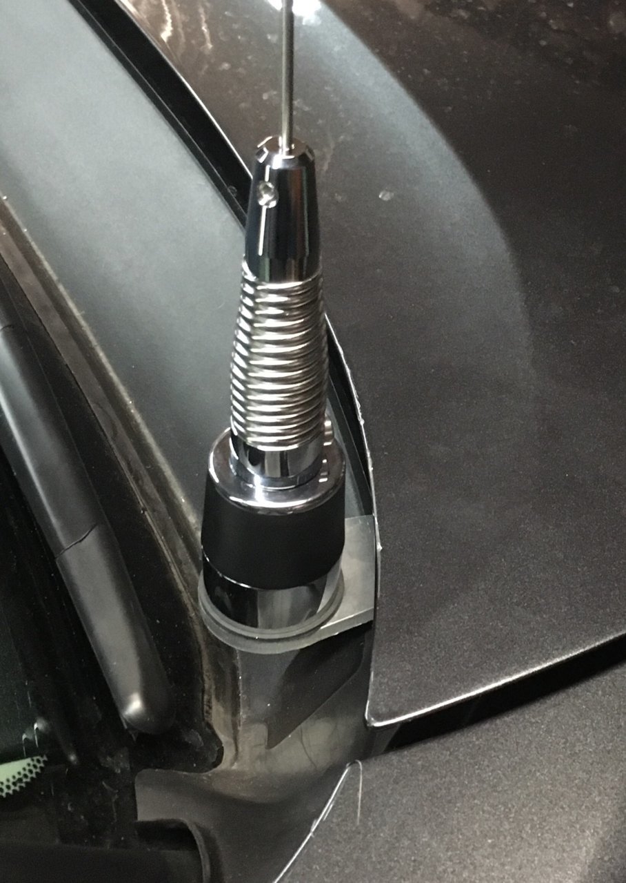

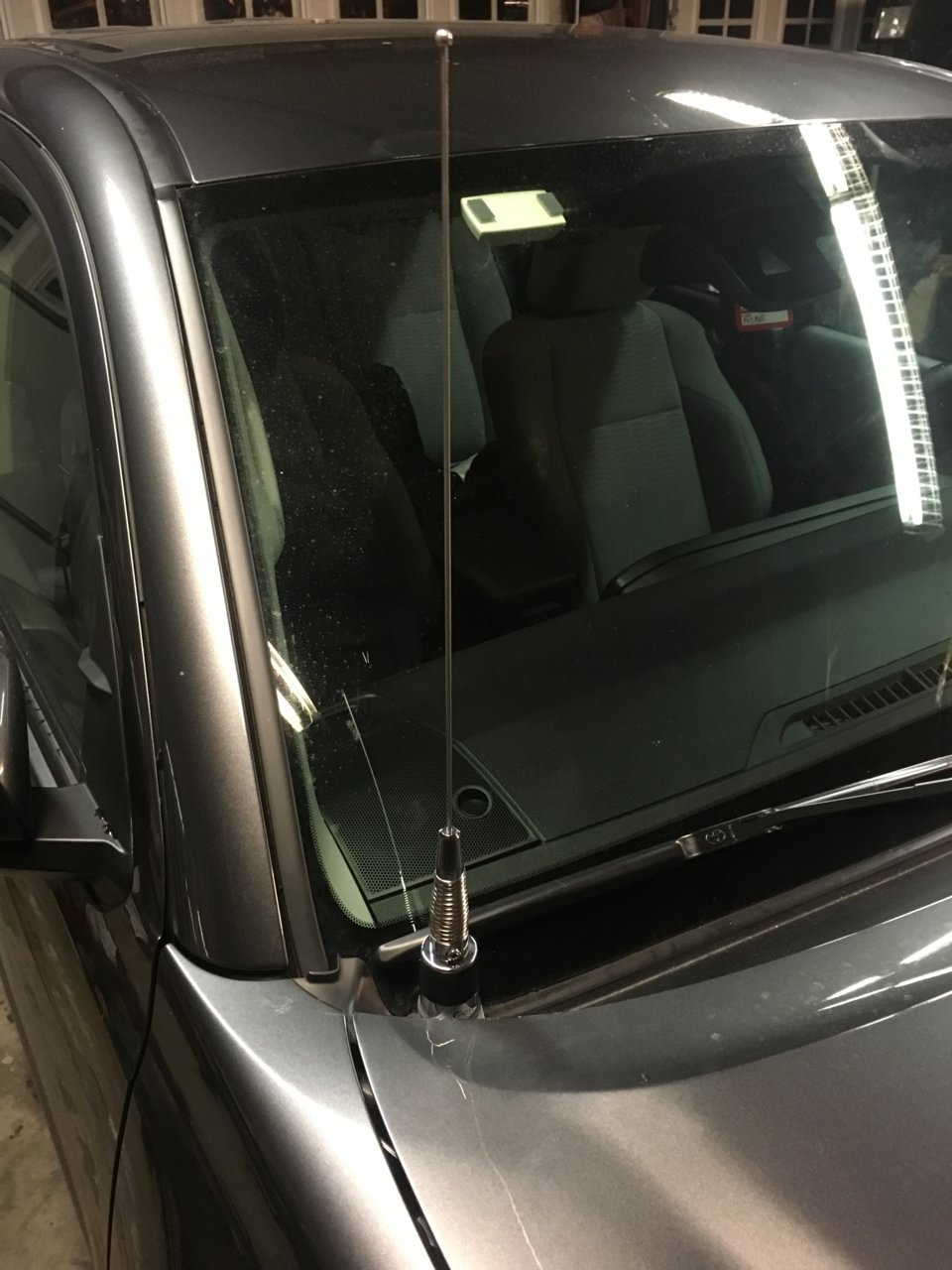

    If you are interested in getting a better signal you may want to use an outside antenna. I just finished installing my 2-way radio antenna. I used Victory 4x4 (JC Off-road) 3rd gen. Tacoma mount.
    I like the look because the truck did not come with a regular AM/FM radio antenna so it almost looks stock. Well, not quite stock but it doesn’t stand out too much. I also like not having to drill holes in my truck. My only comment is that I neeed to put a small bend in it (otherwise, the whip would have been on a steep angle). On their website it almost looks like it comes pre-formed with this bend but it is not. It is merely a flat piece of aluminum with three pre-drilled holes (one for the NMO and two for the hood bolts). Not a big deal. The whole thing took me only a few minutes. They have a install vid on YouTube.

    Looks like a nice mount. I have a ditch light mount on mine -- I wonder what the clearance is with that mount. It looks nice and tight.

    It fits perfectly. Does not rub; plenty of room. Also, the antenna does not hit against the windshield when the hood is open. I think it is made out of 1/4” thick aluminum plate.
