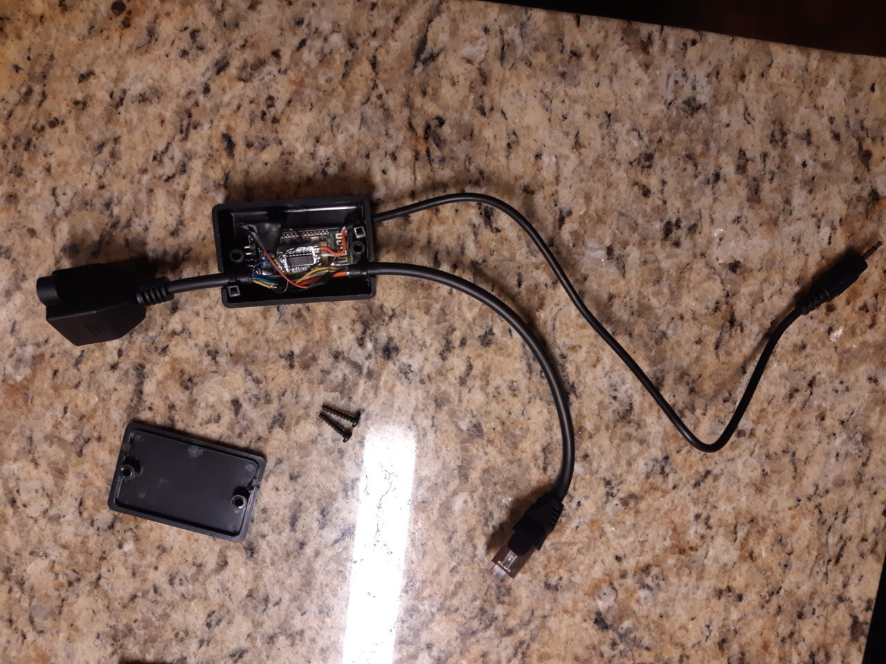

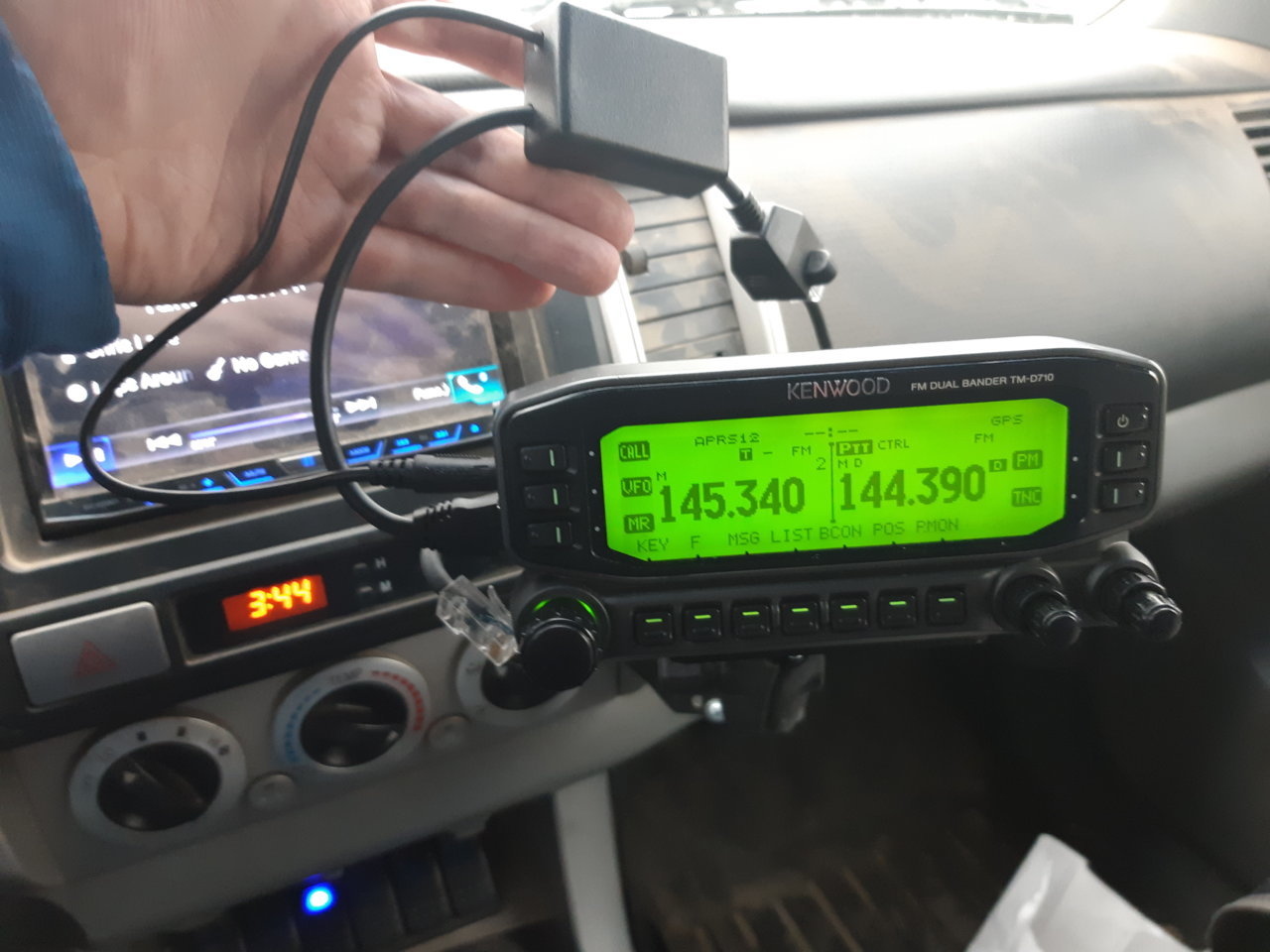

  15. Feb 22, 2019 at 3:42 PM
    #4695
    Littles
    Littles Stupid is as stupid does.
    May 14, 2014
    #129837
    3,434
    Bryan
    Elizabeth, CO
    3 tons of fun
    If you havent seen this yet, it's a must read for the d710 with aprsdroid and gives you some options.
    https://github.com/ge0rg/aprsdroid/wiki/Kenwood-D7x0
    You should also look at this from aprsdroid.org, except the second screenshot of the radio display shows GPS input as off, and it should be on per the github instructions above.
    http://aprsdroid.org/kenwood/
    I didnt feel like building cables, so I found a slightly different option that doesnt use the data port on the back of the remote head and purchased a home-brew bluetooth module off Ebay built for the d710 that instaed uses the rj45 remote head cable for power to the bluetooth (and I assume APRS data). According to the sellers description, it is based off an hc-06 aurduino module. It was expensive at almost $100...but i didnt have to figure it out and it was basically plug and play. I imagine you could build one for under $50.
    In my application I am bypassing the add-on GPS module and using aprsdroid to send GPS over bluetooth to the radio for beaconing.
