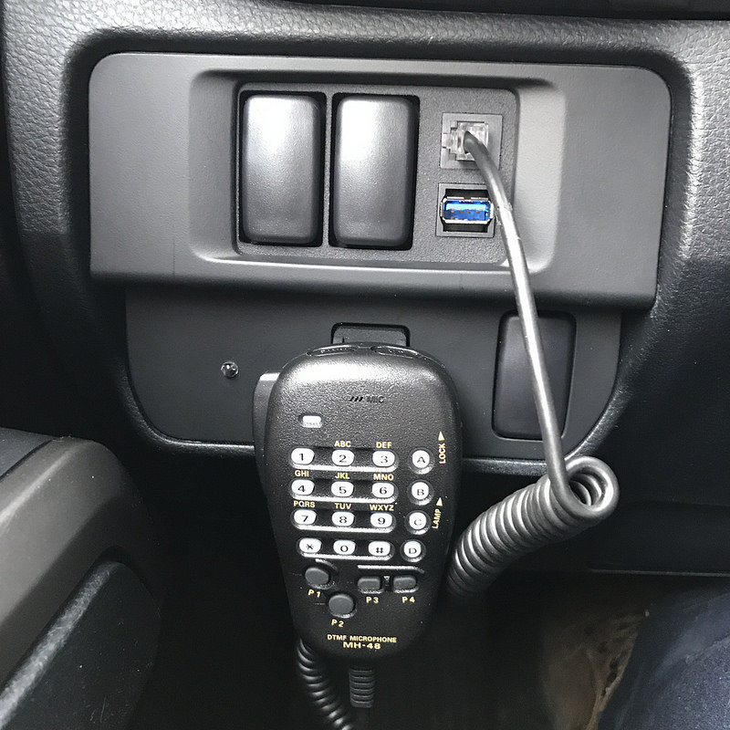

    I've got that with my KCs
    Btw TM-V71A just plug and play with the Mobilelinkd :anonymous:

    I love that spot. It’s getting full as I have one more switch going in there too. Thanks for the quick reply.

    I prefer mine on the right anyways

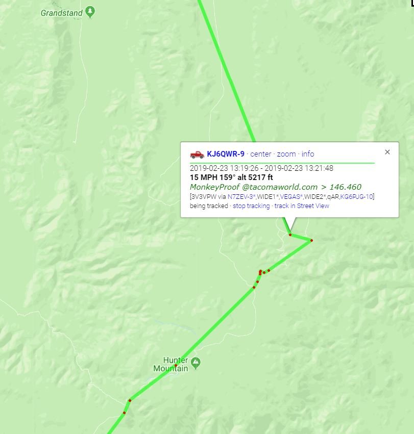

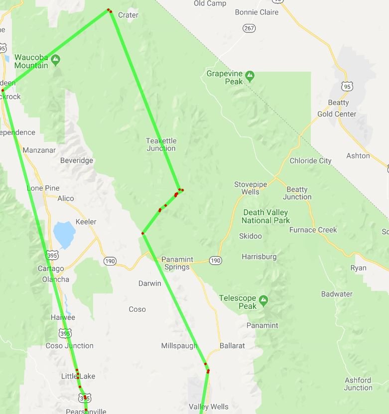

    I was able to send some packets while in the middle of Death Valley yesterday..

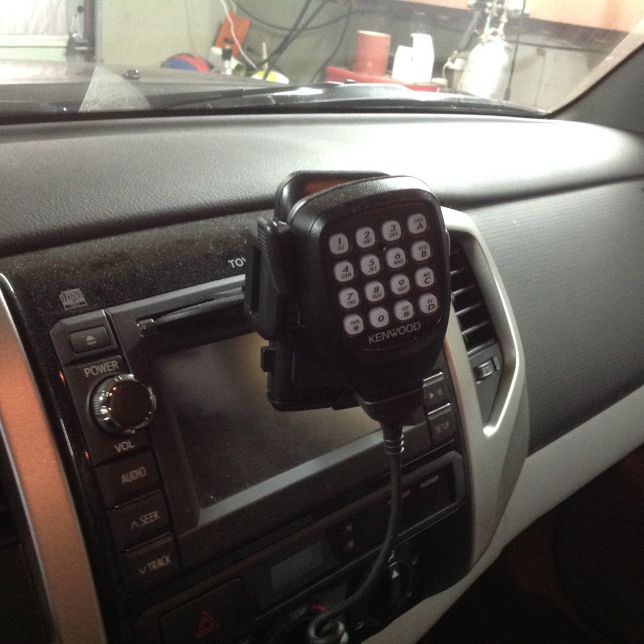

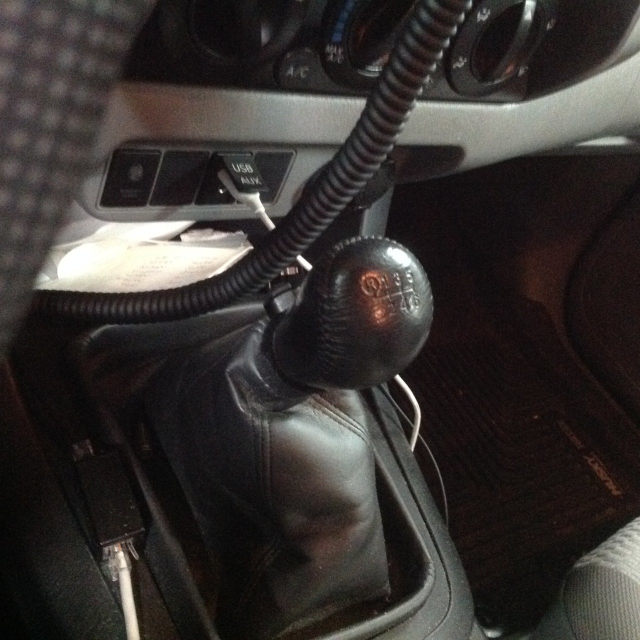

    What I did for the mic in my truck was to wire in a remote PTT switch in a CAT 5 extension cable between the radio and mic. I have the mic attached to a phone mount that clips in the CD slot on the radio. With the mic gain on hi, I never pick up the mic on my V71A. The remote PTT switch is wrapped attached to Velcro that wraps around the 6sp shifter.

    Here's a few. The PTT button is on the front of the shifter. The mic is clipped to the phone mount via the mic hanger being black zip tied to the mount. For a cleaner install, the mic could be routed to the ceiling mounted on one of the sunglass holders. The faceplate is above the rear view mirror.
