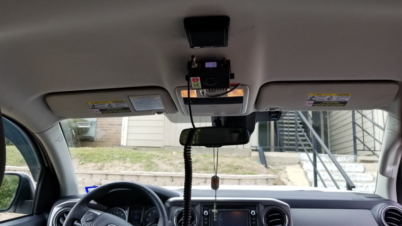

    I might need a suggestion for an external speaker. Right now I'm using a Midland 4ohm speaker Midland 21-406 Deluxe CB / Amateur / Marine Extension Speaker https://www.amazon.com/dp/B000246VPM/ref=cm_sw_r_cp_apa_i_.QwKCbFWDH0WS mounted in driver's footwell. Works well while stopped or in traffic, but turned out pretty useless while driving at high speeds. Might need amplified speaker.
    I have Yaesu ftm-400 which calls for 4ohm speaker. Now, I've seen some amplified speakers, but they had 8 ohm impendence. So. Should I worry about it since they're amplified?

    3" OME lift with SPC UCA's HD Dakars Shrockworks Sliders KO2's 165/75/16 Decked bed system CaliRaisedLED mount for Everhardt CB Antenna President Bill FCC CB Yaesu FTM-400 HAM radio and Larsen antenna through roof. TVD Vinyl Decals for the tailgate (Black Reflective) and U.S. Flag decals SofTopper (Black) Empyre Offroad Grill Blacked out badges (PlastiDip)
    I took the face off of this MFJ speaker and mounted it to the headliner near the upper console. Right near my head, can hear it regardless of wind and road noise.

    I did the same but I kludged it together with a speaker I found on digikey. No issues at all.
    Bastek likes this.

    The FTM-400s (both the early one and the XDR) do behave much better with 4-ohm speakers but will drive an efficient 8-ohm speaker tolerably well -- Remember though, the 400's, like the 100's, use a ground-isolated stereo output, which is why Yaesu includes a ground isolated stereo to mono adapter with the radio. So, whatever speaker you choose, do use the provided adapter, or address both the plug in the radio and the stereo to mono conversion so that you'll get best possible power to the speaker and not damage the 400 with a mono plug.
    Bastek[QUOTED] likes this.
    Head unit on a Lido mount. Radio under passenger seat makes it easy to run a wire up the column. Simple took the front half of the speaker, cut a small hole for the magnet to fit through the headliner, and poke the screws through from the top.

    Thanks bud. Come to think of it, I might have seen your setup before ;).
    I will have to think of some alternate way, I don't have a all that real estate up top to even attempt cutting speaker holes in headliner :eek:.... Sunroof issues, lol.
