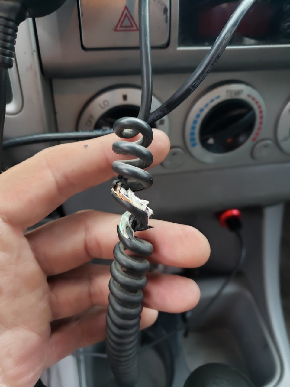

    Any suggestions on how to fix this?

    The connector is an RJ-12 and not difficult to source. it's the same connector that was used for years on corded telephones (between phone and handset). You can still find coiled cords with all 6-conductors present and simply rewire into the Mic...
    Alternately, you could use the opportunity to add an extension in there, and maybe get a little less wear, or something that you wouldn't chew on so much.

    Not sure what is that for, but there is an 8 conductor replacement cable for Kenwood radios that you can buy on Amazon

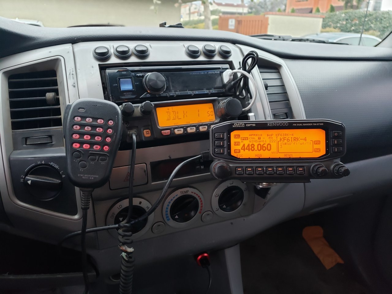

    Thanks. Although I was looking for external speaker in headliner pics :oops:
    OK, so that's a Yaesu right? Not sure how much original replacement microphone costs, but here is a cheap replacement abcGoodefg MH-48A6J 6 Pin 22" Coil Cord DTMF Speaker Microphone with Button for Yaesu MH-48A6J FT-7800R FT-8800R FT-8900R FT-7900R FT-7100M1 https://www.amazon.com/dp/B00YBTM5A4/ref=cm_sw_r_cp_apa_i_0LAKCb11165G8 if it isn't good at all, you could use it for a donor cable Here is a cheap replacement microphone cable
    Pasow Replacement Microphones Mic Cable Cord Wire for Yaesu MH-36 MH-36A6J MH-36B6JS MH42 MH-42B6J MH-42C6J MH-48 MH-48A6JA MH-48A6J FT-1500M FT-2800M FT-7100M FT-7800 FT-8800 FT-8900 FT-8900R https://www.amazon.com/dp/B018FNQ58E/ref=cm_sw_r_cp_apa_i_CRAKCb1FZFK5F
    Or, part-out sounds reasonable!

    That's amazing! you rock :headbang: https://www.amazon.com/dp/B018FNQ58E
    I had to replace a missing MIC for my other FT-2800M radio, and that costed 75 bucks.
